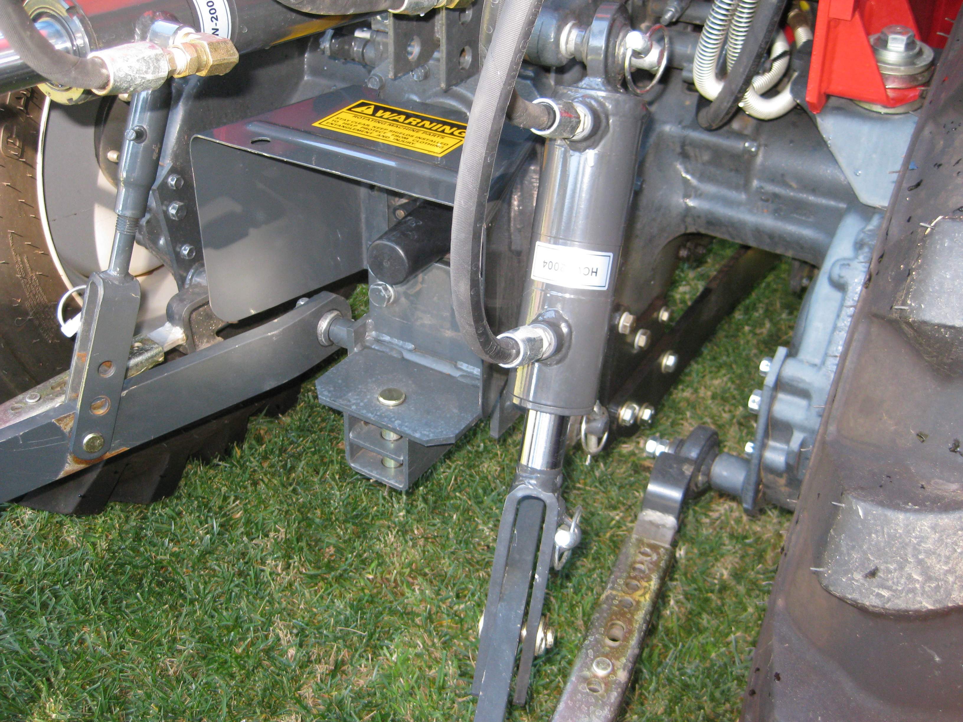

I'm very new to the tractor world. I'm not familiar with what a side link is
Top & tilt cylinders. Top link, side link, makes grading soooooooooooo much nicer. ;)

I only have 1 rear remote. Seems like you would have to have several more remotes to run all that stuff. Where do you put all the additional controls for all the rear remotes.
   / Gannon Box Blade with hydraulic rippers #25
Your tractor can have 2 OEM remotes, but that is often not enough. Just for a Gannon with hydraulic actuated rippers and "T&T" you need 3. And often even more. Then you can do something like what I did on the back of my Mahindra 3215. I now have 4 sets.
