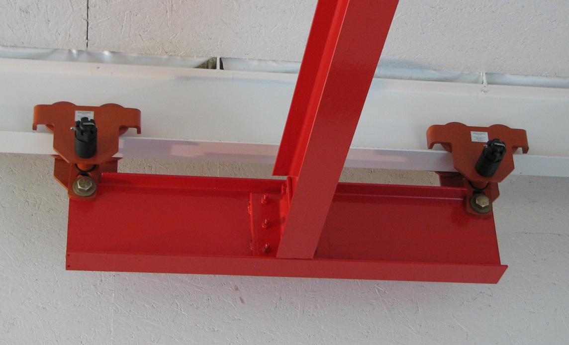

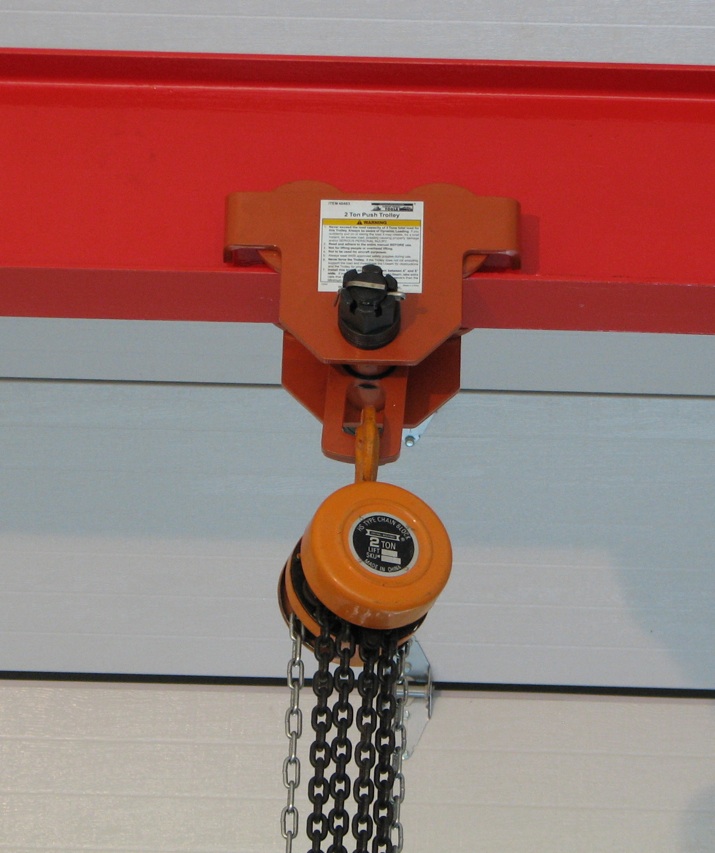

Well, i finally got a chance to build my gantry for the barn's shop. Took 2 days for a friend and I to build it plus painting time. I had bought some used 20' i-beams a few years ago and welded them up to make ~ 32' long side rails. Every 16", i welded on 3/16" or 1/4" thick (can't remember which) 2" wide flat stock onto the top of the I-beam as hanging tabs. These tabs were bolted through the sides of each truss. The trusses were designed with extra strength to support the gantry load at these locations. Two tabs (one welded about 20% of the way in from each end) were welded centered on the I-beam flange. These were bolted to the trusses first allowing the beam to hang vertically. The other flanges were staggered next to each edge of the beam so that when they were bolted, the beam could not rock side to side. This amount of support was overkill but better to over build, especially for something supporting things above you.
I used the cutoffs from making the 32' beams to make the trolley ends of the gantry. This was bolted with grade 8 bolts to 1/2" x 4" angle iron brackets and attached to the I-beam. Each trolley end was suspended from 2 Harbor Freight 2 ton trolleys with 1" grade 8 bolts. The chain fall trolley is also HF 2 ton trolley that runs on a 22 I-Beam.
Finished it today and works unbelievably nice. Moved 6 loads varying from 600 - 1100 pounds from one corner of the barn to the opposite corner and it rolled effortlessly. I really am quite pleased with how well it is working.
Ken

Do I understand correctly; you have a cross-wise I-beam that rides on the two linear I-beams, and the chain hoists ride on the cross-wise I-beam, right ??
Or do you have more than one cross-wise ??
Thanks.:)
Yes, that is correct. I should have taken a picture of the whole thing.
At each end of the crosswise I-beam, the short section of beam that has the two side trolleys on it is just under 4' which means i can get to within about 2' of my garage doors at each end of the building. i can get with in about 18" of the side walls with the chain fall as well.
The load span is about 21' and, if i calculated it correctly, the beam will deflect about 0.4" for 2500 lbs, 0.6" for 3000 lbs, and 3/4" for 4000 lbs if the load is in the center of the span. The heaviest load that i plan on lifting and not at center span is 2500 lbs. If I were buying beams for the cross beam, i likely would have gone with W14x22 which would only result in a deflection of a 1/4" for 4000 lbs. (again, if i am calculating correctly).

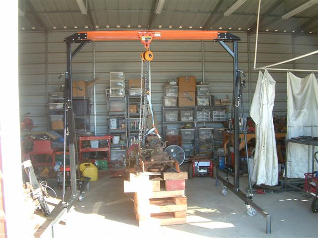

Nice job.
Technically speaking, I think what you built is a bridge crane if I interpret your photos correctly.
A gantry crane is similar, but is supported from the floor on casters. Here's mine
It's a 1-ton model from Harbor Freight. It's OK, but I'd rather have your setup.

On your HF gantry, did you add those base extenders or did they come with the kit ??
Also, if you were to hang a 6BT Cummins on it, can you then roll the whole outfit forward or back, like one would need do when swapping an engine ??

I added those extenders myself so I could move the gantry around with a load on the chain hoist. So, yes, I can move the gantry back and forth with an engine hanging on the hoist without worrying about the thing tipping over.
That HF gantry comes with cheesy 5" dia plastic wheel casters. I replaced these with 5" cast iron wheel casters from McMaster Carr ($25 ea). The hole pattern on the replacement casters fortunately matches the pattern on the plastic casters perfectly.
