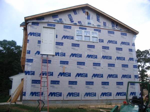

Side

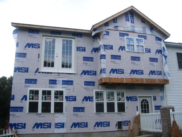

Rear. Siding should start Monday, if I can get the inspector onsite before then. We have to do "load pathing" now. The structure has to be strapped to the foundation, across the floor joists and to the roof trusses. This requires a separate inspection and needs to be done before the siding is installed, otherwise they'll make you take the siding off.

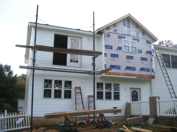

Siding came in and has begun. Front

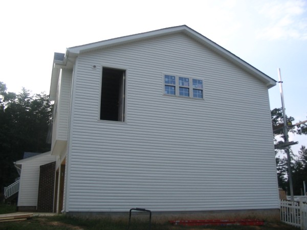

Side view

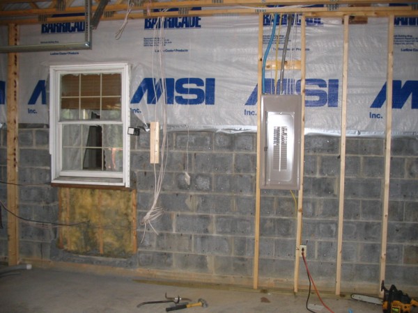

Electric subapnel and most of the wiring is also done. I could only add a 125 amp 42 space panel without going to a separate meter base. The window and block will soon be replaced with a door.
