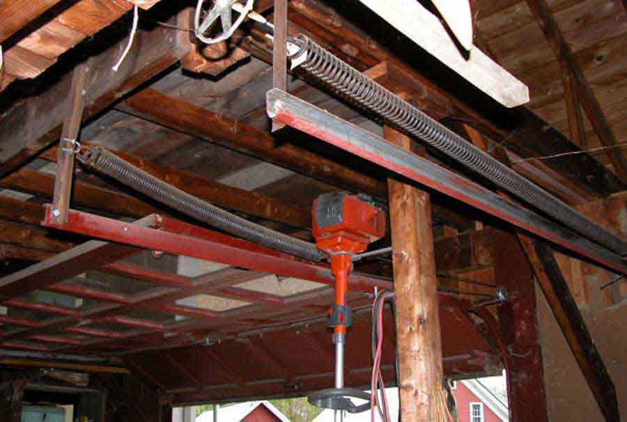

</font><font color="blue" class="small">( </font><font color="blueclass=small">( When the door is closed, the springs are free of tension. When the door is open, the springs are stretched out. )</font>
/forums/images/graemlins/confused.gifPete, can you post a picture of that? That's just the opposite of what my garage doors had. The springs were stretched out when the door was closed, so the springs helped to lift the door when you started to open it, and when it was opened all the way, no tension on the springs. So I can't quite picture how yours works. /forums/images/graemlins/confused.gif )</font>
Yup Bird, you were absolutely correct. Here's a shot. The left hand spring goes to the open door; the right hand spring goes to the closed door out of the photo to the right.

OK, Pete, you might be able to adjust the cables, like GaryM described, or you might simply need new springs. Those appear to me to be installed correctly, but the one on the open door appears to be a little too slack. Of course you also want to be sure you adjust the tension to be the same on both sides of the door. I'm wondering if it's possible that your current problem could be related to having different tension on opposite sides of the door now.

Good point, and with springs that old I still think replacing them is a safer option. I'll be sure to tension them evenly. Thanks all! pb

rOGuE -- Well, the springs were 40 years old and needed replacing, and while that made the door considerably easier to lift manually, it didn't solve the opener problem. So with my wife pressing the button I climbed up there for a closer look.
The tension on one side of the sprocket was way tighter than the other. I noticed the trolley was impacting the limit bolt, instead of stopping just short of it. So I detensioned everything, adjusted the limit settings, restored the proper tension and it now works like a charm!
Thanks for all the suggestions! Pete
