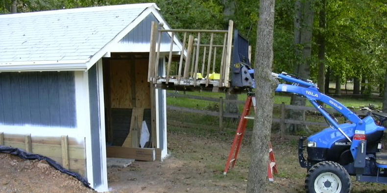

Amen to that! I have had my tractor just over a year and the ROPS has never been folded. I built a pole shed. It used to be a sawdust pit. I just framed, added a roof, and sided the new part. I purpose-built it so I could drive in without folding the ROPS. All the prebuilt units I looked at were about 2" too short.
Pic attached.
Mark
