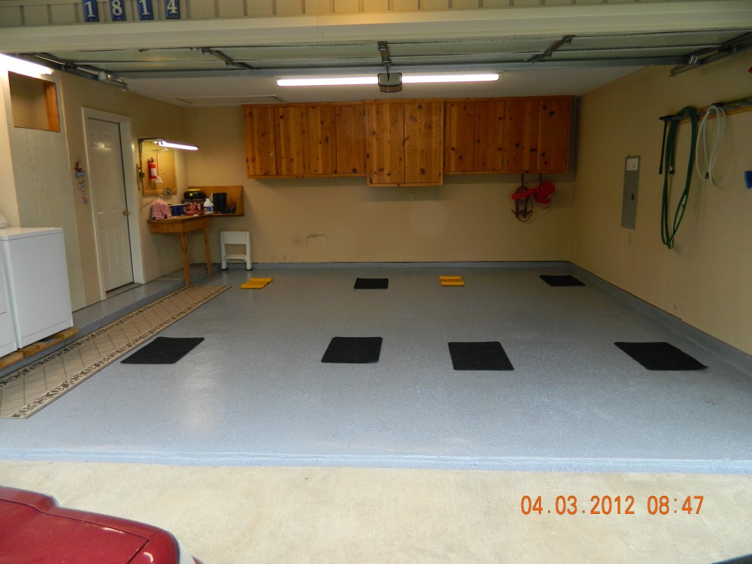

I had intended to wait at least one more day before putting the washer & dryer back in place, but with rain in the forecast, I might have gotten the tires muddy on the two wheeled dolly moving them if I'd waited. And I intended to wait a week to let the paint cure really well before putting the car and pickup back in the garage. But with a possibility of severe thunderstorms and hail, I got ready to just drive both vehicles straight forward into the garage on short notice.
So here's a picture of what I hope is a good solution to the problem some have had with hot tires lifting paint.
   / Garage Floor Coating #32
Son-in-law said after hot tires stuck to some of the paint, his mother found some rubber strips to put under the tires, but he wasn't sure exactly what, or where she got them. I intend to let mine cure for a week or so before putting the car and pickup back in the garage. However . . . I've had one of those Pro Park precision parking guides for the car for quite some time and today I bought another one from The Container Store for the pickup. Then at Home Depot I bought 6 TrafficMaster Walk Off Mats (18" x 27" short nap carpet with non-slip backing) to put one under each of the other tires; $2.97 each. And I bought a 25" wide carpet runner, 13.5' long that will be in front of the washer & dryer; $2.97 a linear foot.
