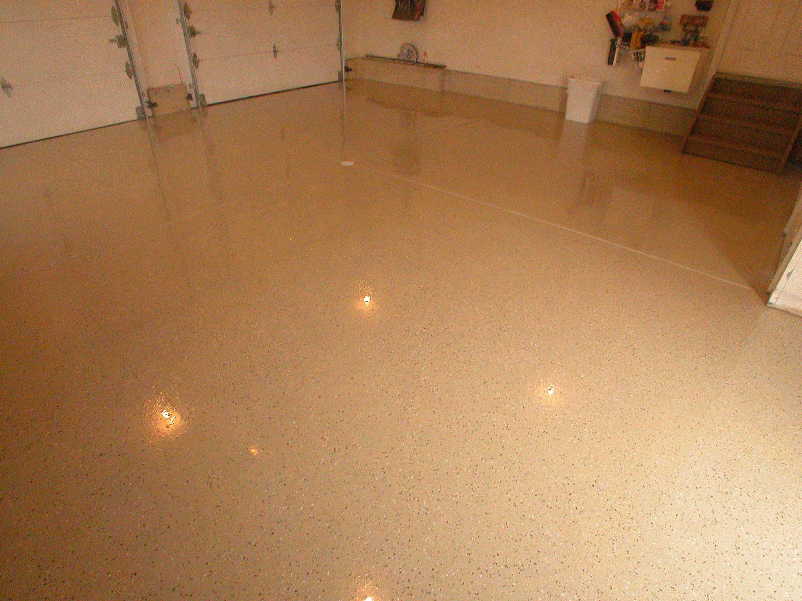

Can you eloborate on the hand grinder. Not really sure what you mean. Any chance you have a picture of what your floor looks like now? You know how the lady of the house can be, she just can't take my word for anything, she has to see it! Also, how long ago did you do it? Thanks for your reply.
   / Garage floor: Sealer or epoxy? #27
Here is a similar grinder:
7-in. Angle Grinder Surface Prep Kit from Metabo Corporation
If you have no experience with using this kind of equipment, you probably should not use your garage floor for practice.
There are bigger walk behind grinders, if you can find one to rent, it is more fool proof. Or, perhaps there is a contractor in your area, who will grind it for you. It is a hard days work, doing it on your knees with the hand grinder.
My floor is below. This is what this product looked like after it was dry. It looks exactly like the ones in the photo's on the Epoxy Coat web site.
It is now 5 years old. Except for some rust stains from the under carriage of our old vehicles dripping on the floor, (which are fairly easy to remove), and some slight dullness where the tires have worn the winter grit into it, it still looks beautiful. They say to expect a 20 year life span. If you live somewhere warm, that could be very easily possible. I suspect I will re-coat mine before then. Re-coating is very easy, you clean it, sand it, and your ready to go.
My floor had already started to pit before epoxied it. I know if I had not done this, the winter salt would have substantially damaged it by now.
I tried everything to save my last garage floor. I used every type of sealer, and it still deteriorated. When this floor started to pit, I spent good money for EUCO-GUARD 100 which is supposed to be a top notch sealer, when that did not stop it, I went with the epoxy. Problem solved.
One of my cars leaked brake fluid on this floor, for about a week, before I noticed it. It hardly effected it.
Other oils, fuel, hot tires, salt, heat from exhaust systems, and even using a floor jack on it, all have no effect.

That's a really nice looking floor Ray66.
I was contemplating doing something similar, but we have floor tiles at work something along those lines and if I drop something small I can never (well rarely) find it. So I went w the plain color.
Also the sand/grit, I thought about that too, but I didn't want to be crawling around or kneeling on sandpaper when I have to get under a vehicle. So I just walk slower and more carefully on rainy or snowy days.
So I ended up w boring plain shiny slippery gray! But it's much better than it was.

Thanks.
Next time consider that you can put chips of paint the same color in your floor, that will still greatly reduce slippage.
