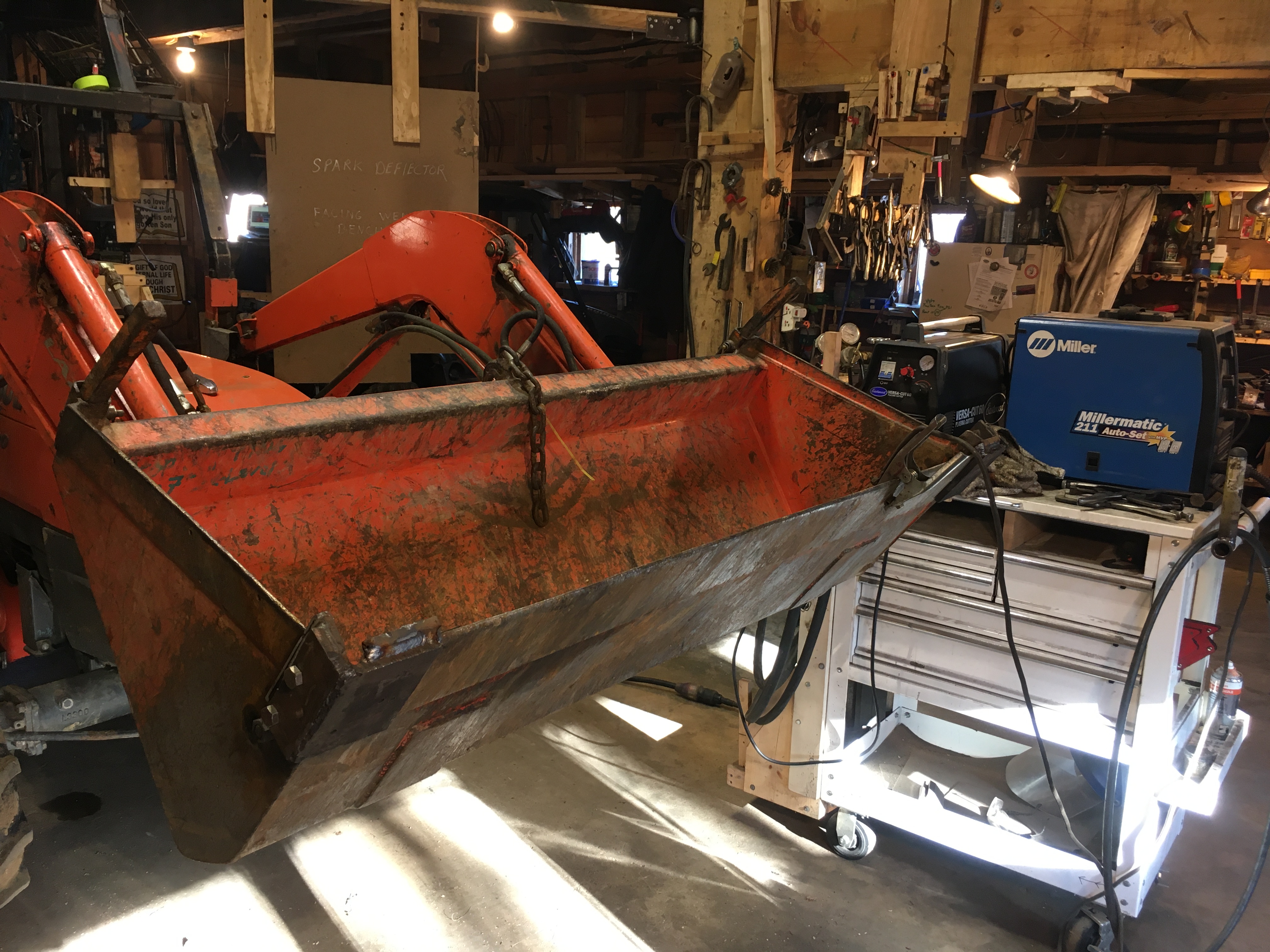

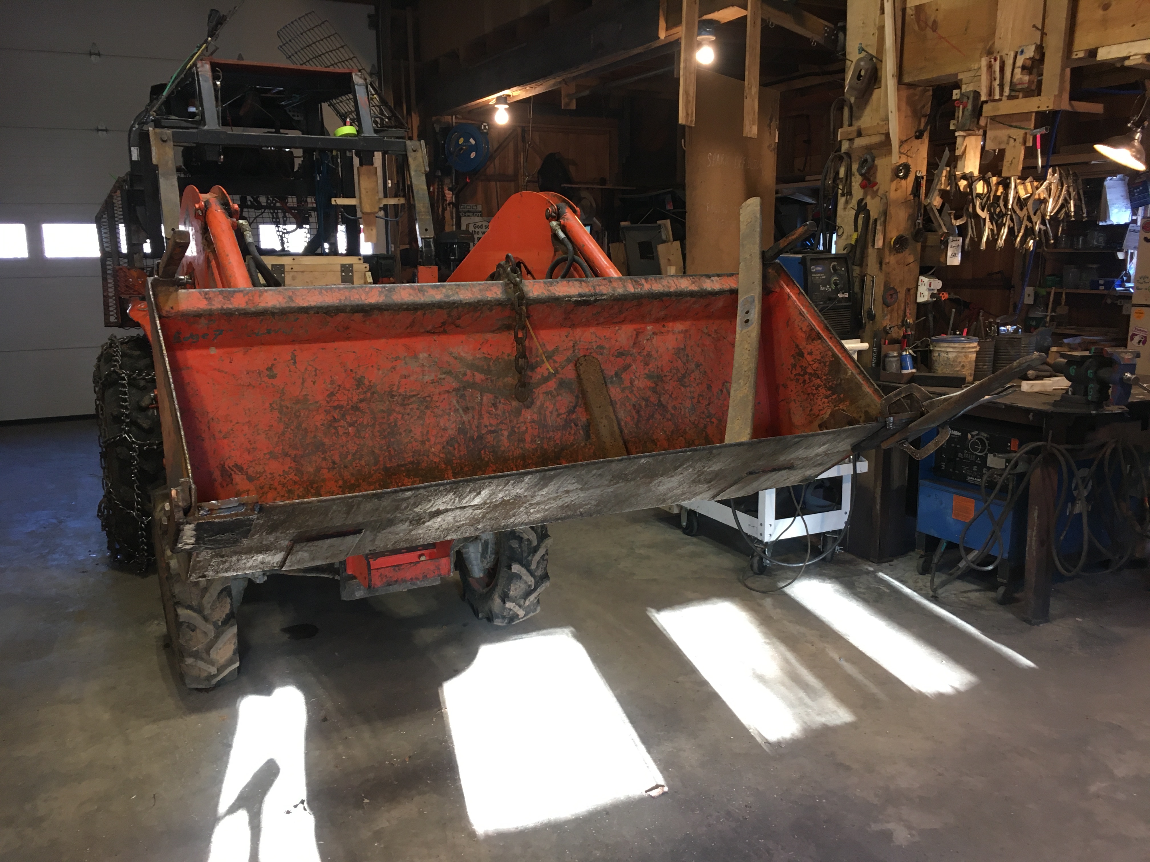

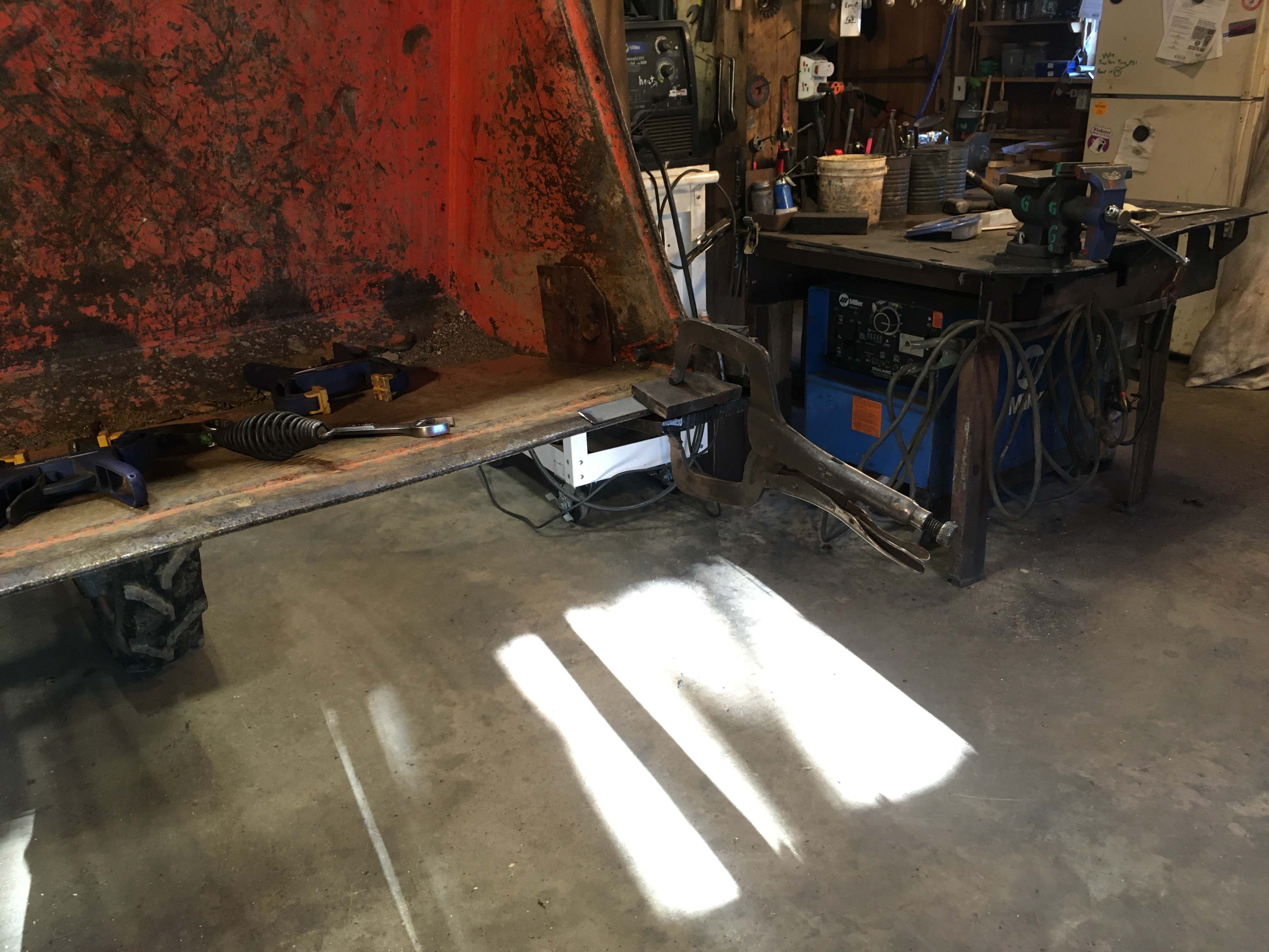

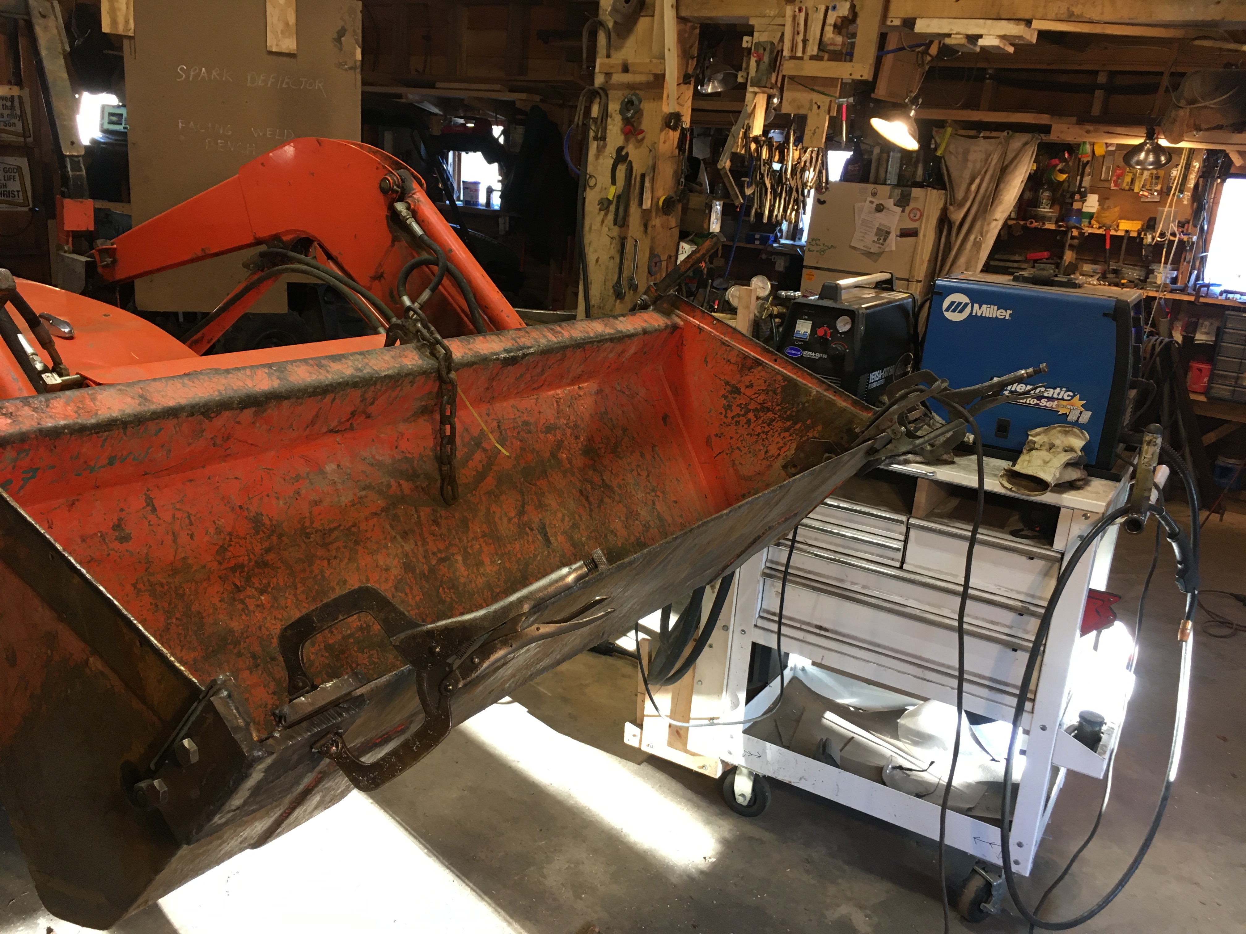

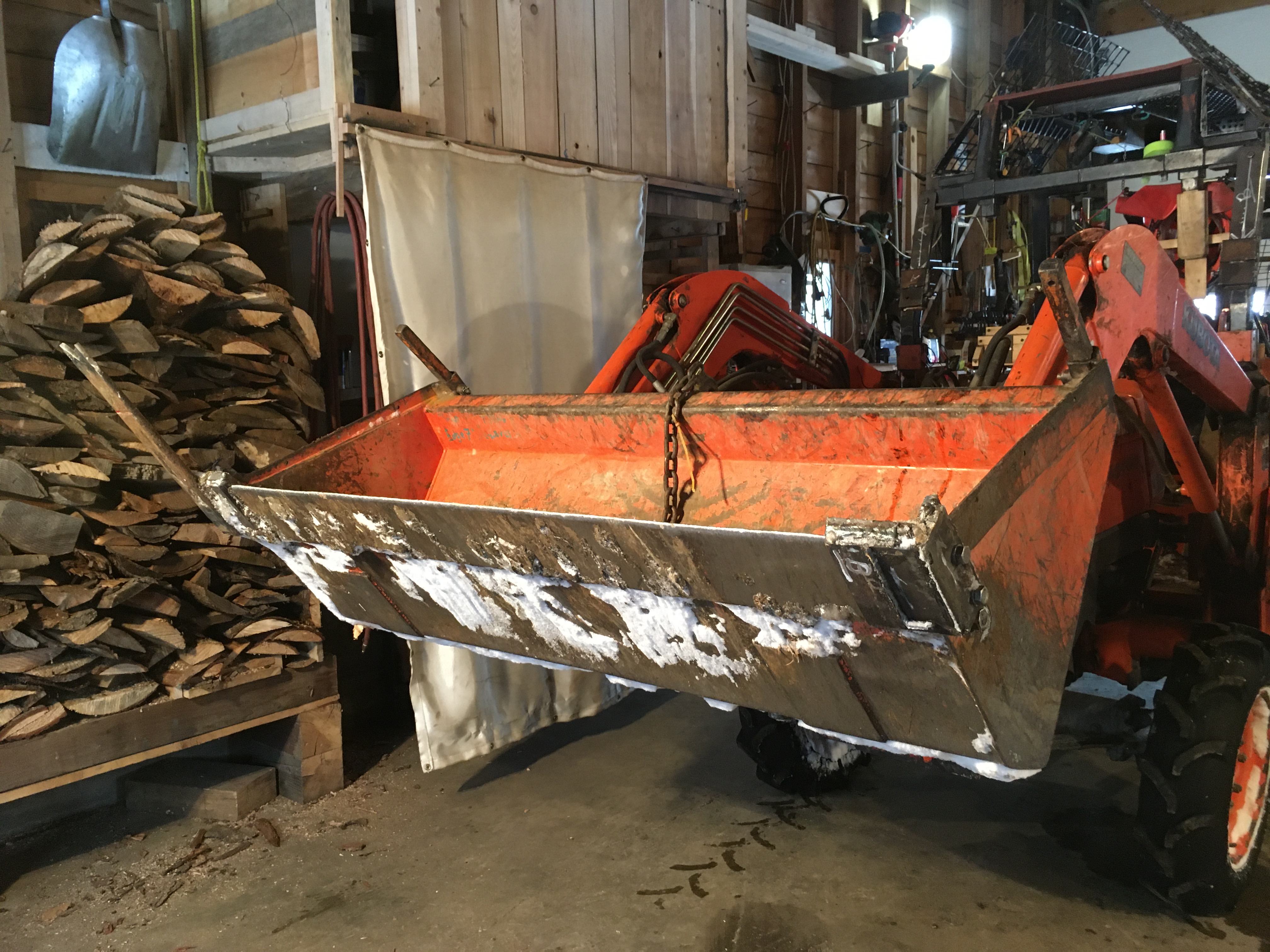

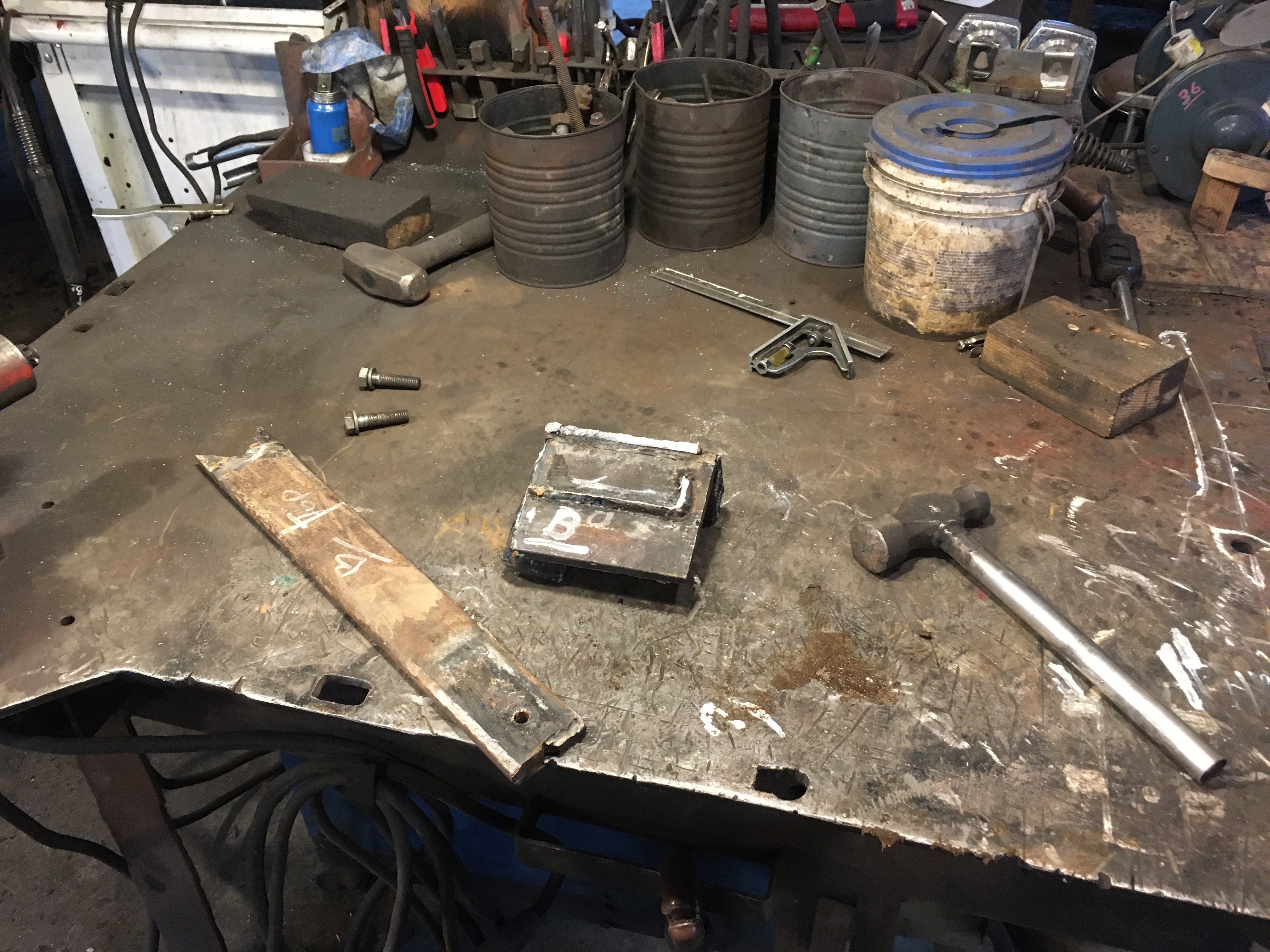

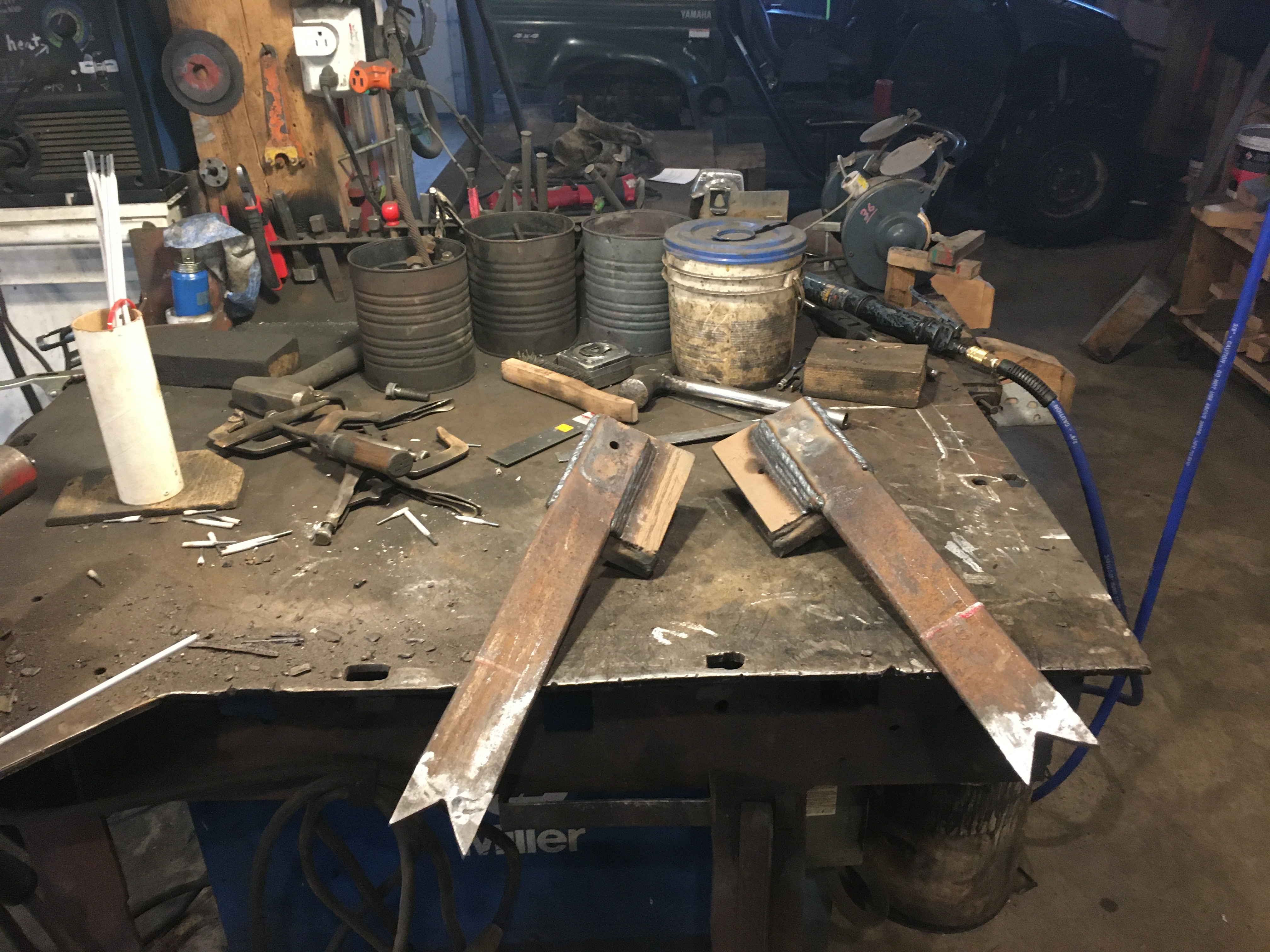

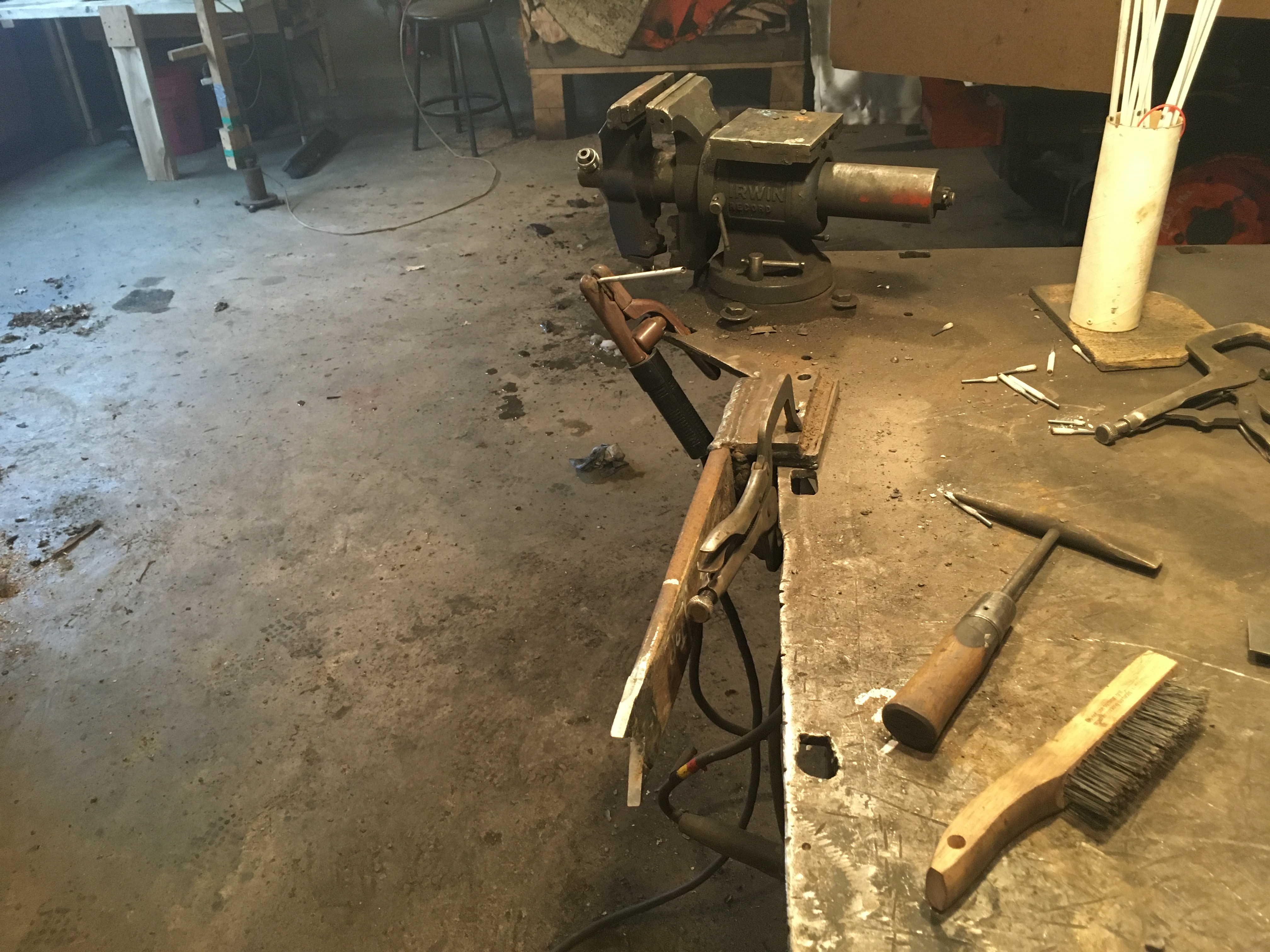

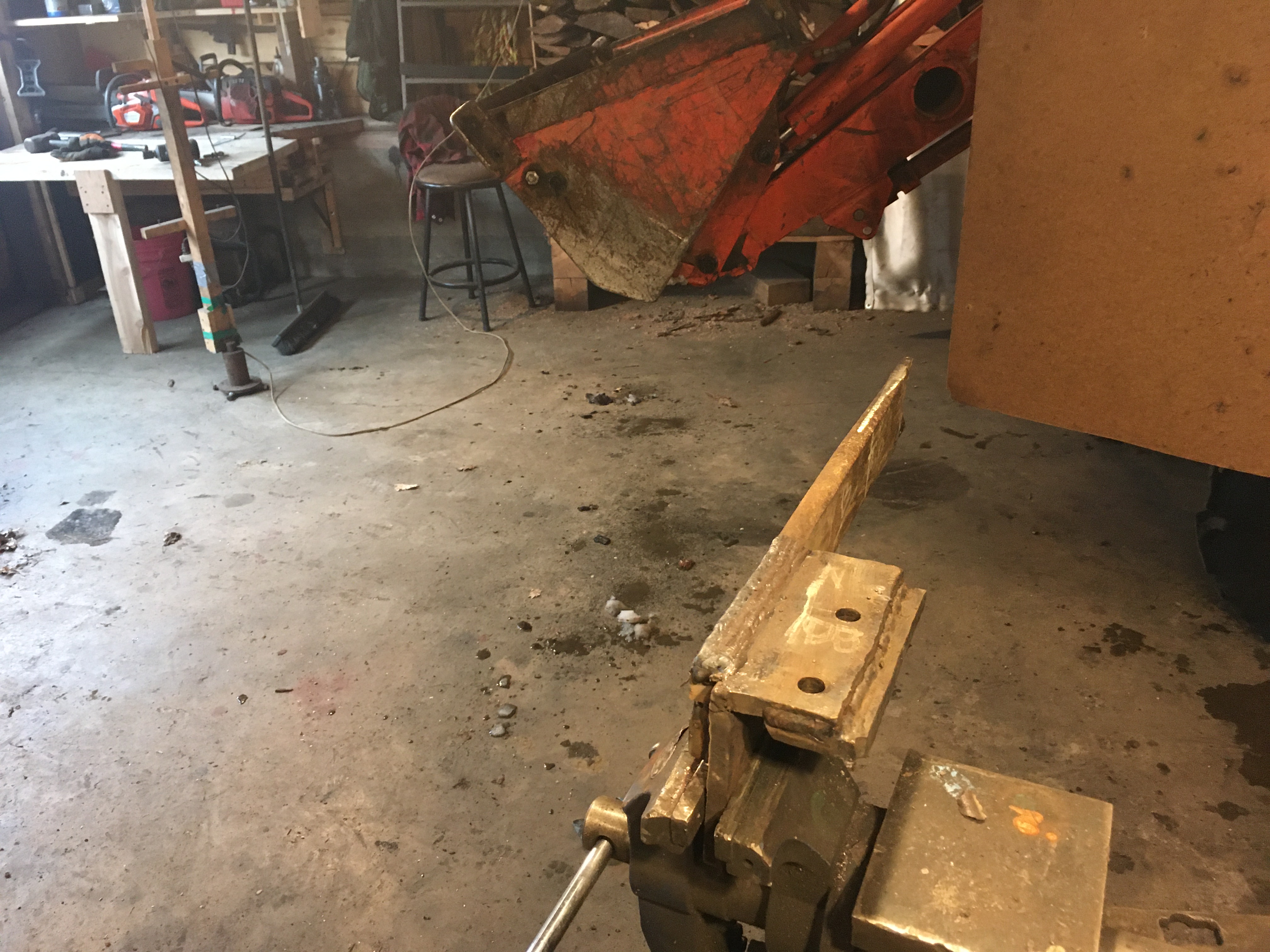

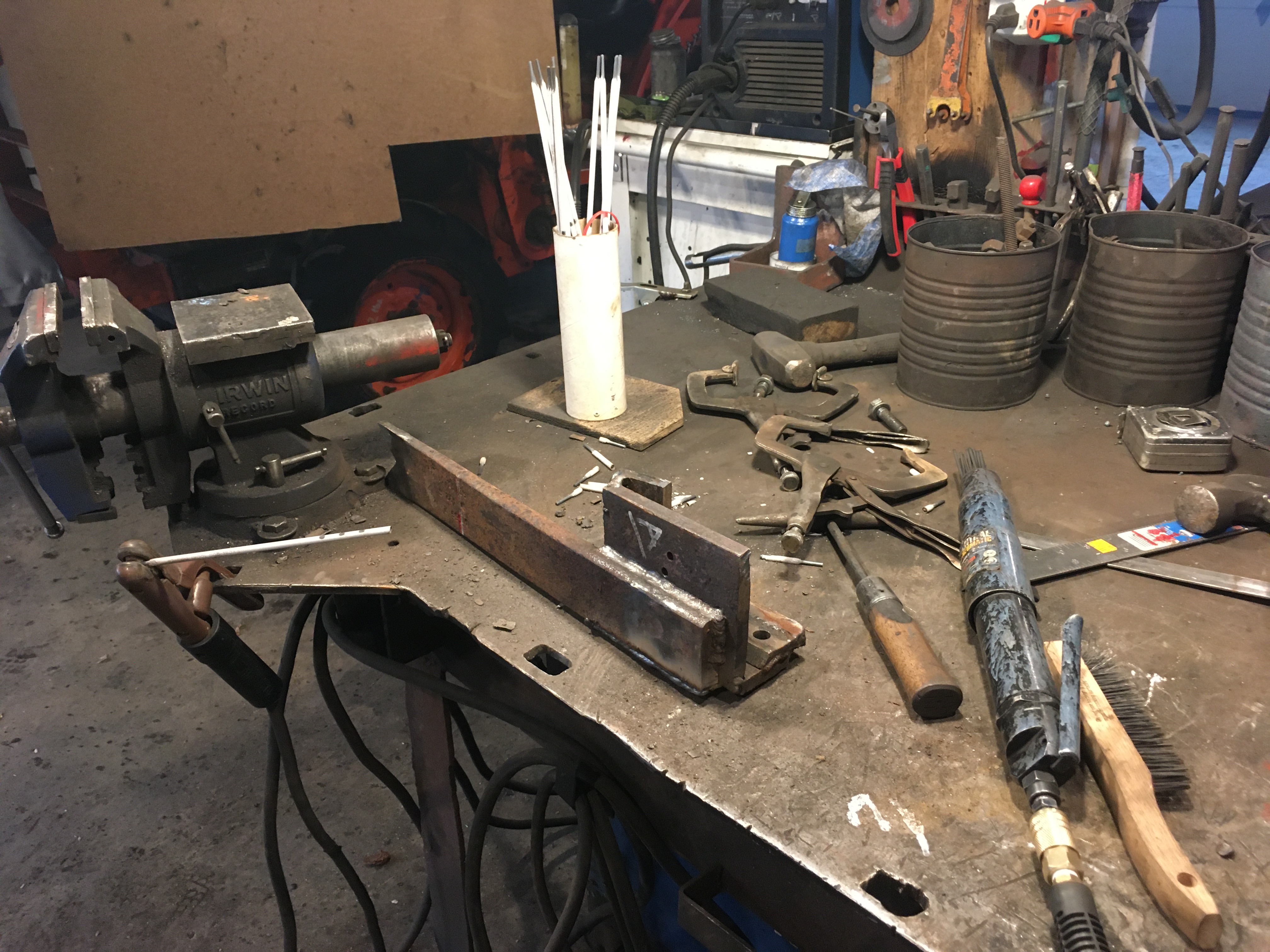

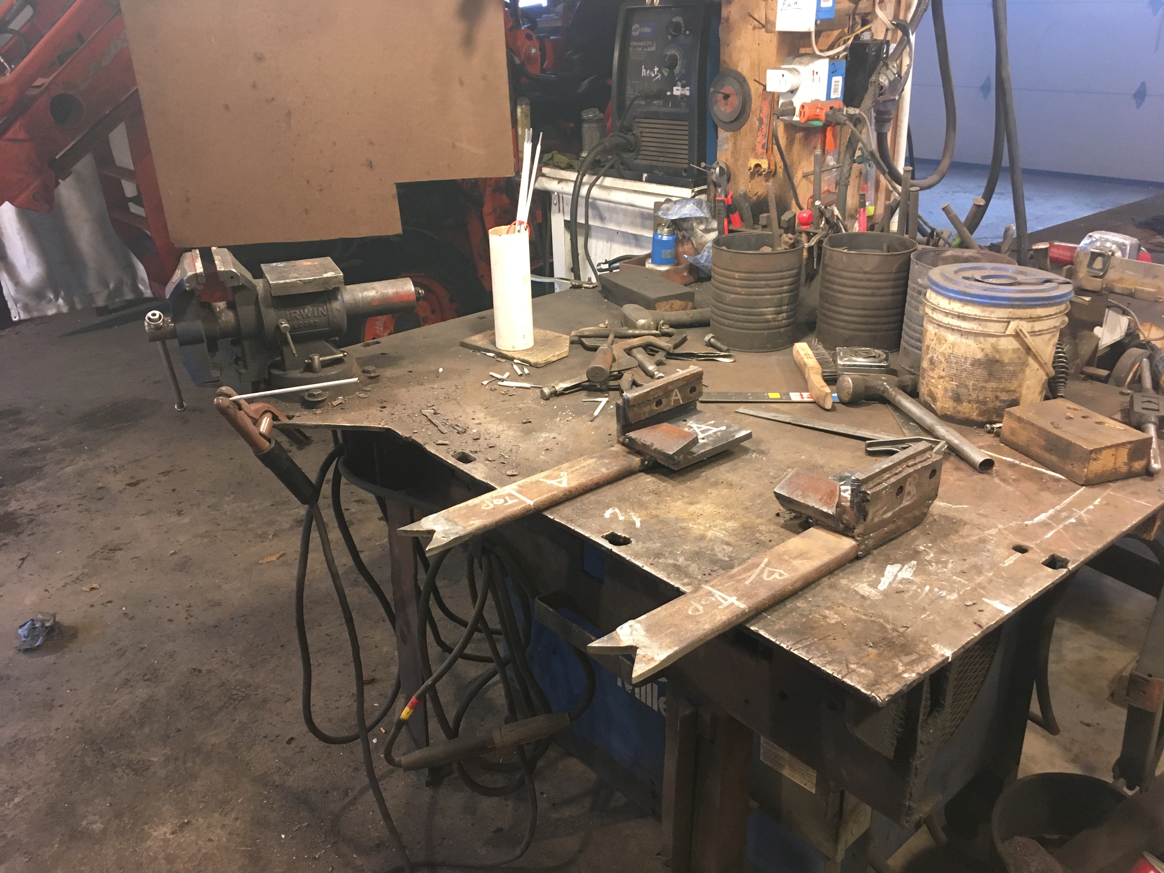

How much freeken weld does something take to make it hold, evidently more than one pass. If I still have multi pass everything with 10018 then might as well stay with 7014 or 7018 rods. I went to move some brush and thought I heard a clink clunk clank ting tong ping pong, so lifted my bucket up and one fork stayed in the snowbank........
View attachment 686450 View attachment 686447 View attachment 686448 View attachment 686449
View attachment 686452 View attachment 686453 View attachment 686454 View attachment 686451
View attachment 686457 View attachment 686456View attachment 686455
Do you have a picture of the "hook" that goes over the lip of the bucket? Looking to build something to go over the edge of a bucket to mount a pair of round bale spears to and I need a hook similar to what you have there.

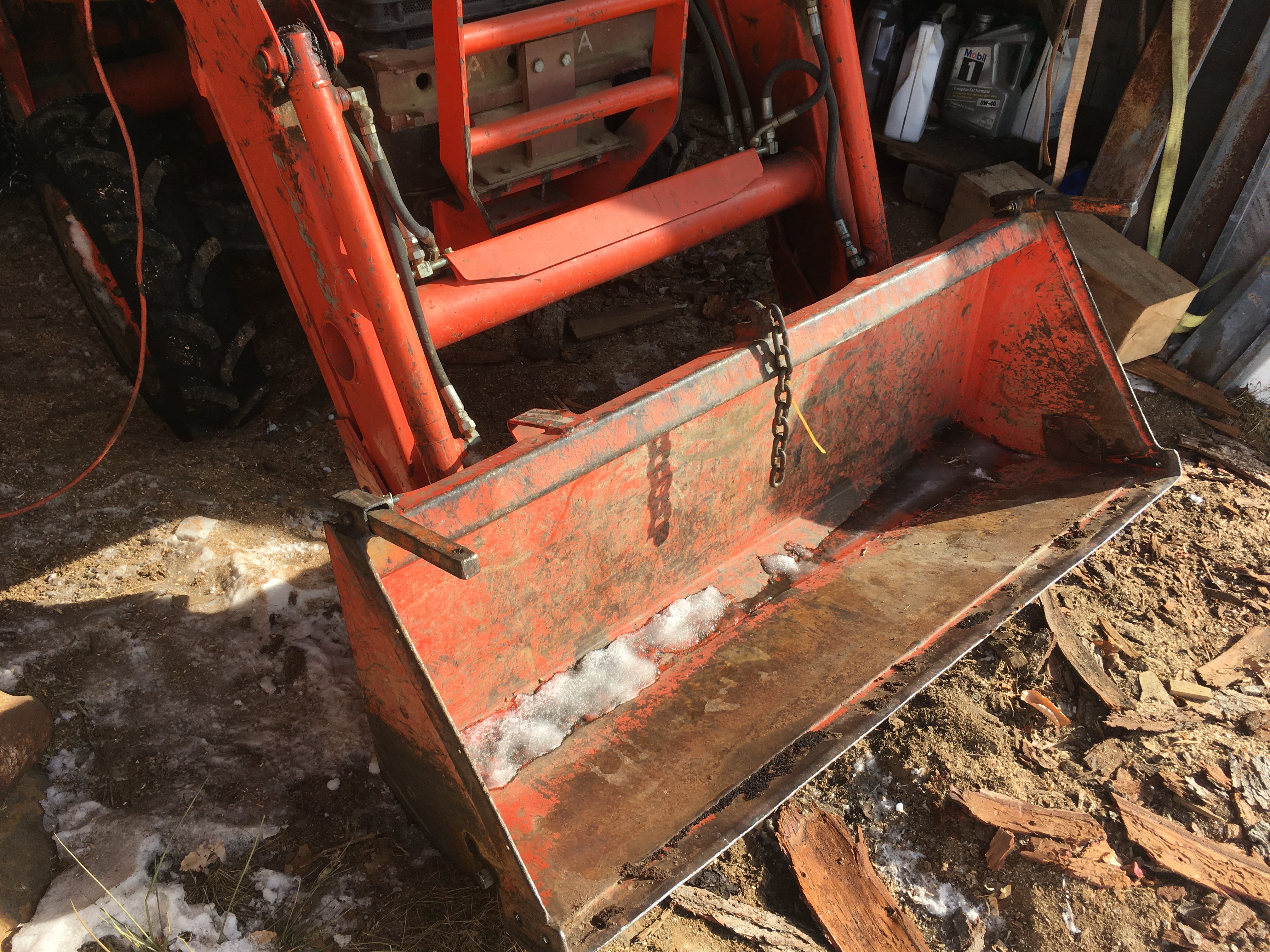

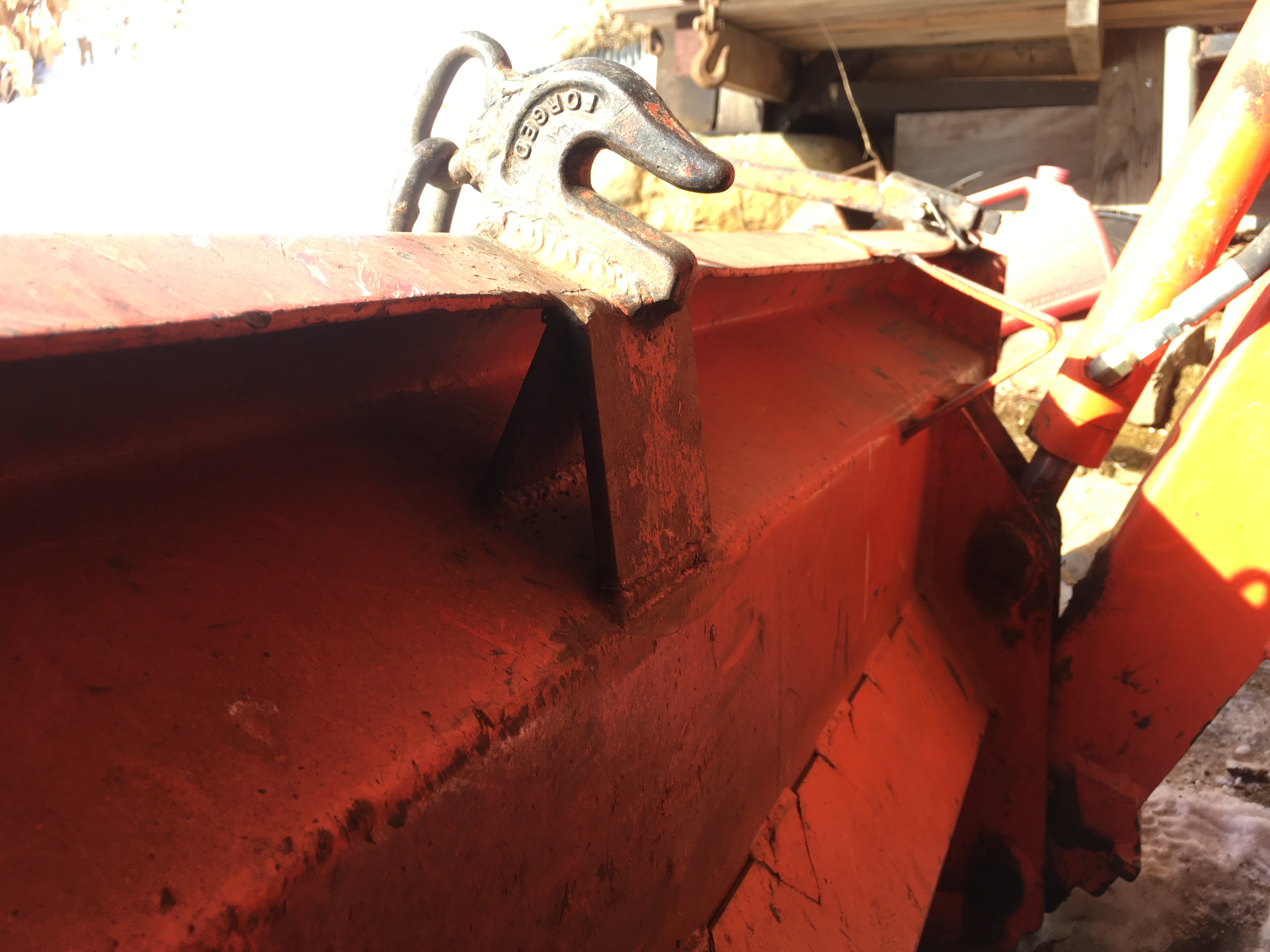

Aaron Z
My bucket hook was added on at the dealership, does come in handy.

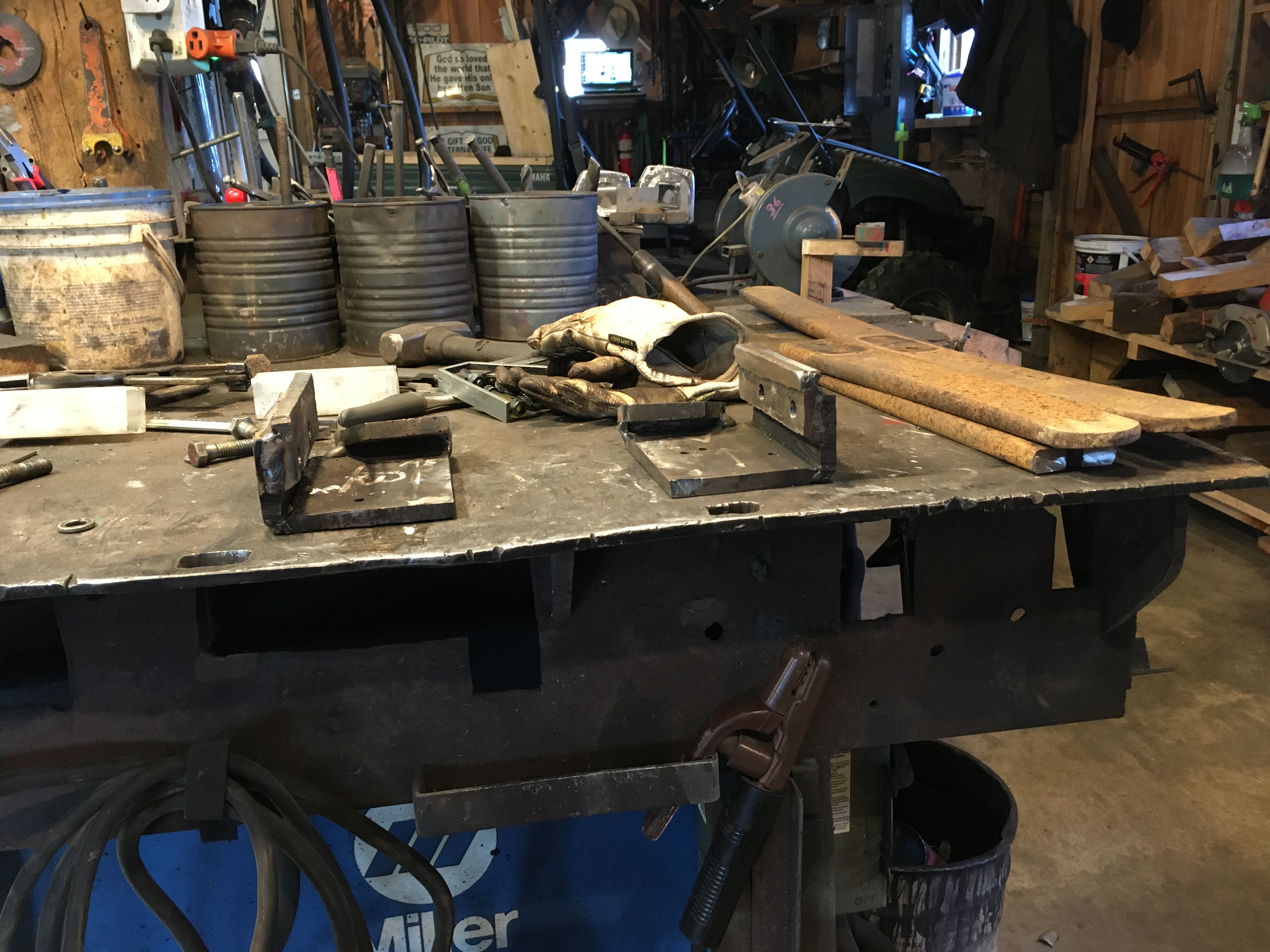

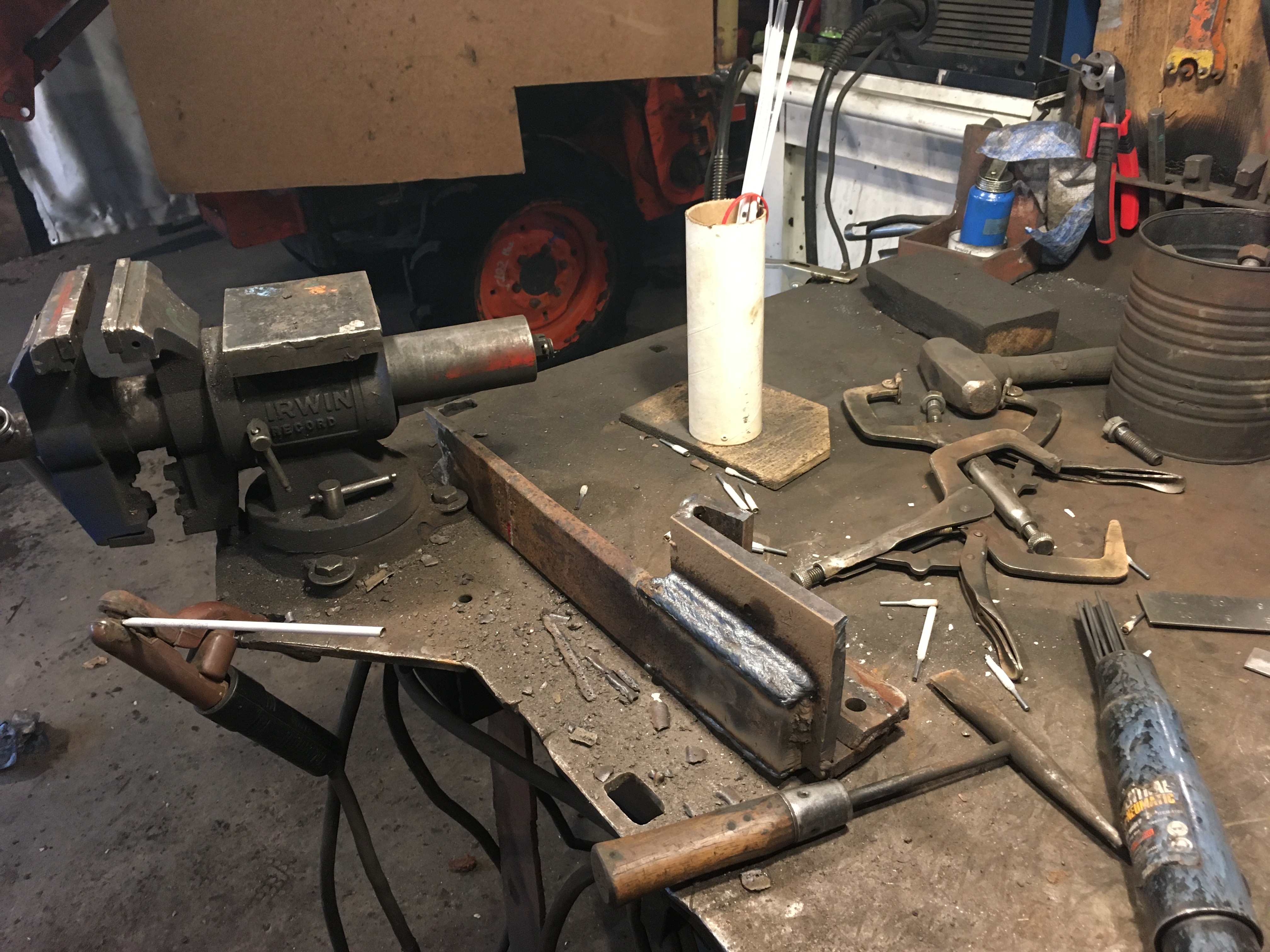

Sorry, I meant the piece on your fork bracket that hooks over the lip of the bucket as seen here:
It looks like a piece of flat that is welded at an angle, but is there more to it?
Thanks
Aaron Z
Gotha.... That bolt-on angle bar should've been an inch longer, the way it was, was like a kitty corner but weld with gap, fortunately mig welding works good on gaps. I placed a thin shim on cutting edge then clamp both pieces together, as you can see with the forks hooked on cutting edge there is less stress on 1/2" bolts. So after welding them together I unbolted and used a Ford wrench to knock the piece off...
