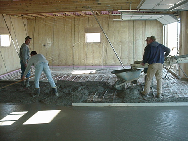

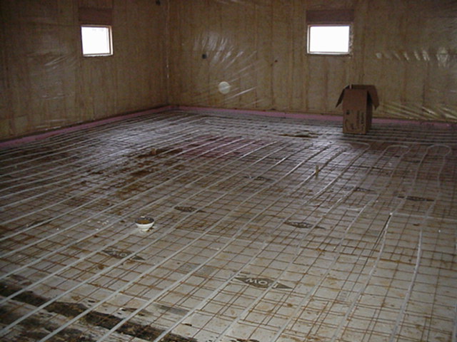

I've got a moline "hot dawg " in my garage under the house ,and it is a great heater . But, I'm in the process of building a pole building (ran out of garage ). I'm very tempted to go with Radiant floor heat . Are there any significant advantages,or pitfalls to this type of system ? If I were to use radiant heat, I'd like to use an on demand heater (Takagi ) as the one I have in my house for heating water has proven to be bullet proof . Thanks , John

Another thing that works well is when you put in a new floor is heated floors just run your lines and hook them up to a hot water heater and install a pump to circulate it.
