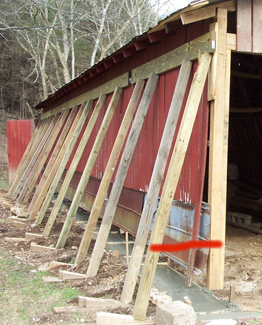

I had to replace the concrete grade beam on one wall of our barn built in the 30's. Turned out to be easier than I worried about. I was worried about coming up with enough jacks to lift the building and then I saw how to do it with posts and wedges which was no real problem.
I attached a ledger 2 x 6 with bolts into the top of the wall and then used 4x4 posts set at an angle to jack the wall up. I only raised the wall enough to clear the old grade beam foundation. The 4x4 posts rested on a 2x10, and an oak wedge was driven in with a sledge hammer between the 4x4 posts and the 2x10 to raise the wall off the bad foundation. The old concrete grade beam was pretty easy to break out. Then I cleaned up the footer with a shovel, set forms and poured a new footer. Then laid block. My wood sills were also shot, and I had to replace them, too.
During the time I was doing the prep work, I also put concrete blocks under the walls to further stablize them.
You may not do yours the exact same way, but the point is that it can be done without necessarily having to buy a bunch of steel and jacks.

This picture may help visualize one way of lifting the wall. I added a red line in the picture where bracing could be added to further stabilize the wall once it is up. I probably should have added this brace about every four feet or so, but didn't think of it until now.
Keep in mind that I removed a concrete grade beam that was about three block high. I didn't lift this wall 18" into the air. I did remove a sag where the wall had sunk because the foundation had given way, and I straightened a bow out of the wall.
If your garage is located in an area where vandals might come along and knock your braces out, then I'd be thinking about supporting the wall with temporary cribbing, concrete block, all thread or something else until I was ready for the pour.
If you try to lift all four walls at once, you will have to add more bracing to be absolutely sure the building isn't going anywhere until you set it down on the concrete.
