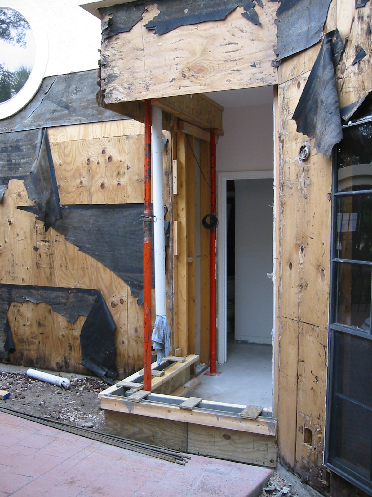

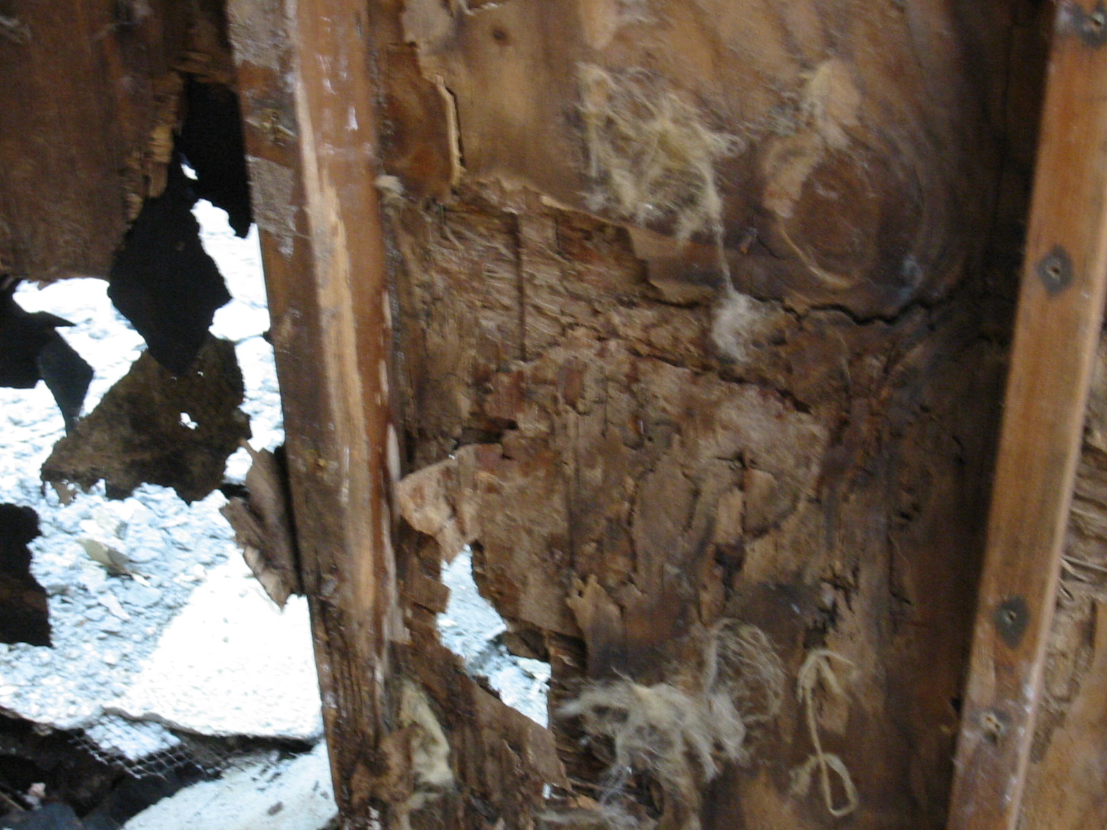

I had to repair a house with a clay tile roof that was distroyed by termites. Roof was ok, but every wall had to be replaced.
Went down to the rental house and got some large jackstands. Went to the lumber yard and got some long beams. Then a 4x4 and a hydraulic jack were used to lift structure and the jackstands held it.
I know you want to pour a slab, but you should jack from inside, and then provide final support from outside.
I just want to make sure I have sequence correct.. You poured the slab first, raised the structure and then put down a foundation?

man, that is some serious termite damage.....

It is possible to (1) pour a concrete slab just inside of where the footer/wall foundation would be, (2) raise the building straight up off the slab with a jack; and (3) pour footers and wall foundation in that sequence. Based on the post by 8934, I think he is also suggesting that the exterior walls should be braced. This approach is certainly an improvement over the termite eaten structure he started with.
