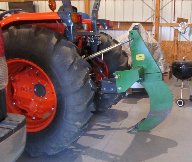

Built 2001 so it's 11 years old and is a Morton pole barn. Epoxy done maybe 3 or 4 years ago. Did the garage too. I'll look for more original photos but we might be out of luck. I used to have some taken after I first finished but can't find them. Here's a mediocre photo example.
The floor has built-in anti skid properties so it's not a high gloss but a soft lowish-gloss leaning towards somewhat slightly flattish gloss. If I were to gloss clear over this now it'd be like leather shoes on clear ice. But it would be pretty.
Many commercial places use this product so check out fire stations and police depts. It comes in a few colors but gray is 99.9% of what I have seen. Sprinkle flakes cancel out the anti-skid so nix that. You need the anti-skid or trucks slide around on the high idle of start-up.
Not positive but pretty sure this is the product. I see they now suggest primer and may have way back then but I didn't and was likely given the advice not to.
http://protective.sherwin-williams.com/detail.jsp?A=sku-26298:product-6878

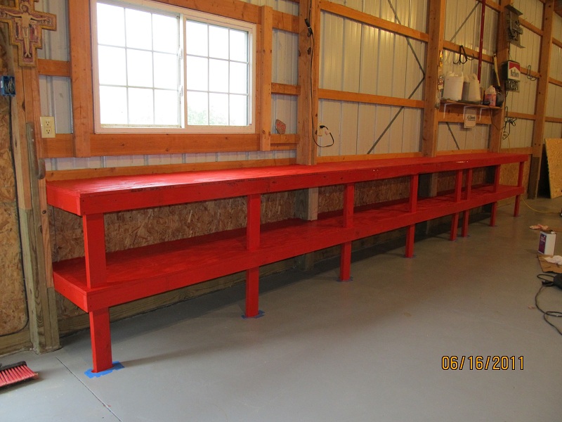

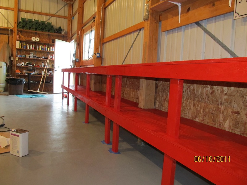

Here is a Update, Hopefully the build will get back on track, Had a few other projects to tend to.

Thanks, the detail work is makes it nice but it is also what makes a project take longer.
   / Garage/Shop Projected started Here are some Pic's #120
Great looking work. All the time spent on the finish & detail work will pay rewards for many a year. Not only will it be safe and strong, but the good looks will provide a real sense of pride every time you look at it. :thumbsup:
