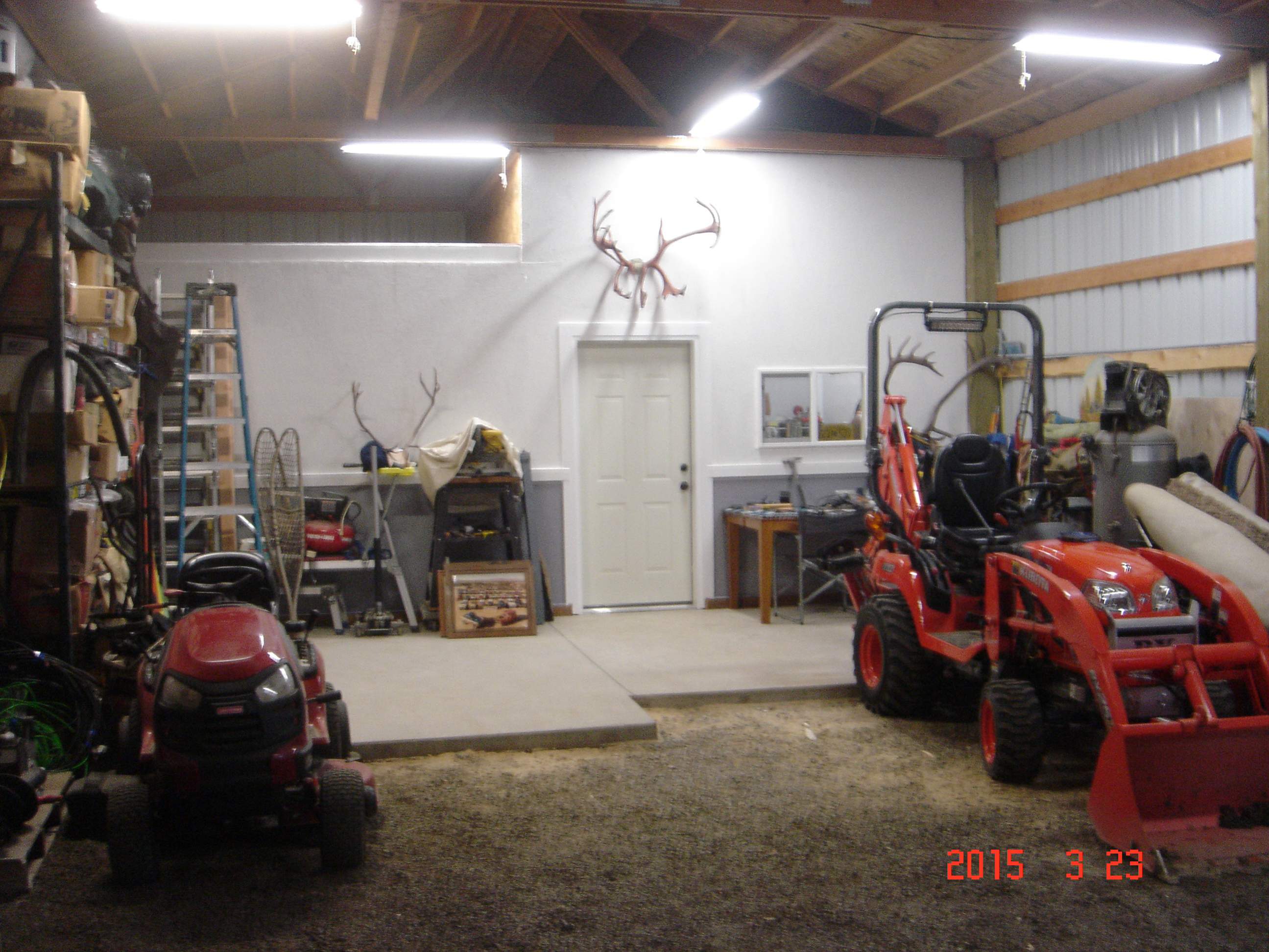

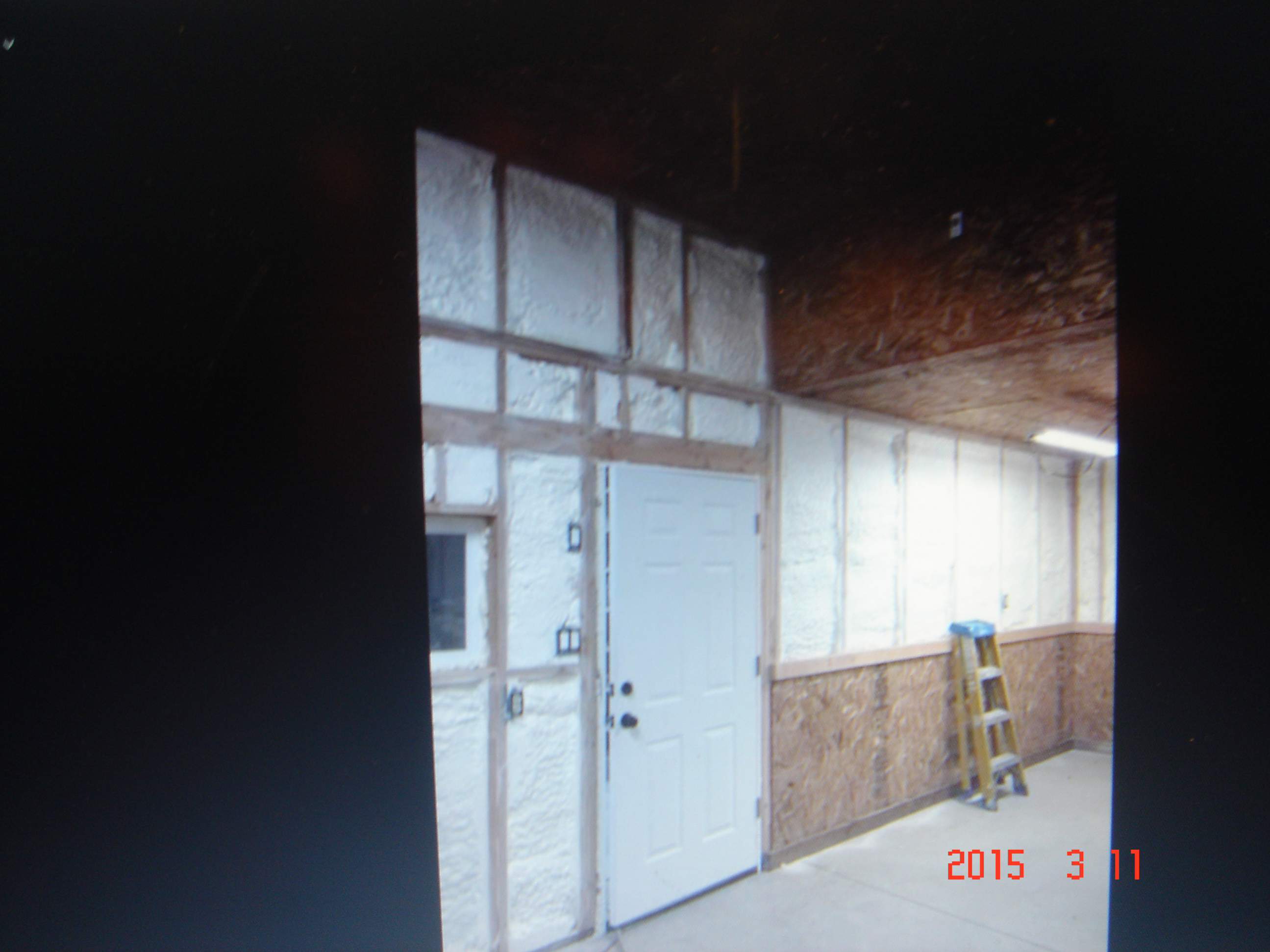

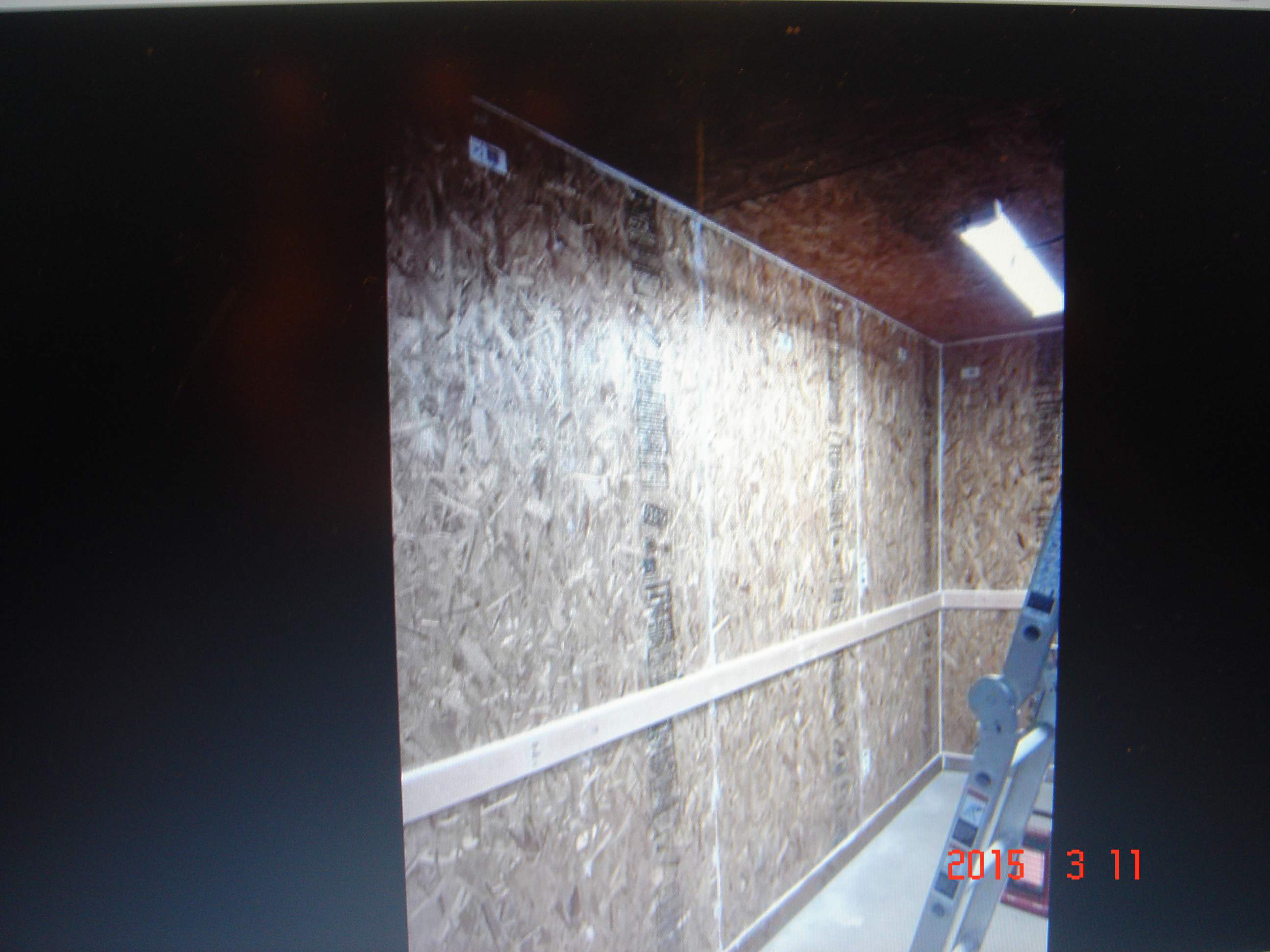

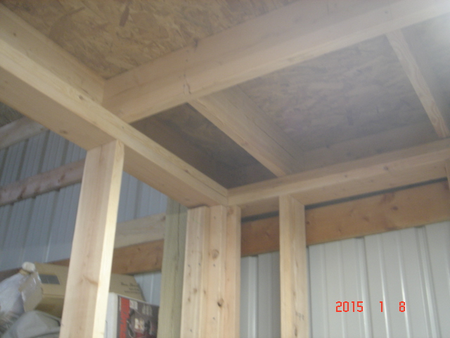

I just built a tool room across the back of my shop, 24' x 12' with half a 8' ceiling and the other half at 12'. I did the walls out of 2x6's and ceiling with 2x8's so I can deck the top of the 8' ceiling for bulky storage. I put pressure treated 2x4's on their sides along the bottom around the whole interior, then 36" of OSB than another 2x4" above that. its great to act as a bumper, or to attach cabinets to, as there mounted to the studs in the walls. I also spent the extra coin to have the walls and ceiling spray foamed. the room is a sealed envelope, and stays warm in the winter and cool in the summer. I have a dehumidifier installed to keep it dry, and will add more lighting and a ceiling fan. Make sure you use a QUALITY primer on the OSB or you will never seal it, and the paint will just soak in. I went so far as to get a case of caulking, and seal every panel, and where they meet the 2x4's before priming. do it once, do it right.
   / Garage Wiring #29

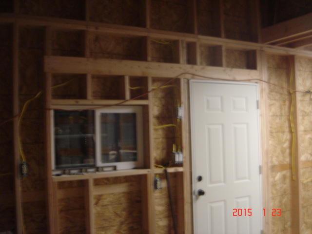

With 2x6' walls, the wiring is safely in the center of the wall and ceiling studs as the 2 1/4" sheeting nails cant reach it with OSB on the face also. I put in way too many outlets, but once the foam went in, nothing can be moved or changed. all wiring along the inside of the studs needs to be stapled at the boxes and every 2'.
   / Garage Wiring #30

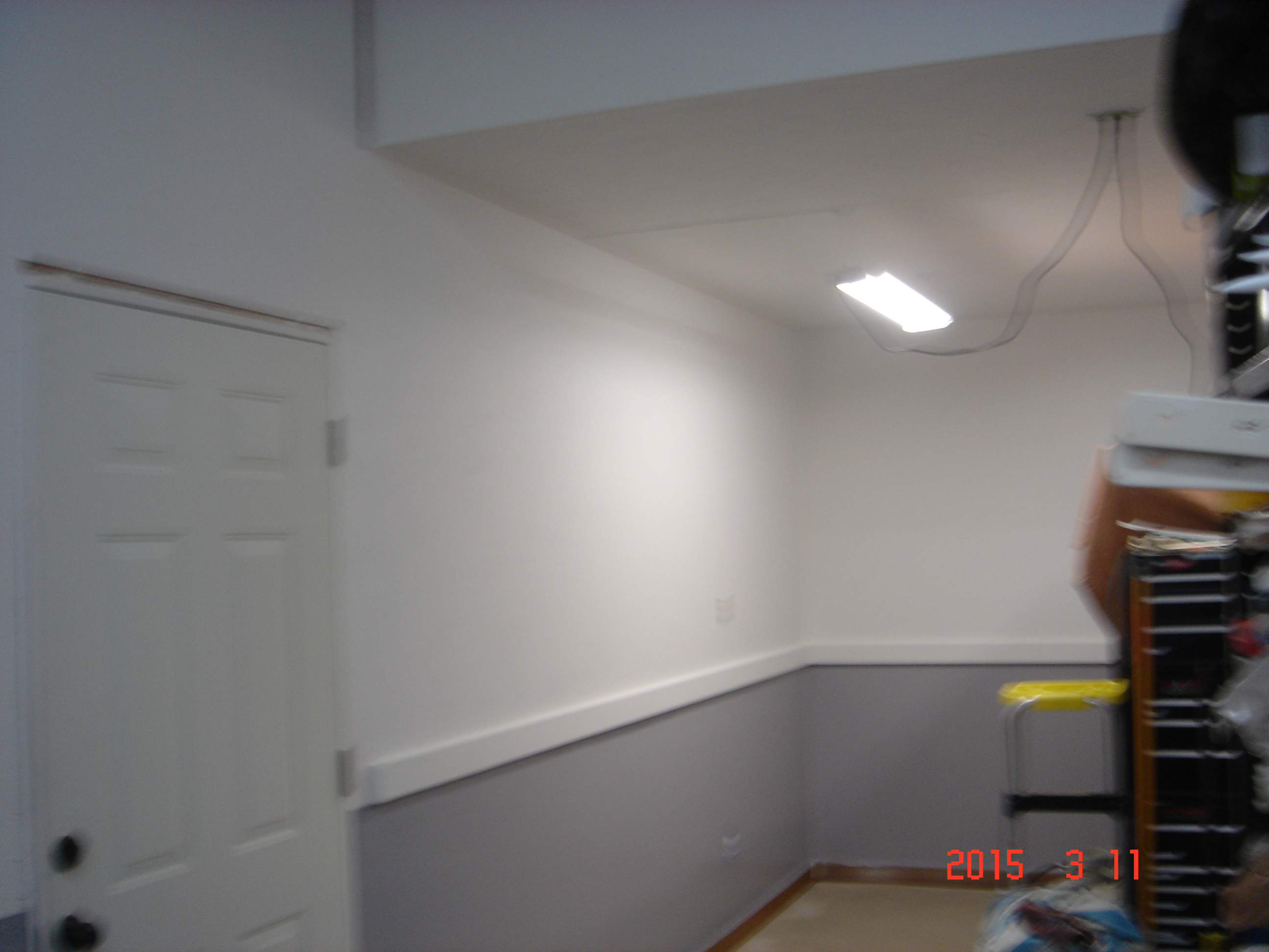

with the wiring in place, and encased in foam, I added the 2x4's, OSB walls, and caulked it all, including around the electrical boxes, for Zero air infiltration. Get a quality oil based primer, specific for OSB. I used a semi gloss to brighten up the room. trimmed the front wall the same way. eventually I'll add shelving to the front side. with the dehumidifier inside, its a climate controlled, dry room for toole etc. Its probably overkill for a room inside the shop, but in my opinion, "OVERKILL IS UNDER RATED" I don't think it will ever fall down.
