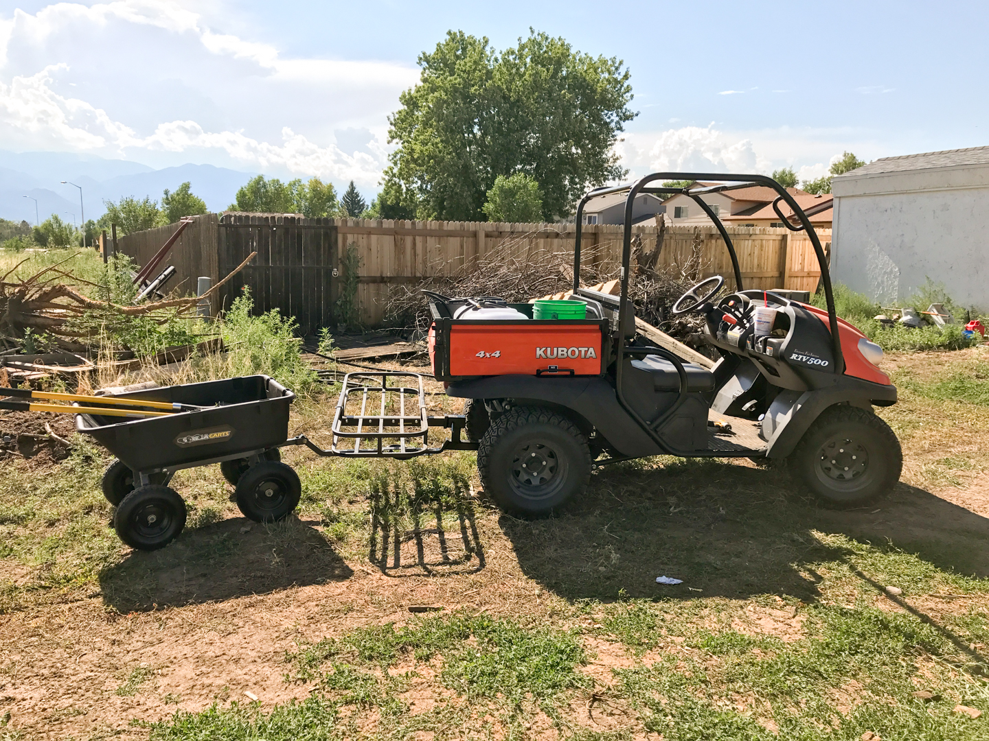

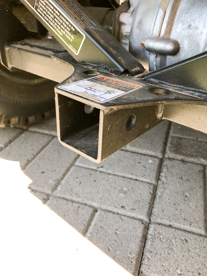

What adapter do I need to connect this Gorilla Cart pin to the 2" receiver on my RTV500?

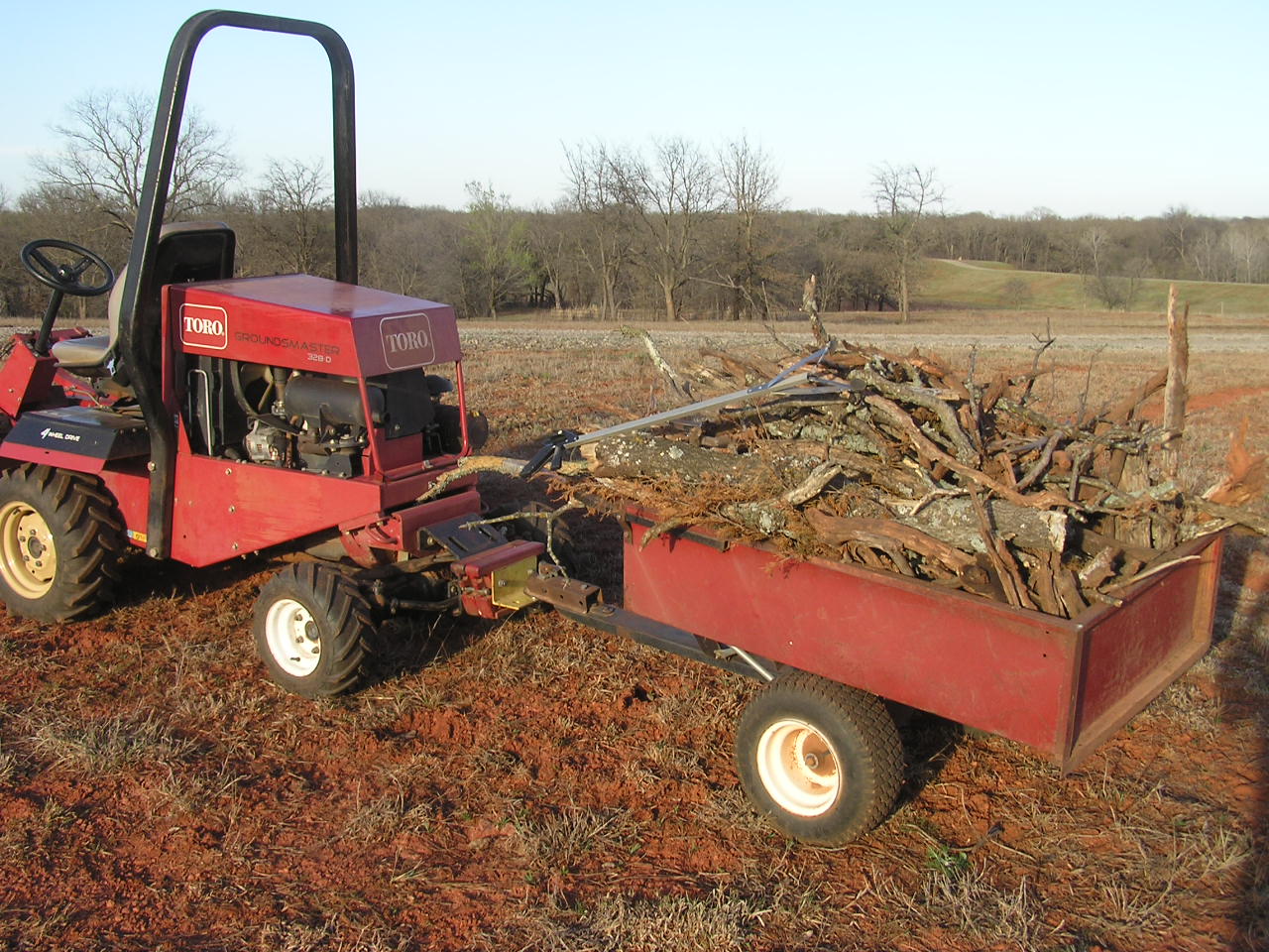

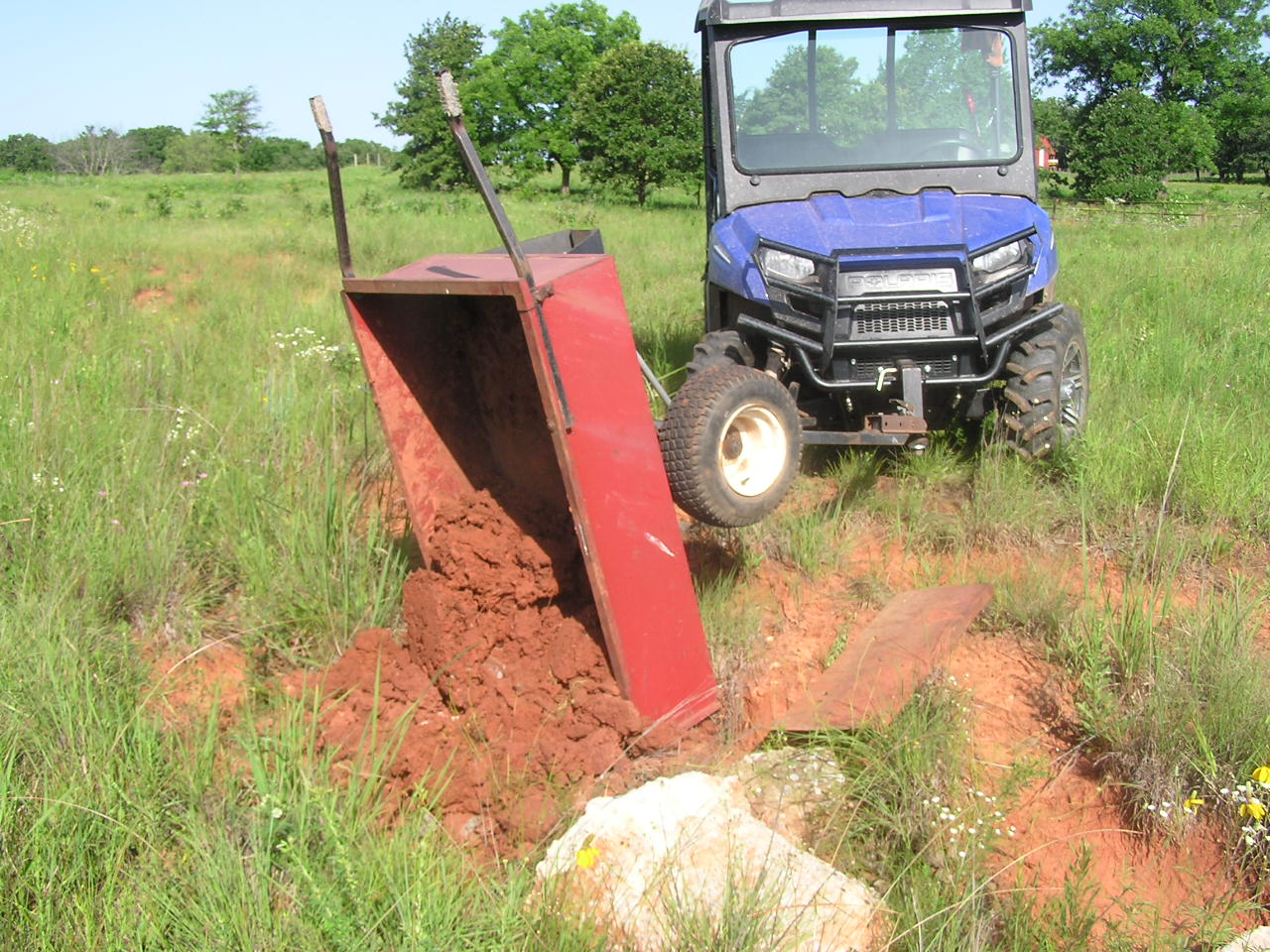

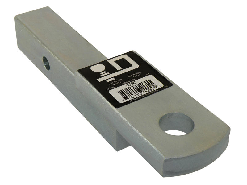

I use something like this without the hitch ball.

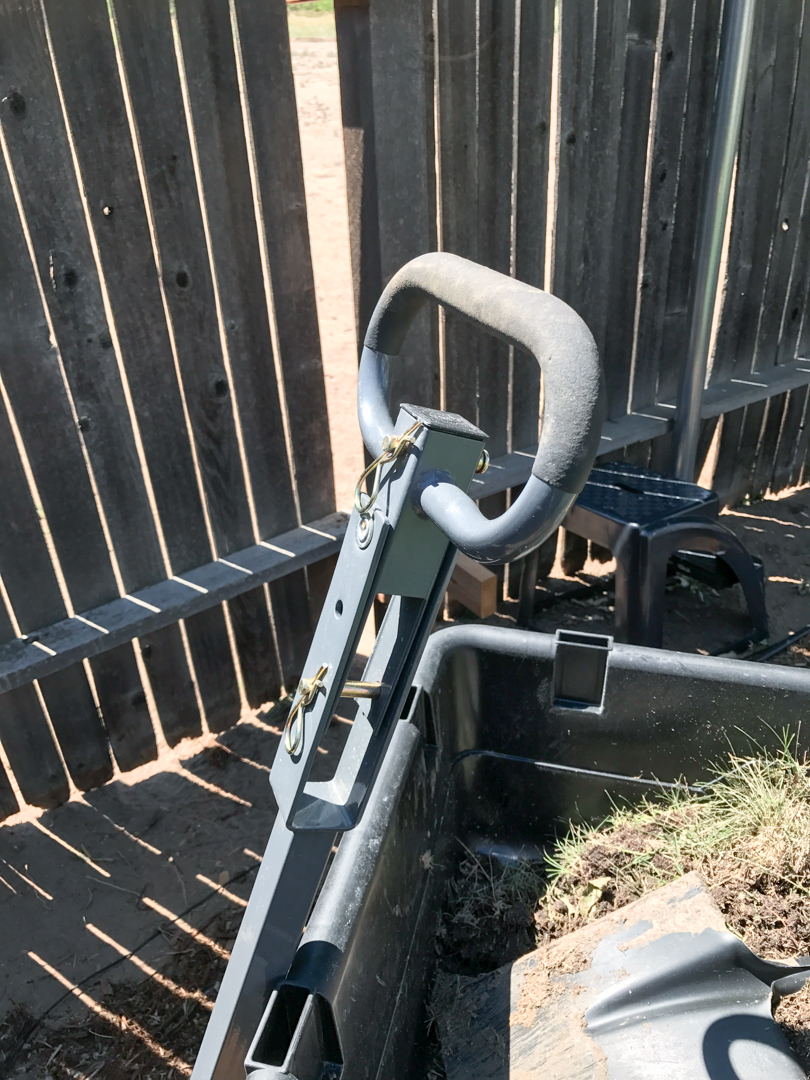

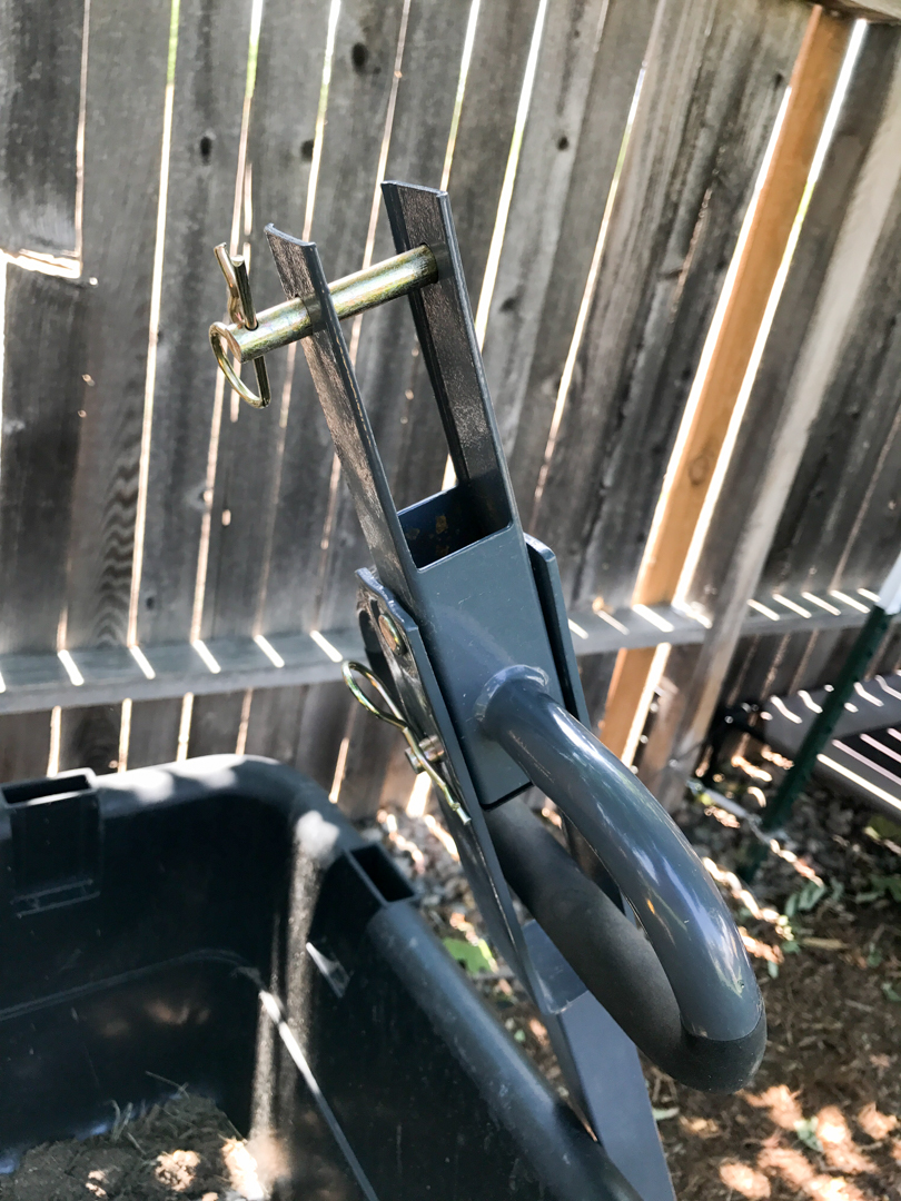

What you have to do on the cart end is to remove the pins that hold the round handle. Flip it 180 degrees and reattach with the pins. Now you will have a "U" shape to attach to the receiver hitch ball mount above. I use a long pin and avoid needing to attach a cotter pin. It will look similar to a standard cart coupler like this
This is how it will look hooked up to what you're pulling it with.
Easy peasy.

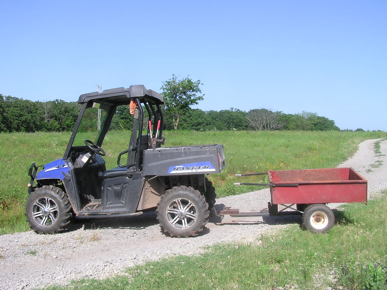

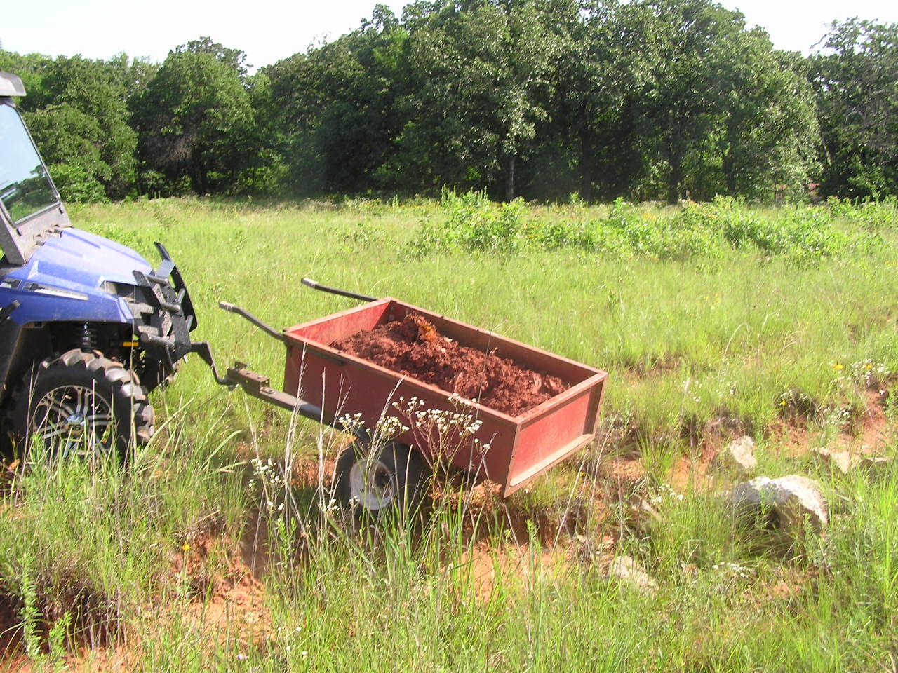

   / Garden cart <-> 2" receiver #3
Here's how my sprayer looks hooked up to my Mule.
Before getting your hitch ball mount, hold it up to the receiver and determine what degree of drop you need to make the cart level. I found the 1/2 inch drop worked for me. If something else is too low, you can always flip it to make the same degree of lift instead of drop.

Are there any specific pin / hole sizes I should be aware of?

The great thing about having a 2" receiver is that one can set up different mounts and quickly switch between them. I use the flat bar shown above, a hook, a clevis, and one set up with a 2" ball one one side, 1 7/8 on the flip side. I use them on the truck, Mule, and Kubota tractor. I've found them at yard sales mostly. Very inexpensive that way.
Pin sizes.... you'll have to measure the diameter of the holes on the cart side to get the right width pin. I think mine is 4"-5" long with a large handle and I find I don't need to put a cotter pin to keep it in place. The hole on the receiver mount is larger than the cart holes will be. As frugalangler mentioned, it will have a lot of slop in the fit, but unless you'll be on the highway with it, it should be fine.

The hitch pin on the Gorilla Cart is 3/8".
I was sort of hoping to find something like that ball-mount, except with a smaller hole.

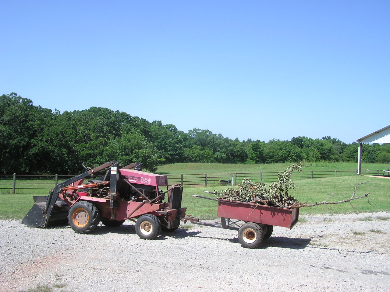

:laughing: Not yet, still two machines.
The mower:
I can pull it or push it with the loader:

I bought this Harbor Freight Haul Master Multi-Use Ball Mount and Hitch Receiver for $32 today.
Unfortunately, the hitch is about 5/8" too long to fit the short receiver on the RTV500. I'm either going to have to find a different solution, or cut a little bit off of it.
Can you grind a 5/8" deep vertical slot in the middle of the hitch to clear the differential?
After looking at your picture, you won't be able to use both at the same time. The basket will hit the tongue unless your land is completely flat.

The RTV500 doesn't have a particularly tight turning radius.
I haven't done any scientific testing (that will have to wait until my wife is home), but so far it APPEARS the trailer doesn't hit the basket when I drive in a circle.
Harbor Freight also sells an ATV version of the basket that might clear the trailer if it were a problem.
Another thought is the $30 Dual Hitch Extender and a ball-mount. Pushes everything out a couple inches.

I think I understand what you mean -- yeah, high plains here. Flat.
   / Garden cart <-> 2" receiver #18
Yep, front wheels go up, back of basket goes down, hits trailer tongue.
Back wheels go down into a depression, back of basket goes down, hits trailer tongue.
