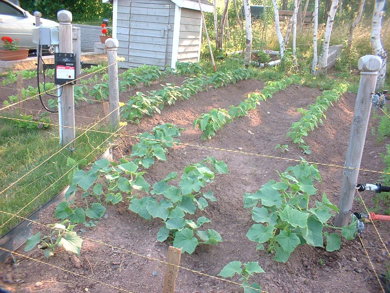

For deer and rabbits, i use electric fence. I like the baygard poly fence. Cuts easily and doesnt stretch too much.
For posts, i get the round pressure treated. Thry're pretty rough, but they serve the purpose well. I paid ~$5 per post this year and have around a dozen.
I used to have a mix of pressure treat poles (on the corners) and steel rods (between the corners), but this year i removed the steel (rusting issues) and replaced with wood.
I have 3 strands of fence. one at ~6" above the ground, one at 12" and the last one around 36".
We have lots of deer and rabbits, and since i put up the fence (4 yr ago) ive only seen 2-3 rabbits in the garden and no deer.
