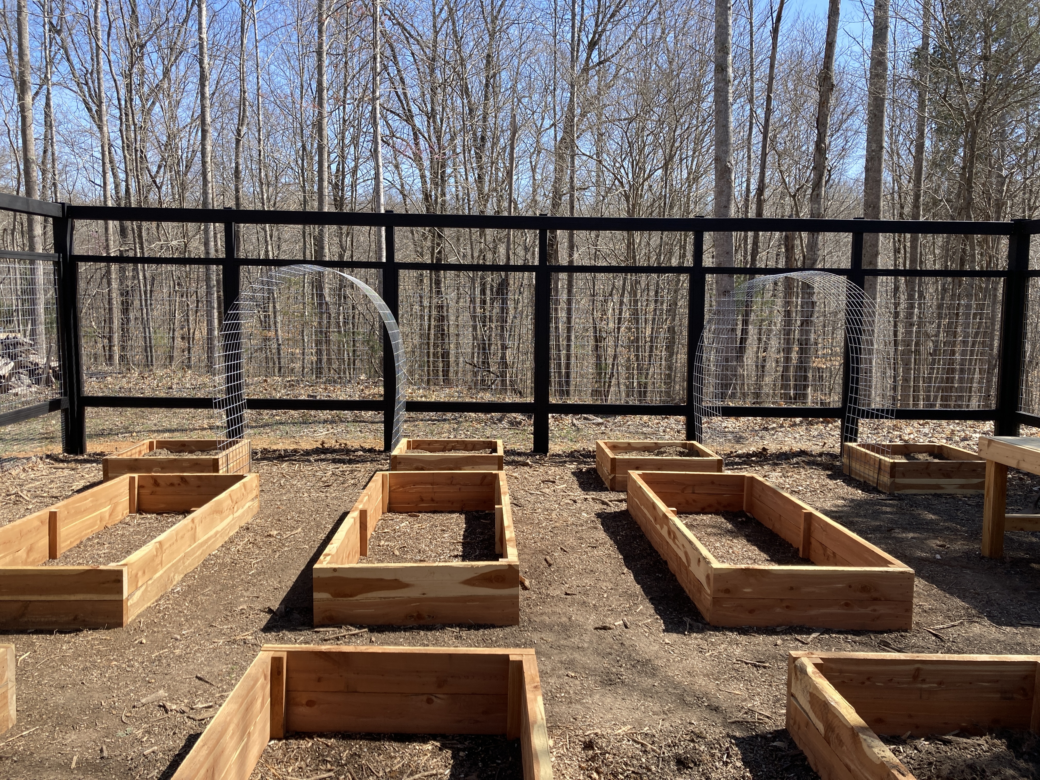

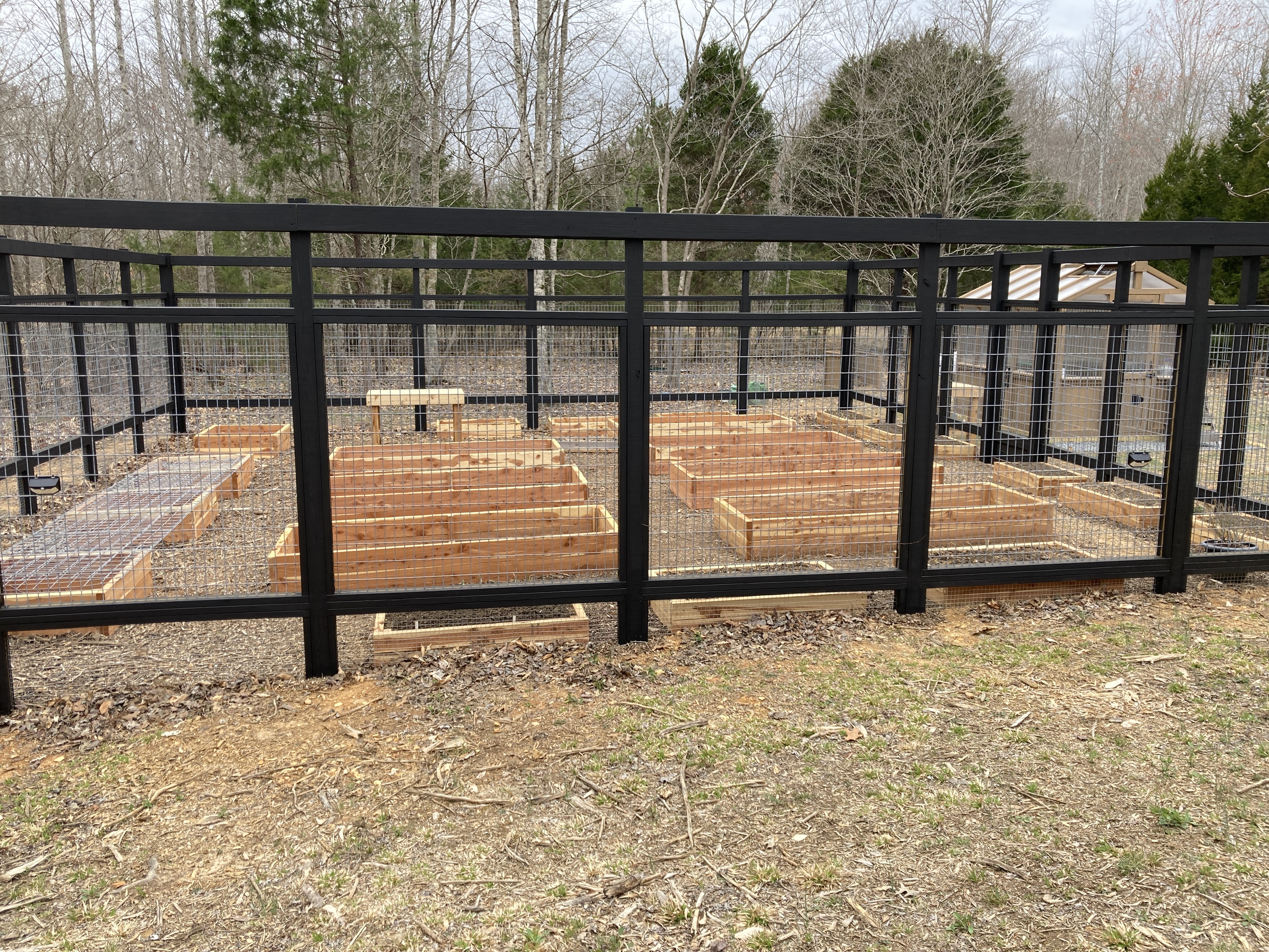

Some progress - finally got all the beds into the garden and got our cattle panel trellises up.
Looks like the 'natural' arc of a 16' cattle panel requires the ends to be 6' apart. We're at 5' so they bow over the beds a bit, but it'll work. Used 2' rebar (12" into the ground) to hold them in place against the beds.
Now we just need to move a bunch of dirt...

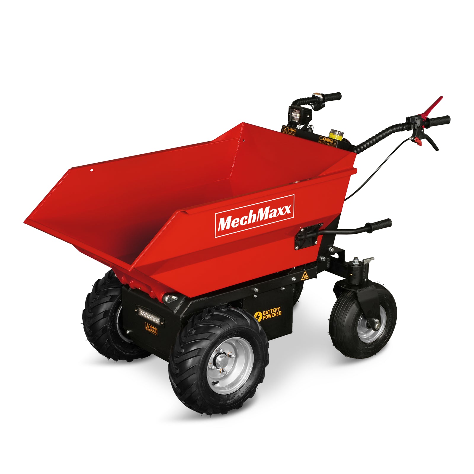

Can you rent an electric wheel barrow? This one is 29" wide.
   / Garden fence build
#139
I didn't know such a thing existed. That's really cool!
We're just using a gorilla cart which works fine. It's not the moving of the cart that's so much work, it's the shoveling from the dirt pile into the cart (screening as we go to get rid of rocks and large sticks), then shoveling back into the beds.
The gorilla carts do have a dump feature, but the height doesn't work out with 12" tall beds. I'll be looking at that some more today though.
