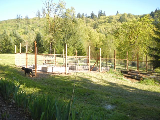

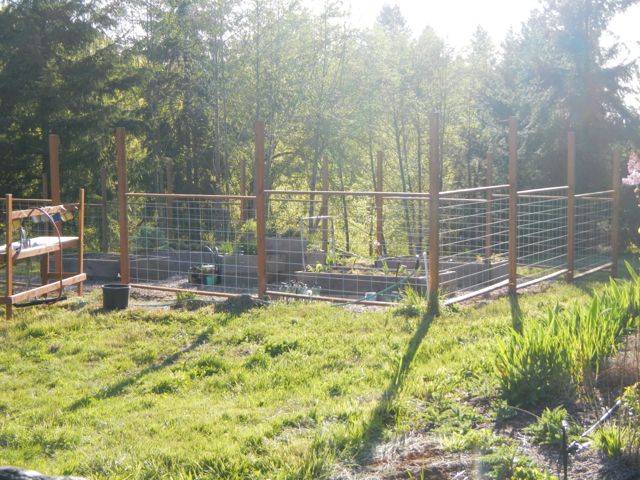

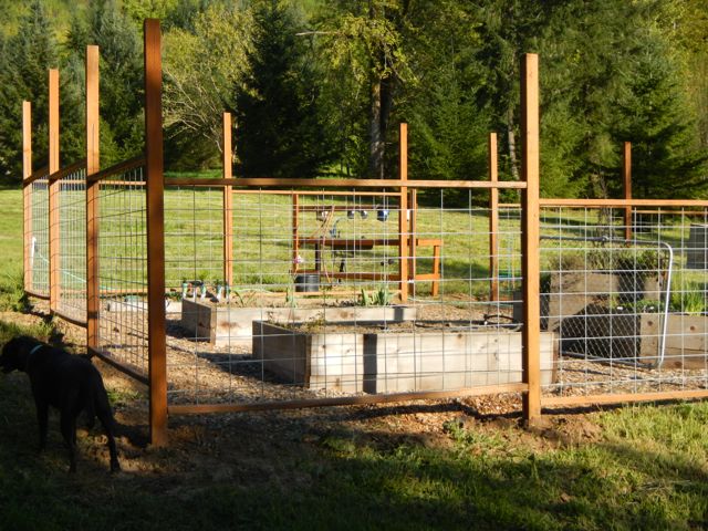

Thought I would show what the SFO and I have been up to this week, she got her "high end: garden fence. Basically pressure treated 2x4 and 4x4 posts with 4.5ft X8 ft galvanized 4 gauge cattle fence (from 4.5 ft x 16ft panels). We got our ebay turnbuckles and aircraft wire and will put up two top wires per the neigbors deer instructions.
Only downside is that the bottom 2x4 sags so we will be attaching it to the cattle wire (probably a lockscrew).
All in under 1500 so not too bad for 24X60 layout. I wish it had been for free but never that lucky.

We did the same thing around both of our gardens (mainly for the dogs) and built a dog run as well using the same method (except I used 2x6s instead of 2x4s). If you use fence stables to connect the panel at strategic points to the PT lumber, it keeps the PT from warping (as much) and helps with the stability of the entire structure.

I will get a closeup, but we dado'd the posts and the header and footer boards so the wire fence rides inside. I have two trashcans full of sawdust from that experience.

That fence looks really pretty Woodlandfarms, I'm curious what you are keeping out though. In my past gardens the main pests have been deer and rabbits. It looks like rabbits can go under or through your fence, and deer over it. No disrespect intended at all, I really like the clean look of it!
/ Garden Fence Project #8
My garden pest problems are turkeys, snowshoe hares, deer, raccoons, and moose.
The turkeys like to take dust baths in the dirt and tear up the plants flopping and scratching in there.
The bunnies and deer just chow down on everything.
The raccoons are the ban of any corn.
The moose are just random. They'll take a bite of this or that, but end up stomping on more than they eat.
No bear problems....yet.

Sorry I have not updated this. We are in the midst of a major home problem with a broken hot water tank that has taken out the kitchen to the beams. Its a mess, but I wanted to post some pictures of the "final" work.
As I said, we tried to do this as cheaply as possible, I handled the large projects (panels, posts) the wife did the detail work and arguably the harder work including the bunny fencing which was a nightmare.
The wife is tickled pink, I guess this is something she has wanted most of her adult life.
So these are some pix of the fencing. Master photo, how we dado'd everything, the top deer wire, and some of the bunny fencing and electrical and timers. Oh, the box at the end is the compost bin.
Here are the planter boxes, work table, garden and what we are using to water the corn and beans portion. And my Artichoke. Didn't think they would do well up here but this thing just keeps on givin and livin.
Happy to field any questions.

Oh, some things i have learned along the way... PT wood twists when drying. This has caused issues at the gates. You cannot have enough watering zones if you wife is a crazy control freak. We have a large control system that we initially thought was enough, but the wife continues to add zones.
