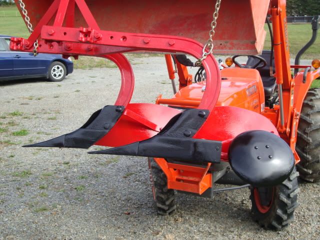

Welcome to TBN, it's nice to get some variety from the crusty ol' fellers.
Now, your 3700 will definitely handle a 2-bottom moldboard plow like the blue MF the guys found on E-bay. It should look like this one, if it had the coulters and landside wheel.
That one was $200 Cdn used, it needed a little work and some paint. It's a MF #62, 12 inch bottoms.
To decode some of that, the coulters are the round wheels in front of each "blade" or "bottom", and are designed to cleanly cut the sod as the plow turns it over. The landside wheel (at the lower rear) rests against the edge of the just-cut furrow and helps keep everything straight.
A 12-inch bottom means that the plow cuts a 12 inch wide furrow for each bottom it has. This one will plow a 24 inch wide swath on every pass, 2 furrows width. Common sizes are 10", 12", 14", 16".

I found a manual for the plow online after a bit of research, set-up was easier than I expected.

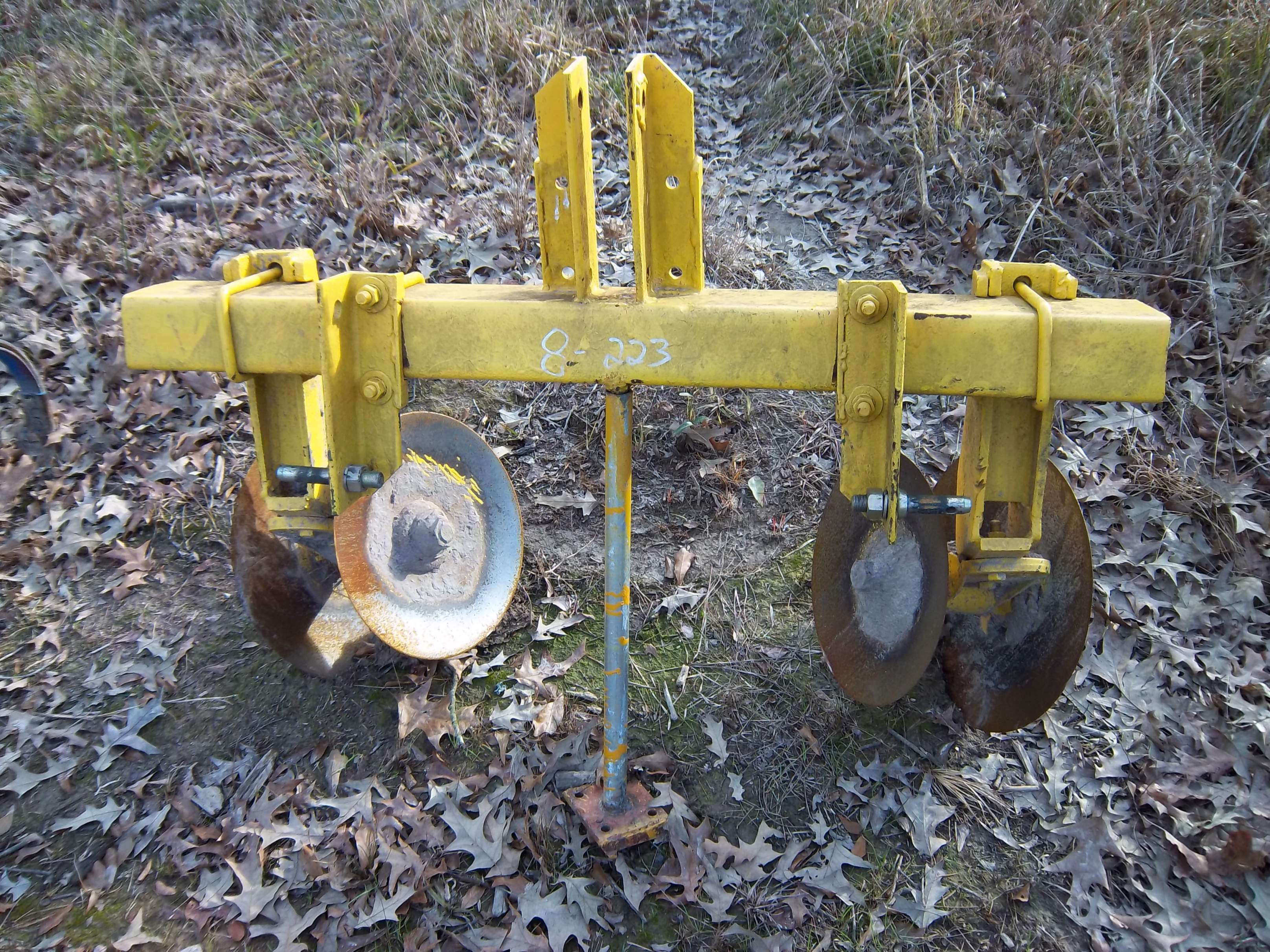

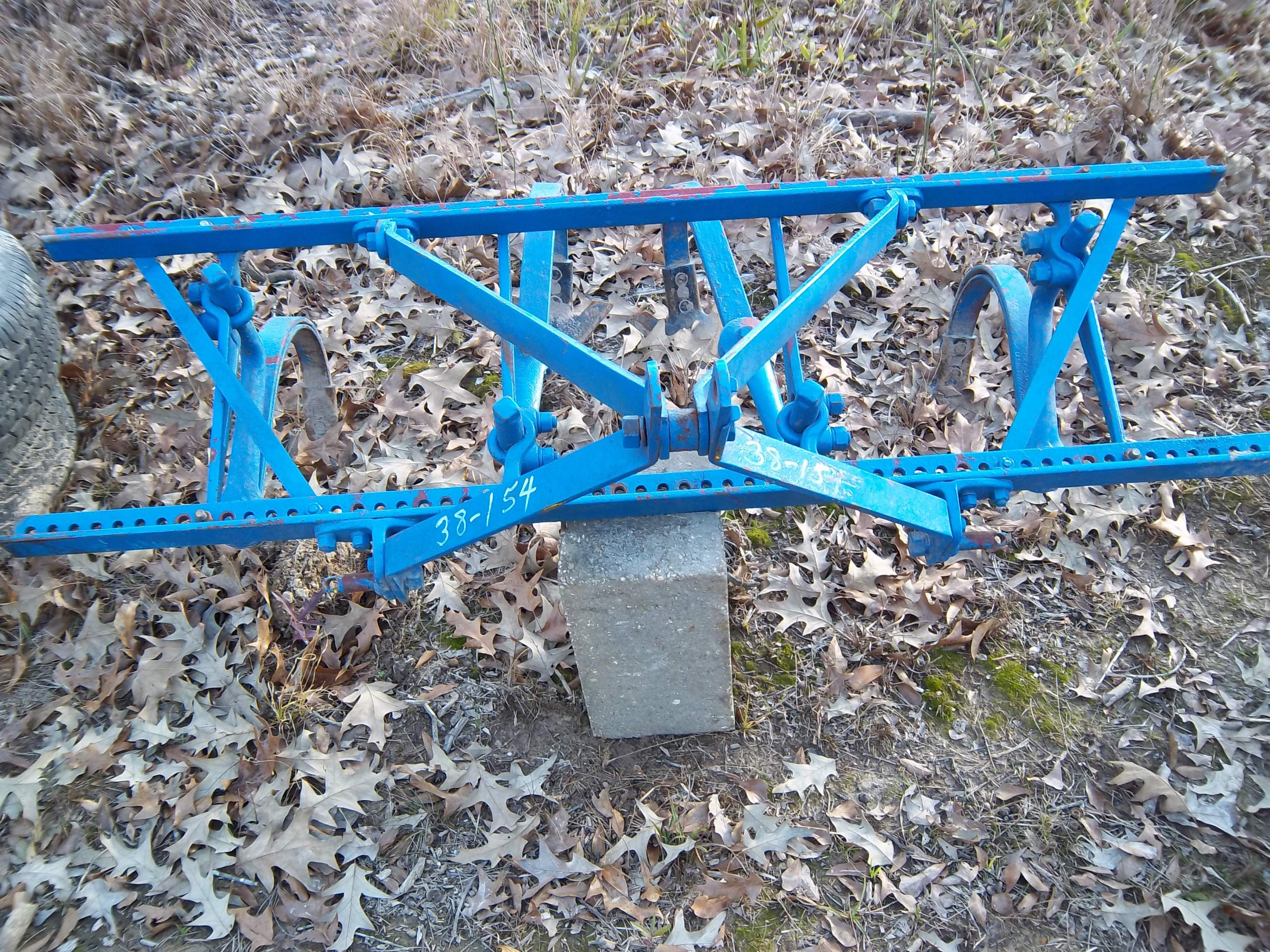

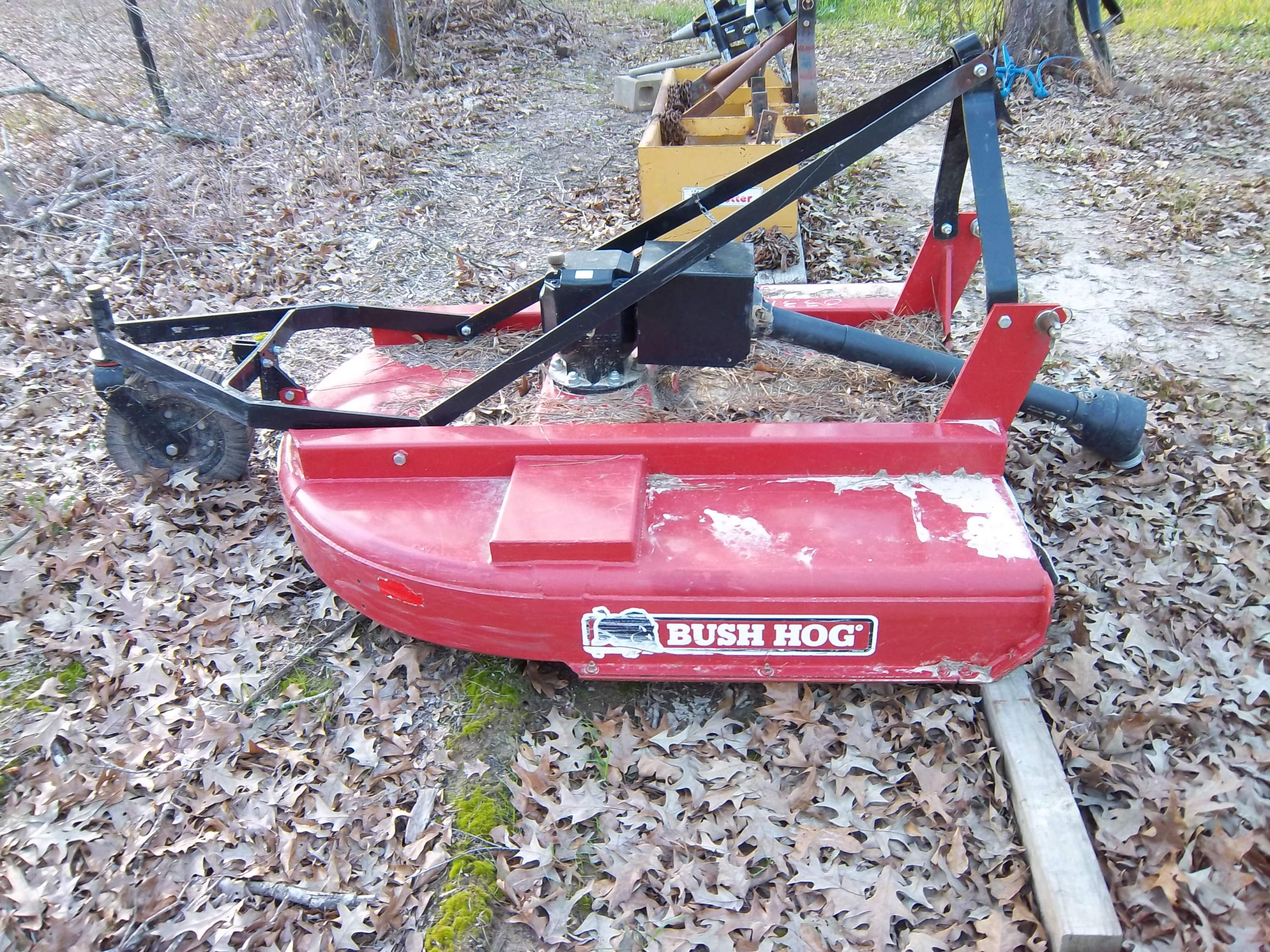

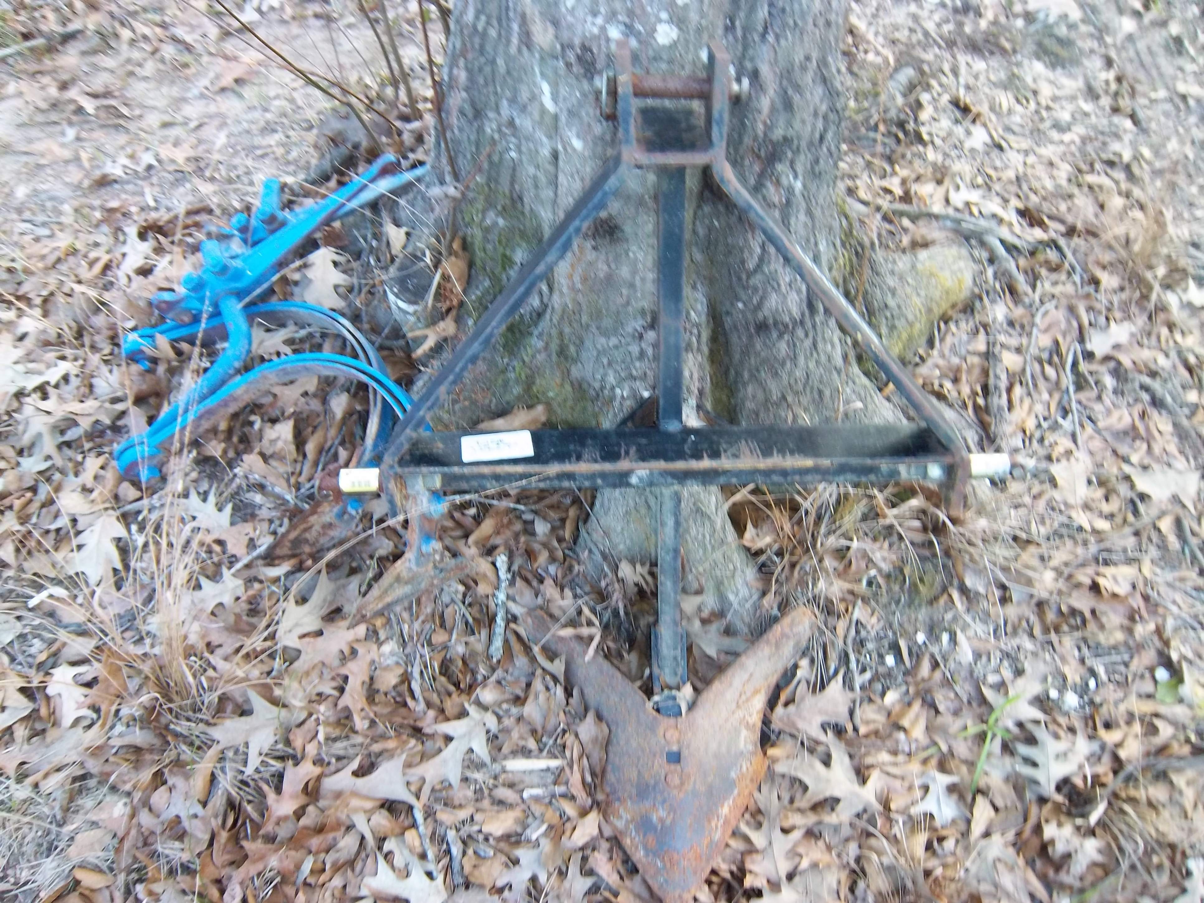

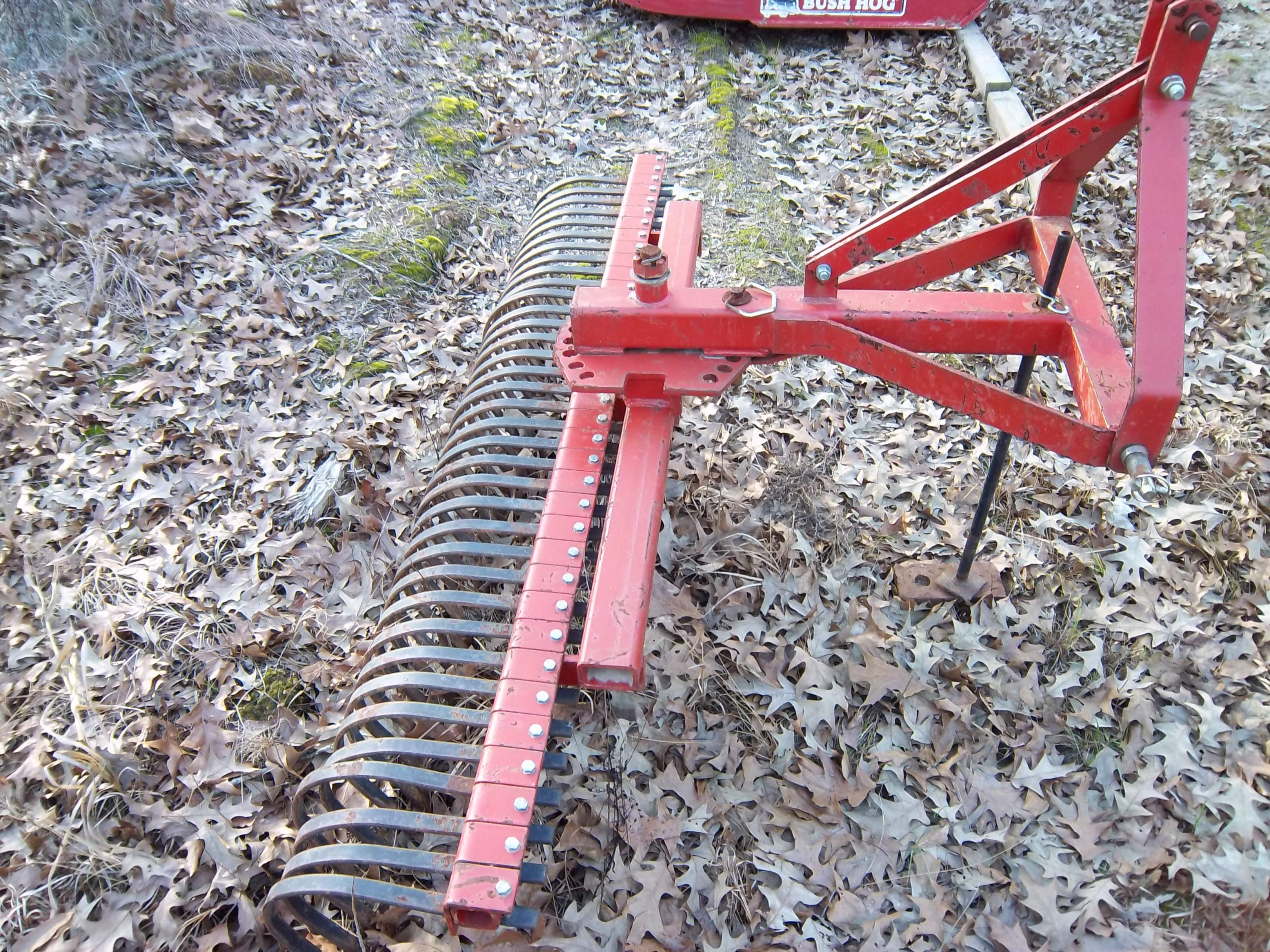

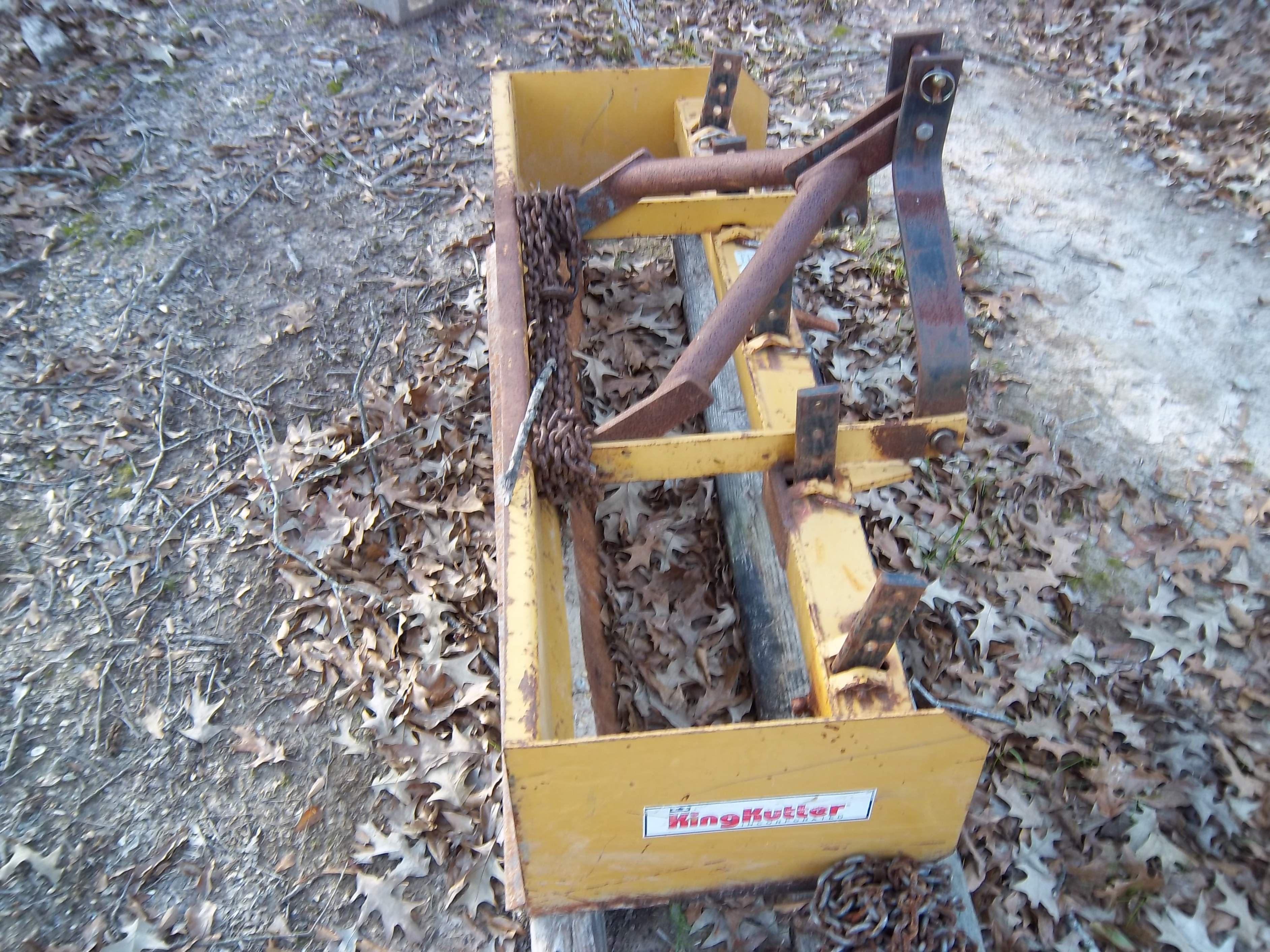

Ok, let me see if I can get you some pictures of tractor "attachments" AKA "implements".
1st. pic is a "middlebuster" AKA "potato plow"
2nd. pic is a "row hipper" AKA "row builder"
3rd. pic is a "disk harrow" AKA "gang disk"
4th. pic is a "cultivator"
5th. pic is a "Bush Hog" AKA "brush hog, brush cutter, rough cut mower, rotary cutter"
** Bush Hog is a name brand**
6th. pic is a "landscape rake" AKA "rock rake, root rake"
7th. pic is a "box blade" AKA "grader box"
I hope this helps and that the pics come out in order as I'm expecting...
