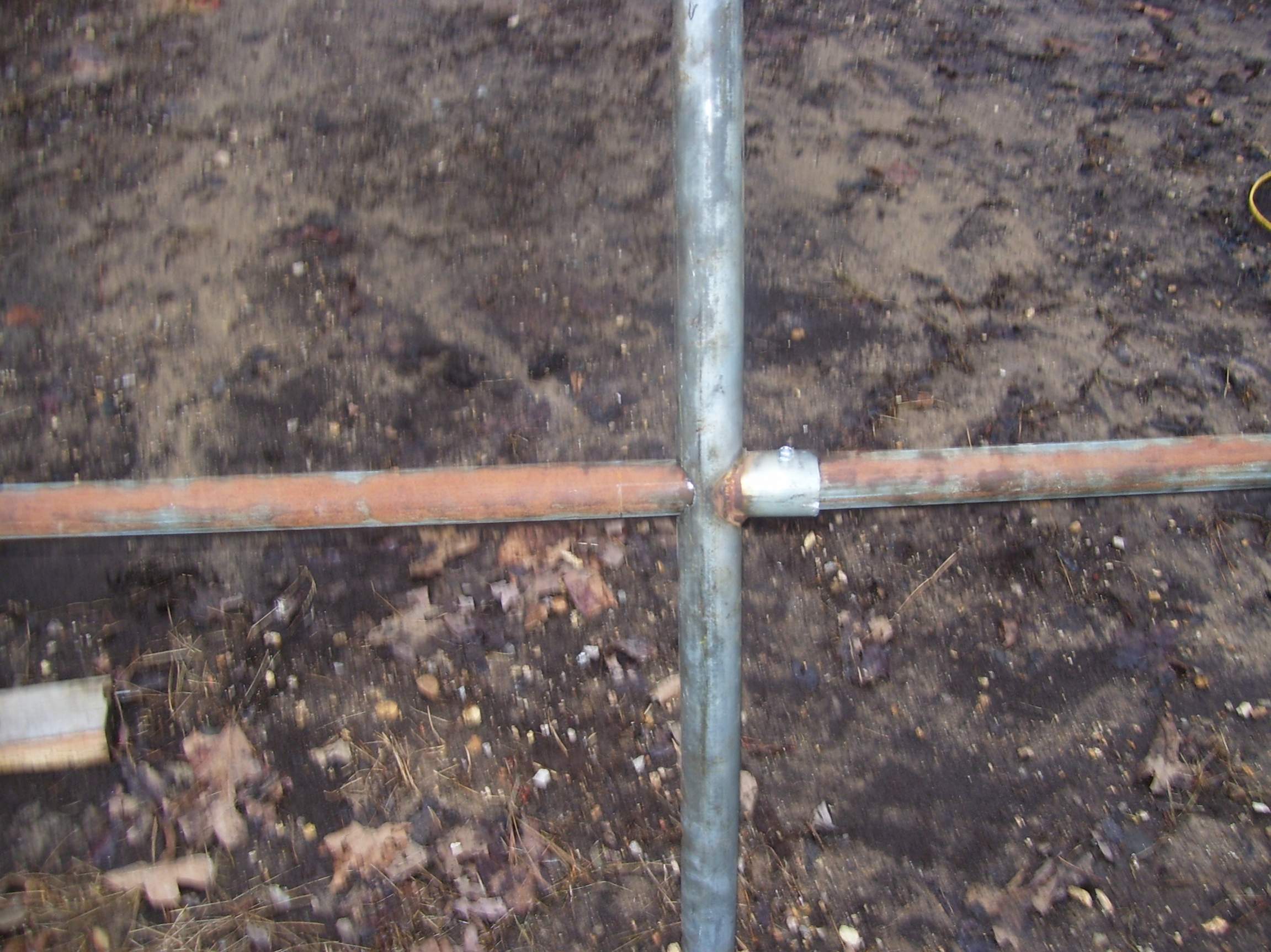

   / Garden shed greenhouse project #24
Heres a joint to show the notch in it

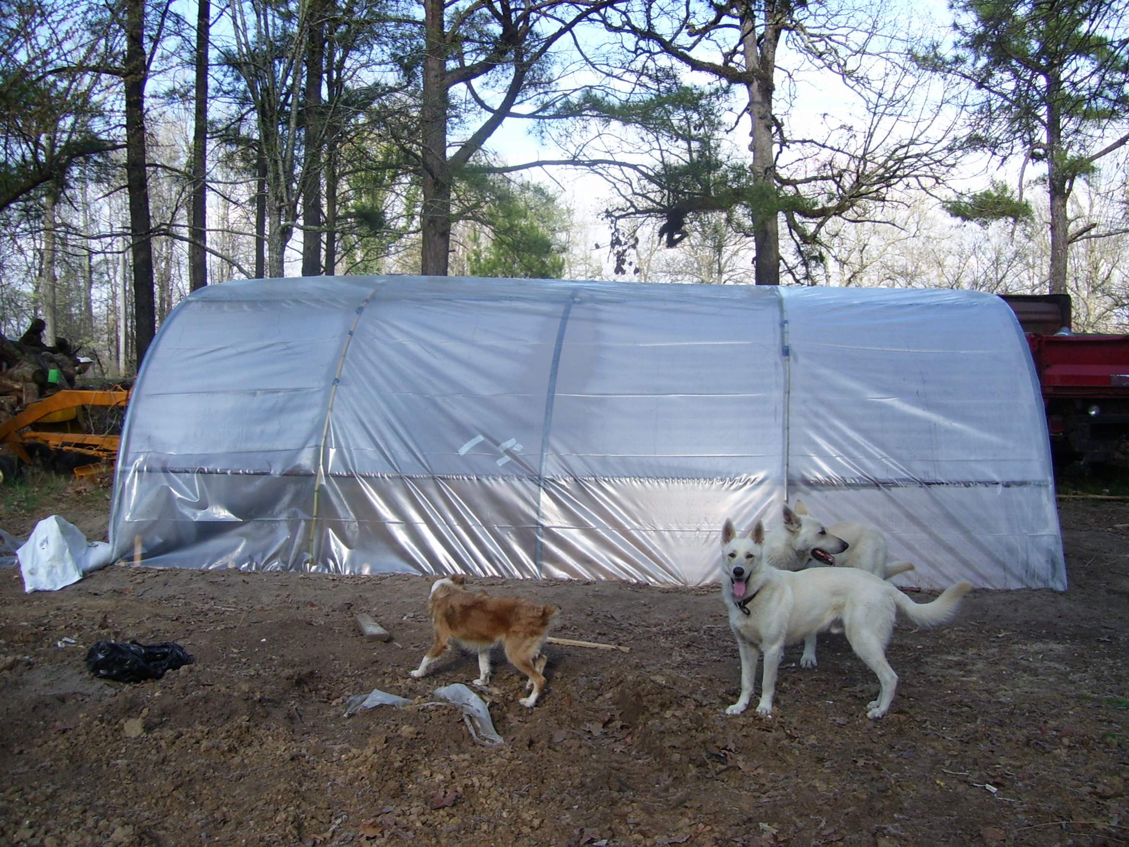

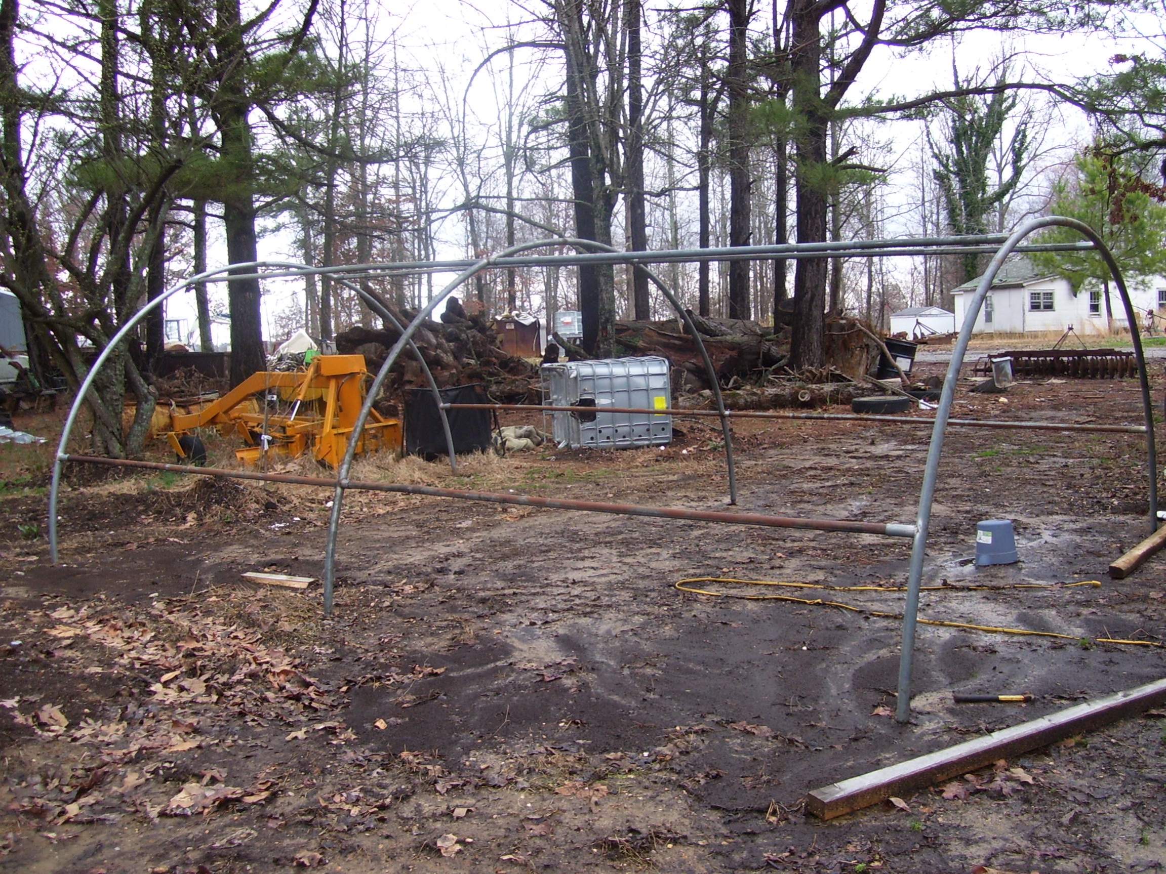

   / Garden shed greenhouse project #25
heres a side view My intermeidiate hoops were supposed to be pvc pipe but I had a plumbing emergency that took them up. I used some cane poles but the front one broke after I let the doorway get some slack and it got the 100 gallons of water on top. Im planning on tearing down the house across the road and making a 30 by 40 0r longer there in its spot with an underground heater.

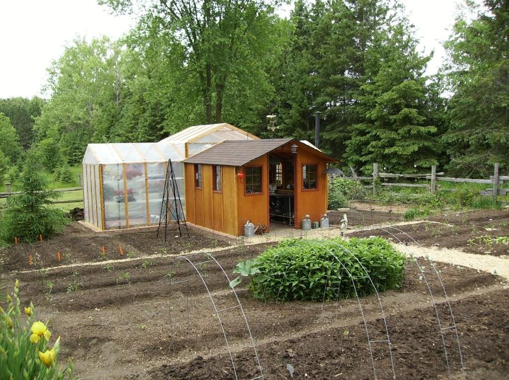

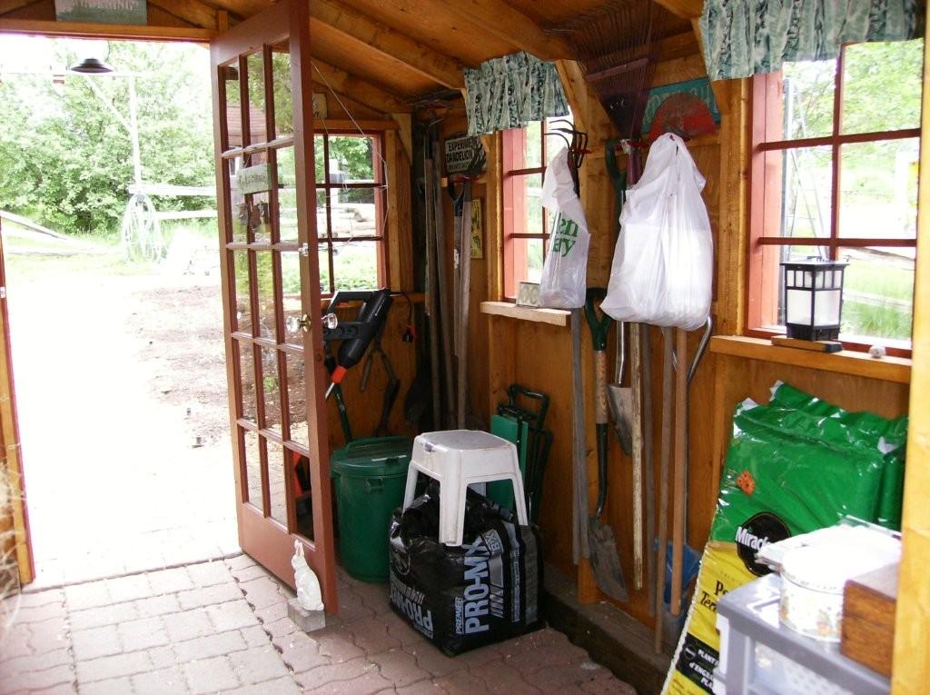

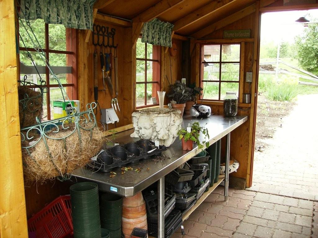

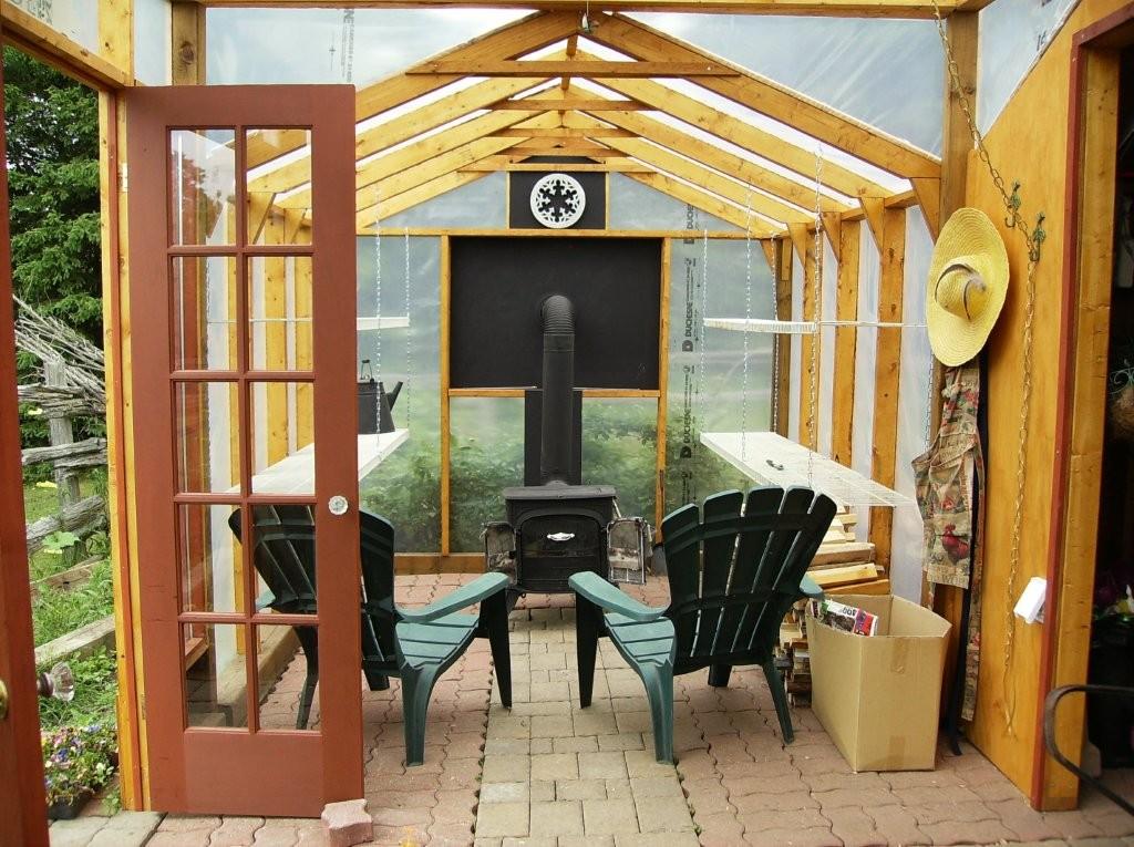

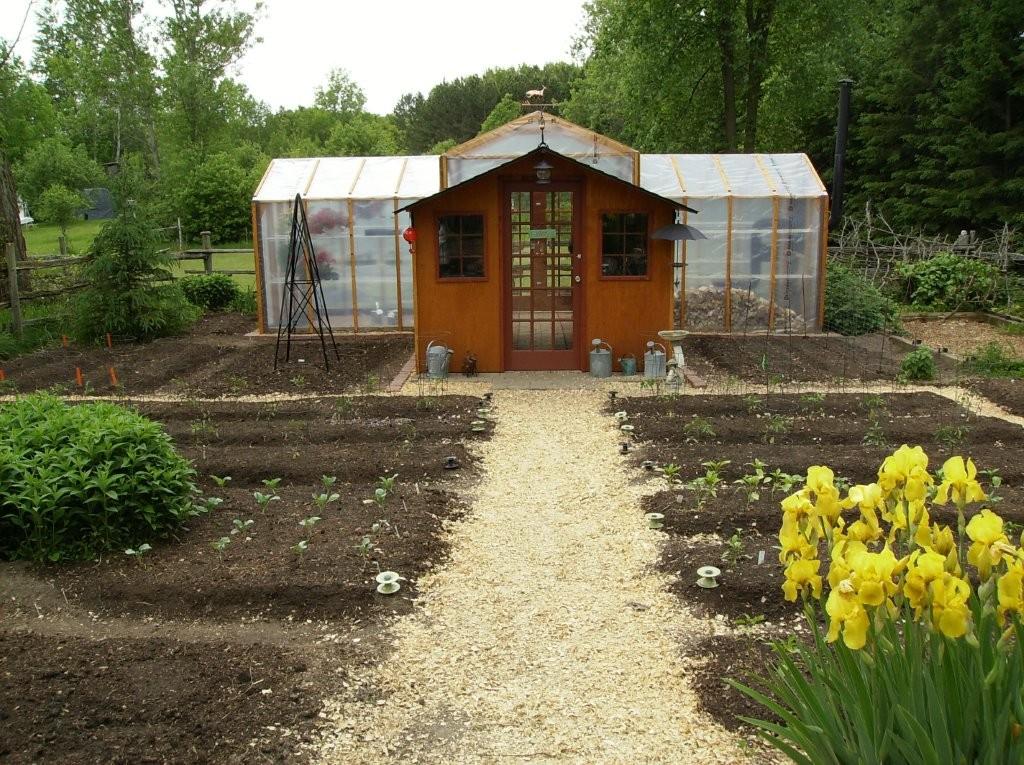

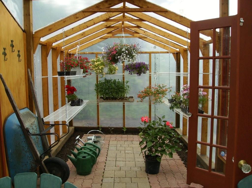

Another update
We're planted up now and the shed is almost done. We added window boxes today (no pics yet) and tomorrow I hope to trench a water line to it. The old greenhouse is torn down and the floor area has yet to be removed so I can plant my squash that are still in post. We had a couple of heavy storms and everything seems leakproof and wind safe glad to report. Had to beef up the fence with a few wires to keep the darned dogs out too.
I think some of the advice about ventilation is spot on as even with the doors open it's getting really hot inside. I'm investigation the differences between temperature activated window openers vs a fan on a thermostat.
Next we'll mulch it all with well rotted manure and then, EAT!

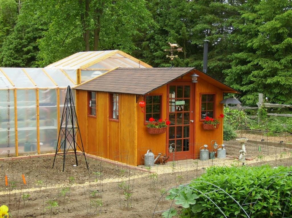

One more with the front window baskets
