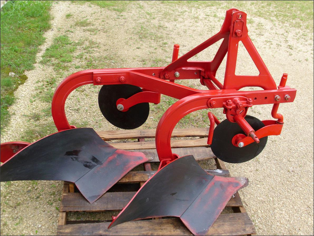

Good old fashion plow will usually work fine on fairly hard ground like old pasture etc. as a first step, but you may still have rocks, tree roots etc. to deal with before rotor-tilling.
Nice photo of someone else's Dearborn plow:

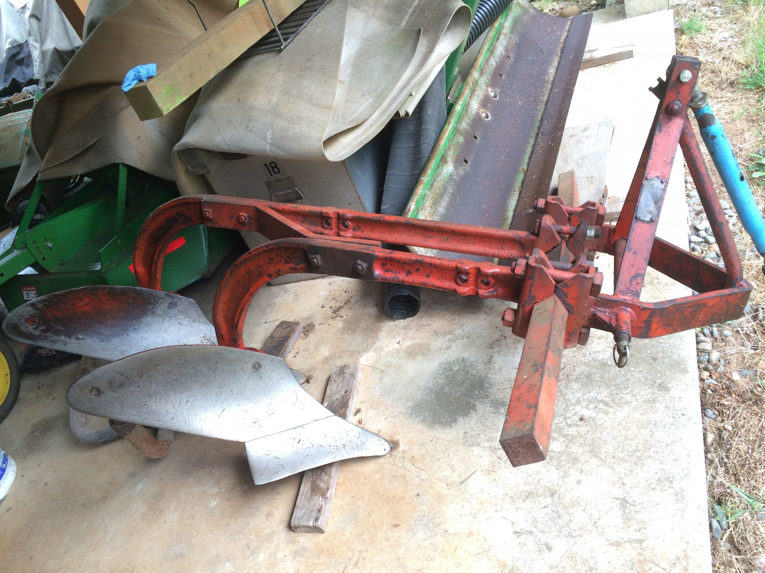

My old Towner is not fancy and never had coulters, but it works fine!
