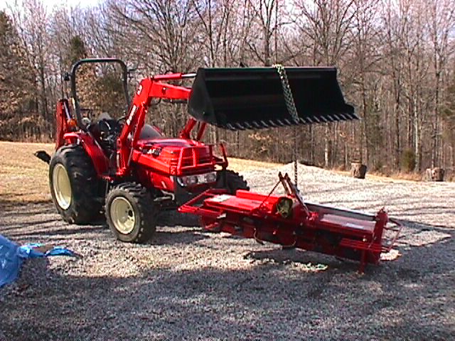

OK, so I think my wife is going to forbid me going to my tractor dealer anymore. She just smiles when I drag something home, as she knows she has just another bit of leverage for spending money on her passion. And my dealer is so sneaky too, he sure knows how to tempt me...and before I know it....here I come with another implement. Well, I am only having fun with this. One reason I went with Branson, is I could get a good tractor, and save enough money over other brands that could be put to use with buying implements... which is really how you put that tractor into use. I am anxious to put this new tiller to use....but my first impression is that it is not commercial/industrial...but should be plenty good for my use. Also, it has a handy side shift feature, so I can move to one side and cover my tire track on one side. Anyway, good or bad... I guess I now own it. Here's a look at the branson and tiller meeting for the first time.

Very nice! I tilled our garden yesterday. Just some rototilling thoughts....
The Branson's don't have a true crawl range, so you'll have to take shallow cuts and make a couple of passes. If you bury it all the way down on the first pass it's tough on things and probably won't work that well. This is true of all tractors unless they have a super low crawl speed like you see on a lot of the gray market machines that are built for tilling.
With a 4020, you might be able to bring the engine speed down to about 1350 and run the PTO in the higher speed. You will result in 540 in the back but your ground speed will be much slower. Of course an engine makes much less power at 1350 so it may not pull it, depending on your soil.
