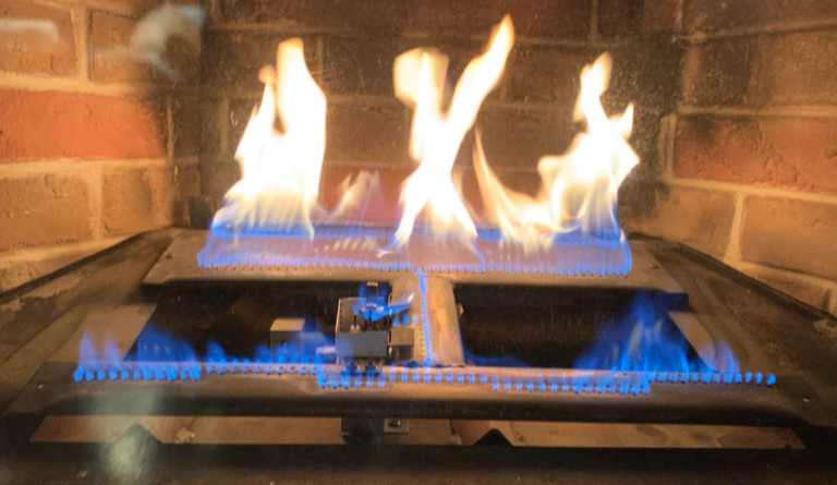

We have a 10 year old gas fireplace, propane. The front burner has very low blue flames but the back burner has nice natural flame look. This morning, the front burner did not even come on at all. Shut it down and restarted. Small front blue flames returned.
Is this just needing a good cleaning? Would just using an air compressor clear the front burner?

Three most likly problems in this order.
1 Clogged orifice
2 Cobb/spider web in airway
3 Burner filled with ash IF a log has ever been burned.
The air hose should fix them all.

BEFORE using any type of air compressor - use a good shop vac. That is, unless, you want ash blown all over the house.
   / Gas fireplace cleaning #11
A brass wire brush works well on the burner offices. If they are really bad a Proper Sized Drill Bit may have to be used to clear the office.

I'm back. I cleaned the burners. I removed the two orfaces and cleaned them. Cleaned the piolet as well. I did a test fire with out the logs. Front flame is better but I'd think it should be better.

front burner is burning as it was designed to burn. It's not designed to burn as much as the rear burner.
The rear is the one designed to give that yellow flame, and burn more gas than the front
