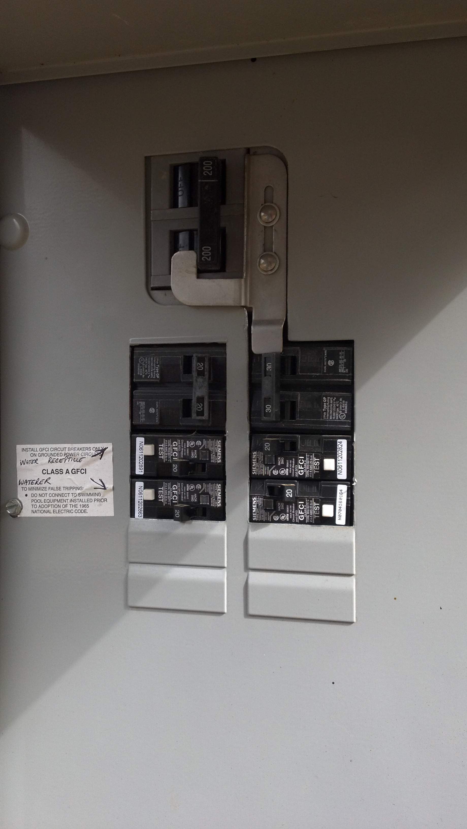

Correct me if I'm wrong, but wouldn't it be best practice to size the backfeed breaker to be at least as large as the generator is capable of serving? I guess it's not a safety issue if it's under-sized--you'll just pop the panel breaker before you pop the generator's breaker--but I would hate to have the panel breaker be the limiting factor if I had generator capacity to spare.
Howdy,
The interlock kit lets you use the circuit breaker of your choosing. If you have a smaller generator, you would have a dual pole 30amp breaker. If you had a larger generator, you could have a dual pole 50amp breaker. Here is a interlock with dual pole 30amp breaker for the generator
interlock.jpg All I am saying is, the physical location of the breakers in your panel allow you to use what is needed for your specific generator, and then you still have to use your head on what items you can run. But, at least you have your whole panel to select from. That is why the generator breakout panel is so limiting.
