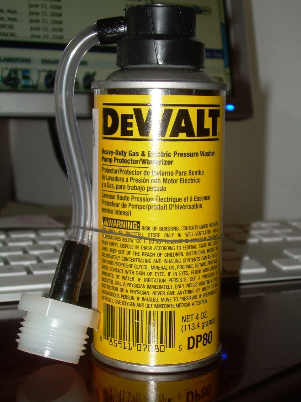

If you buy used, be very careful as it's easy to damage the pump and that's very expensive. For instance, the water should not be shut off for more than thirty seconds or the pump will overheat.
Also it's not good enough to manually empty the pump before the water freezes. You have to add antifreeze using special aerosol cans.

What is this aerosol antifreeze? Everyone I know just runs RV or some other kind of antifreeze through the unit and calls it good. Just like they do with spraying equipment...

I think draining the pump would be a good idea. Running something like this through it after getting the water out is what I was talking about.

Here is what I plan to use (from Home Depot):

I'd forgotten that part. Yes, disconnect the hoses and with the spark plug wire off (so it won't start) pull the starter cord about six times to mostly empty the pump.
Then take your aerosol can and screw the extension plug into the pump inlet. Depress the aerosol button until the fluid begins to exit.
I use a 6" 4oz can of Briggs&Stratton 'pressure washer pump saver' I got it at either home depot or Lowes in the pressure pump section of the store.

I've not seen that but it certainly looks handy. Using common antifreeze or RV antifreeze was the advice I got from the local farmers who keep a lot of equipment in unheated buildings.
