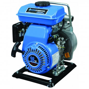

I bought a HF 98cc 1" water pump but I no longer see it listed. Not sure if they stopped carrying it or if they just are out of stock. I got it for $100 with the 20% off coupon. It's very quiet and I can fill a 275 gallon IBC tote in about 5 minutes, maybe 20' to 25' total lift. It's nice and small but with plenty of power. Maybe the 79cc pump replaces it. I like it because I can easily carry it with one hand.
