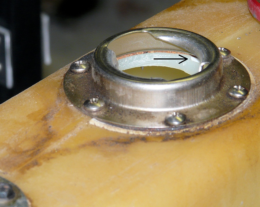

My gas tank leaked also. Below is a picture of the cause and the remedy.
Cork is factory gasket, white is my 1/2 gasket. I first tried tightening screws, but soon realized that wasn't the problem. The seam between the 2 halves of the tank is very poor, causing one side to be higher than the other by approx. 1/32". If you look at the arrow in the picture, the white part is the 1/2 round gasket I placed under the factory full gasket and steel ring. The difference in height was much too great for the single gasket to seal. My first thought was to shave off the excessive material, but I determined that was too difficult to do and decided to just fill up the space. It was easier and it worked, gas has not leaked out since the fix and I fill it to within 1" of the top of the tank.

What type of material did you use for your 1/2 gasket? It does look the same as my problem I am having.
Thanks
