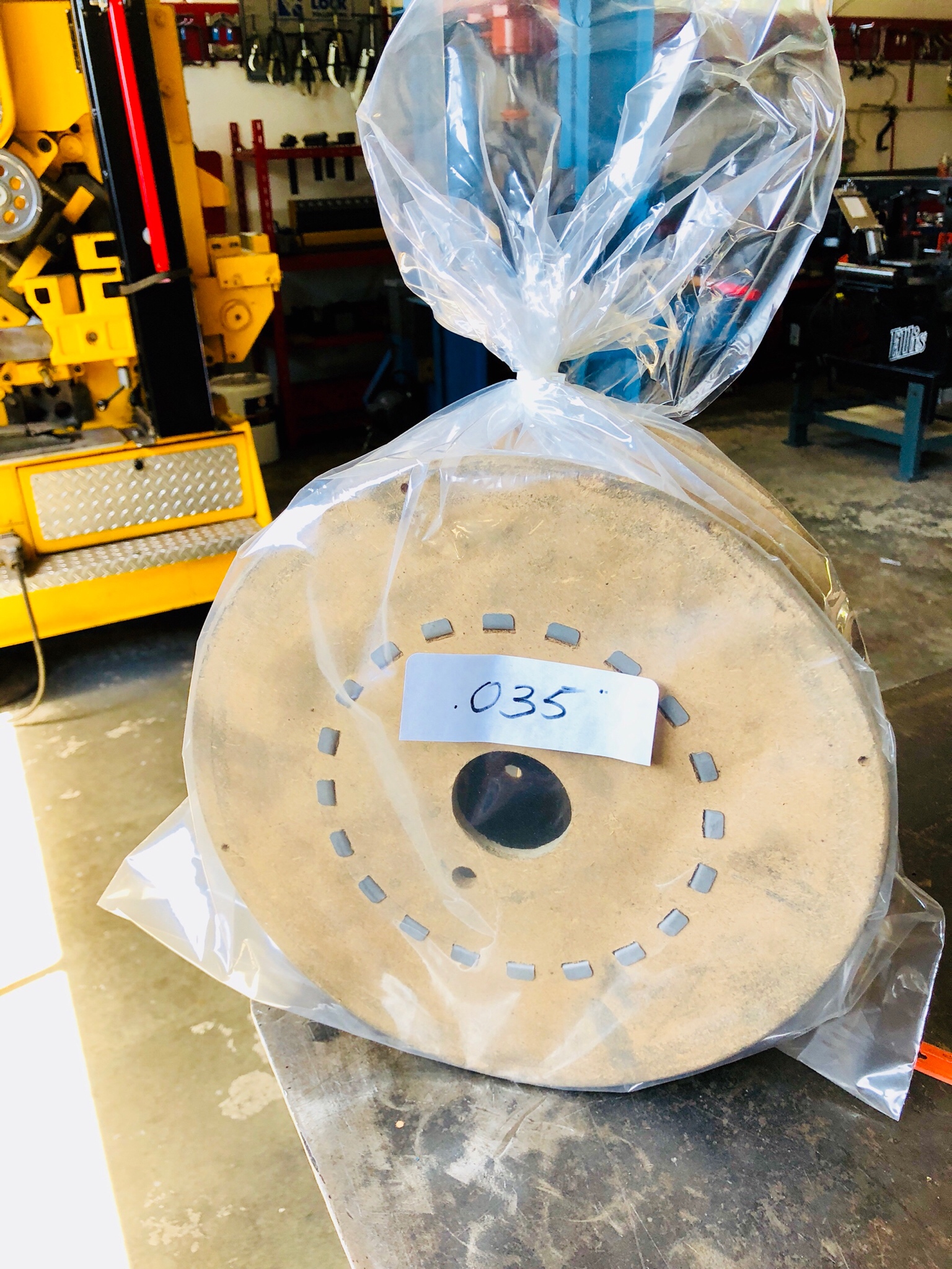

At the the big box stores you can get a roll of thin plastic on a cardboard core. It's used for shrink wrapping anything. 4" wide and about a mile of plastic wrap on it. ( Or Glad Wrap works too ) I used to throw a desiccant pouch in the spool and wrap it up with the plastic wrap and tape it shut. Keeps rust out and preserves the quality of the cored wires which I seldom ever used. Also used to use a foodsaver vacuum sealer.
   / Gasless MIG question #15
Here’s a pic of the pallet wrap yomax mentioned.
This plastic cover for my bench feeder helps keep the wire relatively dust free.
I use a heavy ply plastic bag for part rolls in storage.
