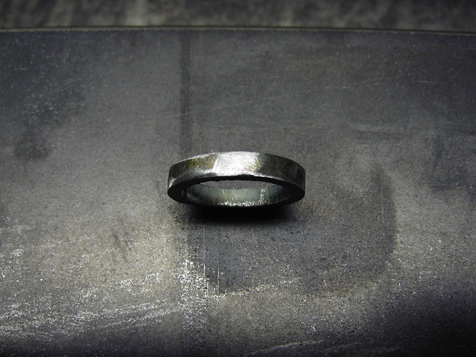

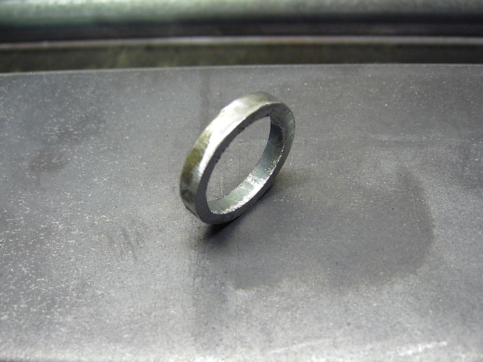

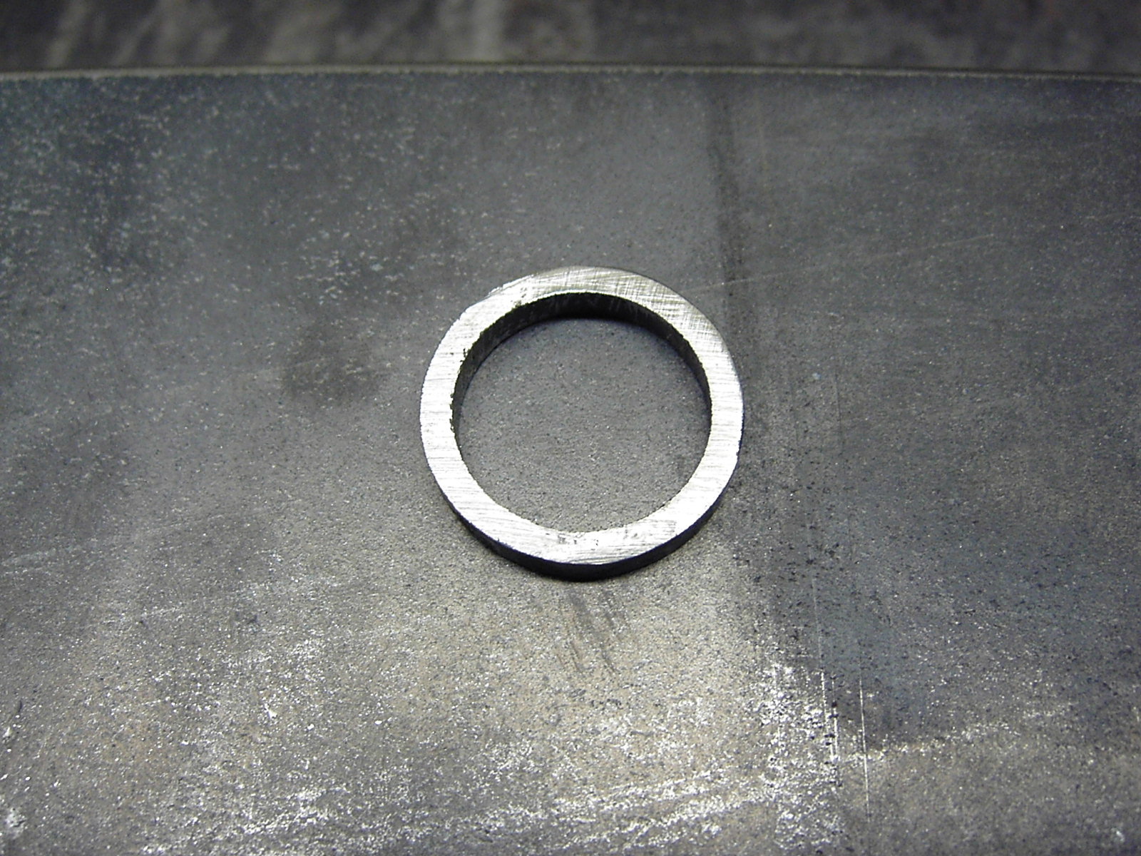

Those gator blades sound tempting. Can someone post pictures of the bushings that you need to adapt them to the BX deck?

Tdog,
Here are some pics of the bushings I used. I made mine out of a piece of Cat1 x Cat 2 bushing stock. I bought the stock at TSC. They measure 7/8 ID x 1 1/8 OD x the thickness of the blade. I just tapped them on the blades with a small hammer.
Bill
