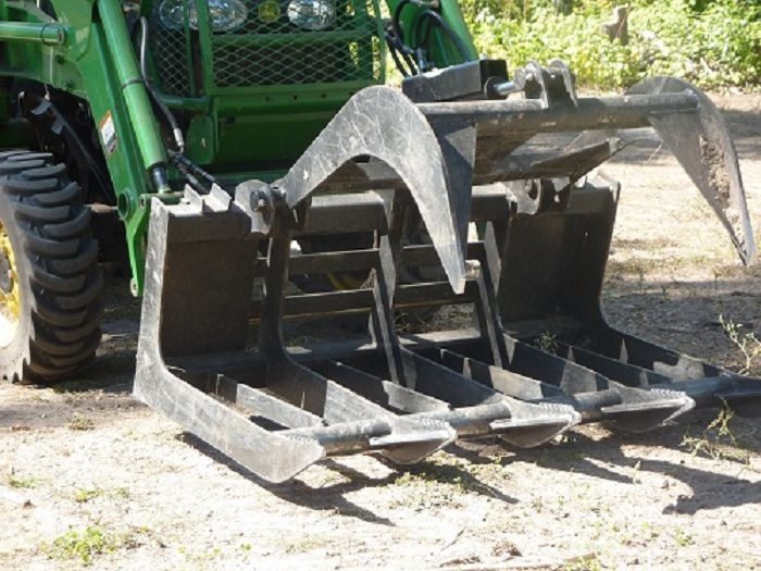

I added two 1/4 x 2" steel bars to the rear of my grapple to help protect my JD tractor. Without 'em there is this huge void which alllows branches to pass thorugh and gettcha in the grille or hyraulic lines, etc. :(
I dont think tractors with SS mounts have this same issue (?)......but with JD mounts your tracgtor is vulnerable to damage. Thought some other JD guys may want to see the improvement. Easy and affordable improvement. :thumbsup:

Nice mod...there sure is a large hole back there!
   / Gator Grapple Guards for JD QA Mounts #3
Well done, looks good! :thumbsup:

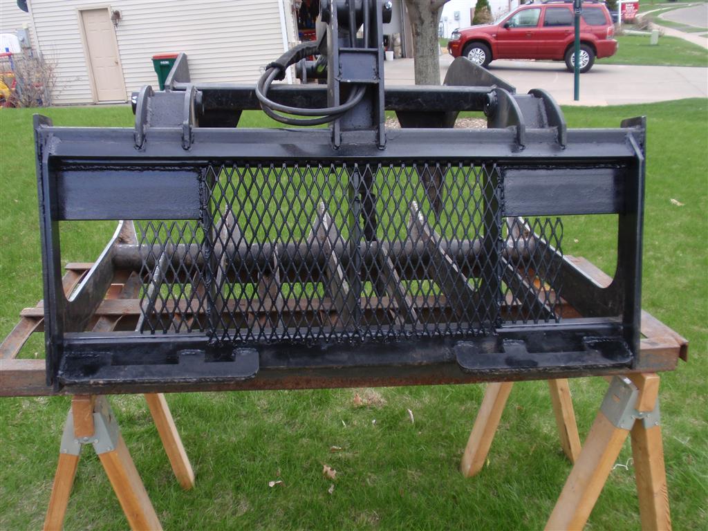

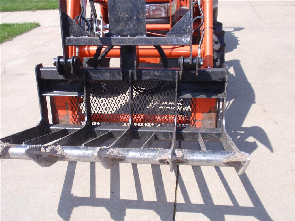

Here is the mod I did to mine earlier this summer. I have the SSQA, and it still had the same problem. It's awesome now. Nothing gets through.
attachment.php
attachment.php
The large bars just under the point where the jaw pivots mount was some 3/8" angle I welded in at the same time to fix Gator's design defect when used on a Kubota SSQA. Now the grapple doesn't randomly pop off when used hard.
