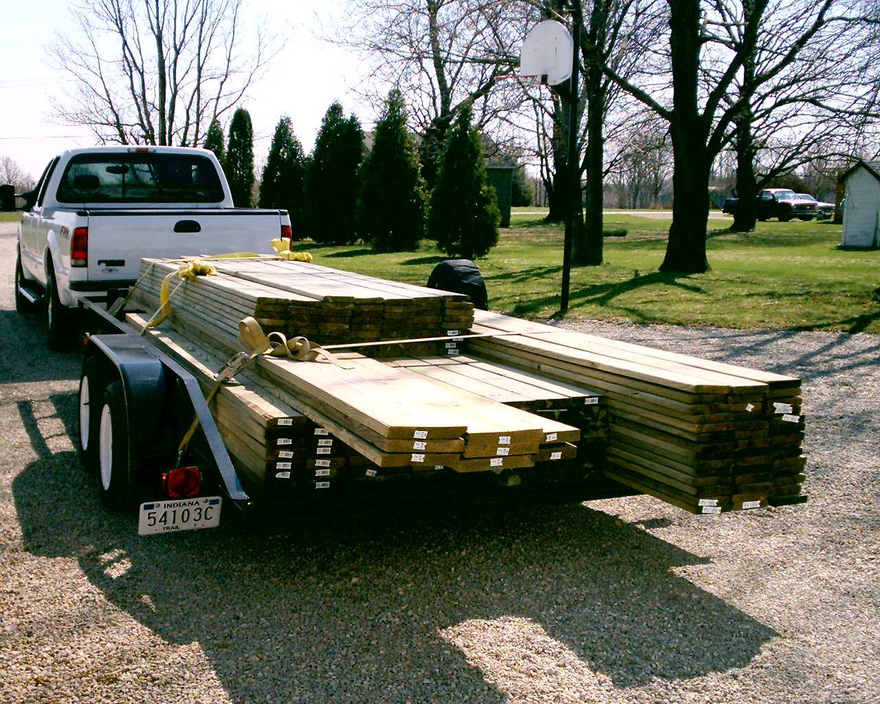

I bought mine new in 2004, a 18' x 82" wide, utility trailer with a used 15" 205-75-15 wheels and tires, a spare, and 5' long ramps for $860 out the door and some of that was a delivery fee to get it closer to my house. I think it was $820 without the delivery. It has 2 welded on safety chains that are properly sized and a 8K coupler. Its painted entirely, including the wood deck. I just had to replace the tires last year due to dry rot. Never had a flat except for a nail I picked up at a lumber yard. It hauled many cars and SUV's with those tires making 3 trips to Chicago, 1 to Detroit, and multiple back and forth to the lake and my dads house about 150 miles round trip.
Chris
