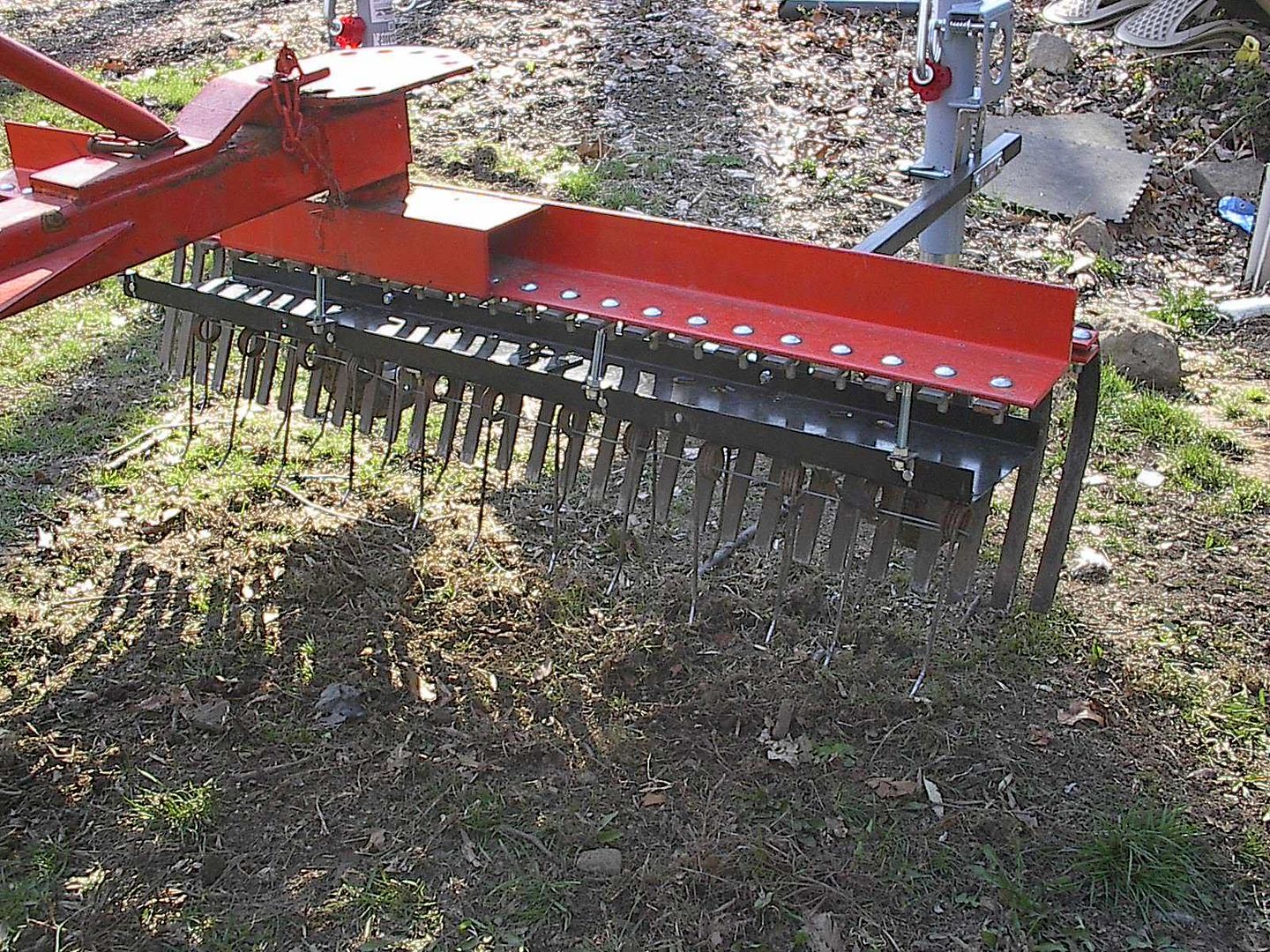

Hi all,
My property has mature trees on it, during the Winter they'll drop their dead branches and, of course, come Spring time they have to be cleaned up. But in the Spring, because the ground is still somewhat wet, the tines of a regular landscape rake can be a little rough on the grass. And, for me a dethatcher type of rake just wasn't doing what I wanted; so I combined the two.

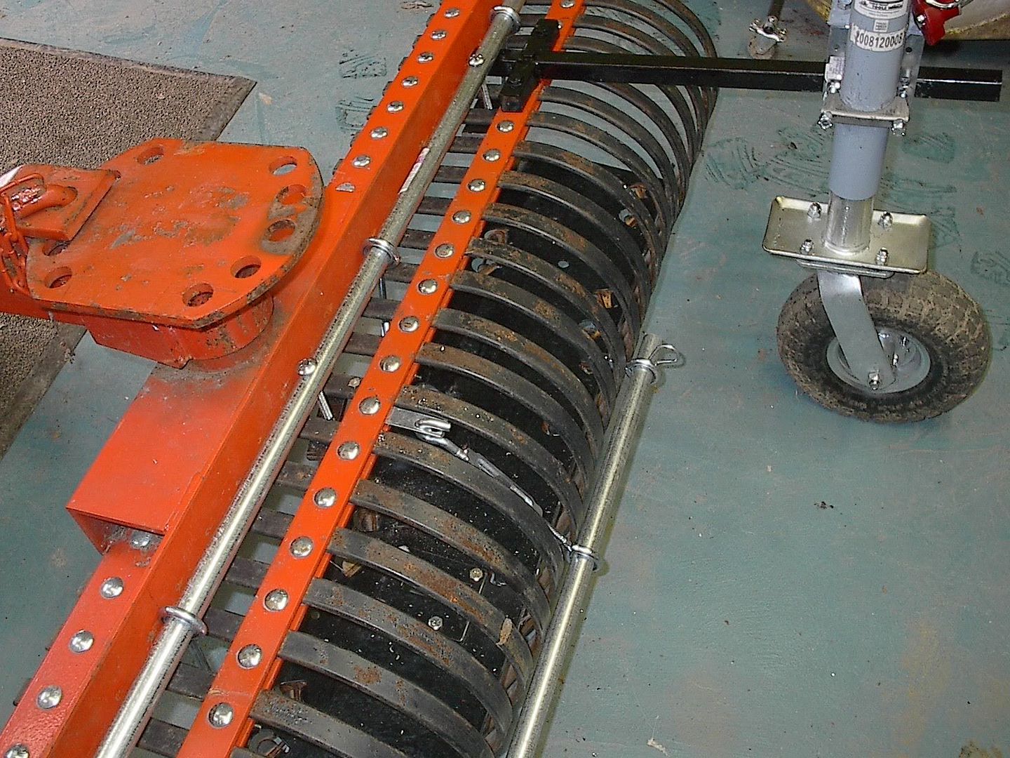

The dethatcher with it's thin tines is easier on the grass, gets the smaller twigs and dethatches. The bigger landscape rake gets the heavier branches, provides a weight to keep the smaller tined rake down, and allows me to raise and lower both of them via the 3pt.

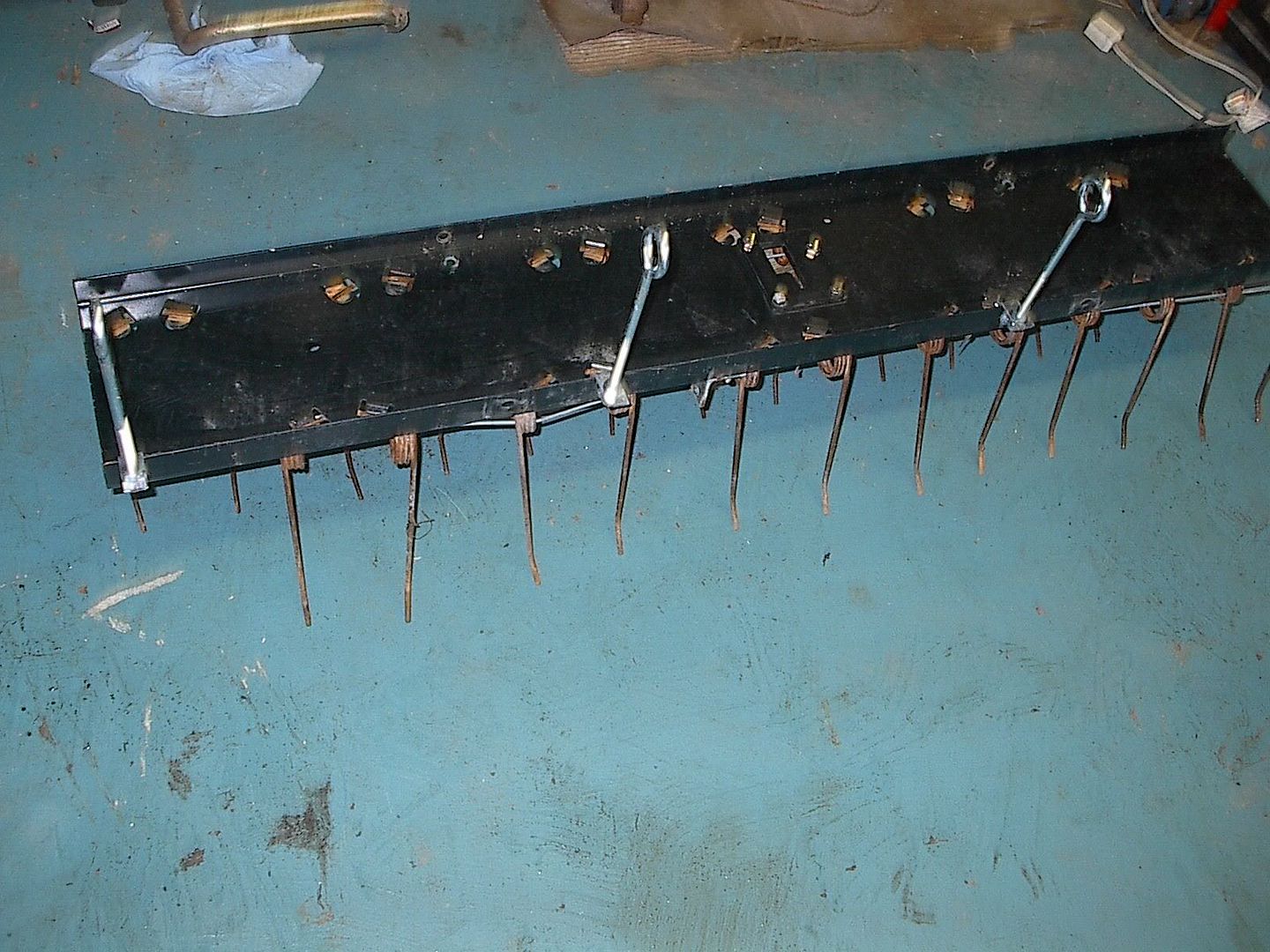

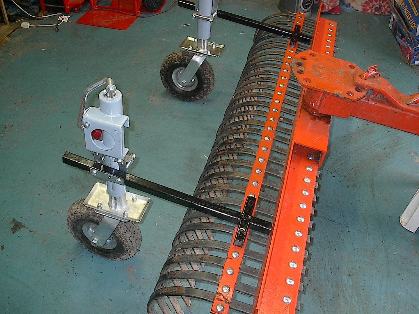

I was going to try and build my own thin tined rake, but after checking prices, availability, and of course, "shipping & handling", I bought a 4' AgriFab, used just the tine portion, and attached it to my landscape rake. The gauge wheels keep the larger rake about 1 1/2" higher than the smaller tined rake, and the smaller rake's height can be adjusted via a turnbuckle.
The weather recently was nice enough to enable me to try out my new combo-rake, and it worked great. Only downside, was having to get off and on the tractor to clean out the tines; but after hibernating all Winter, needed the exercise. An upside was I happened to rake over an area that was devoid of grass, and the dethatcher tines opened up some fine lines that are going to be perfect for planting grass seed. Pictues attached.

Thanks for posting this - it's giving me some ideas for cleaning up my yard, which sounds similar. It's also got me thinking about making gauge wheels for my rake, rather than buying the very-expensive ones through the manufacturer.
   / gauge wheels/dethatcher/"twig catcher" #3
Interesting. That'll do the job.
I just finished using my landscape rake to pull stones and dirt out of the yard due to the snow plows.... for the second time this year. I need something a little finer so it grabs all the rocks. A lot get through. Your setup is great for sticks, but you didn't happen to come across anything closer together in your research, did you?

Great Job, thanks for sharing, I too didnt want to use the landscape rake alone w/ fear of ripping out to much.
   / gauge wheels/dethatcher/"twig catcher" #6
Good one. I have the same issue. I have the same dethatcher but not the landscape rake yet. Other that the weight do you find the landscape to help in holding the sticks?
   / gauge wheels/dethatcher/"twig catcher" #7
I have found that if I set my rake slightly high that I will eventually build up a pile of debris in front (I have mine mounted on FEL going forwards). The debris pile being pushed ahead of the rake is good at collecting both small and large branches but also tends to slide over the grass rather than dig into it like the rake likes to do.

The gauge wheels were made from Harbor Freight parts, trailor jacks & wheels. The idea for these type of gauge wheels is not mine. Thanks to the other members of TBN for their postings over the years.
Airic:
Yes, having the larger rake definitely helps in dragging the larger debris. And as I mentioned, having it on the 3pt allows me to easily raise & lower for cleaning out the debris.
amigauser:
Yep, saw that rake, too. But, when I found out the price, I reverted to "...there's gotta be another way". During these economic times, "cheap" is a good word.
Freds:'
Other than the "pine straw rake", didn't come across anything else. And I can sort of identify with what you're saying about smaller stones. When we have some really bad thunderstorms, water washes across the driveway and deposits our parking pad shell all over the place, which means sweeping by hand. Kicking around an idea of maybe fastening a piece of hard rubber, like what's used in horse stalls, or maybe a piece of old fire hose to the bottom of the rake and drag it like a blade.
