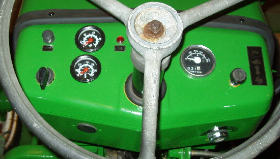

This is a picture of the gauges on my YM1500...hope it helps at all.
Peter
   / Gauges for 1602D #6
That first was the oil sender with "T" fitting to allow continued use of the warning/idiot light for back-up safety.
This is the gauges in the dash.
I don't have one of the temp gauge but can send it if needed. The temp was the easiest..it just screwed in with a metric adapter (avail from SUnpro).

The paint job came out well after a lot of help from people on this forum. The worst part of the paint is actually the dash. I couldn't remove it and paint it well since I couldn't loosen the nut on top of the steering wheel. I ended up getting some sags and a little orange peel...but I am happy overall. Most importantly my WIFE is happy. She usually drives it for the mowing. ANd thanks for the filters/some parts/repair manual I bought from you!
