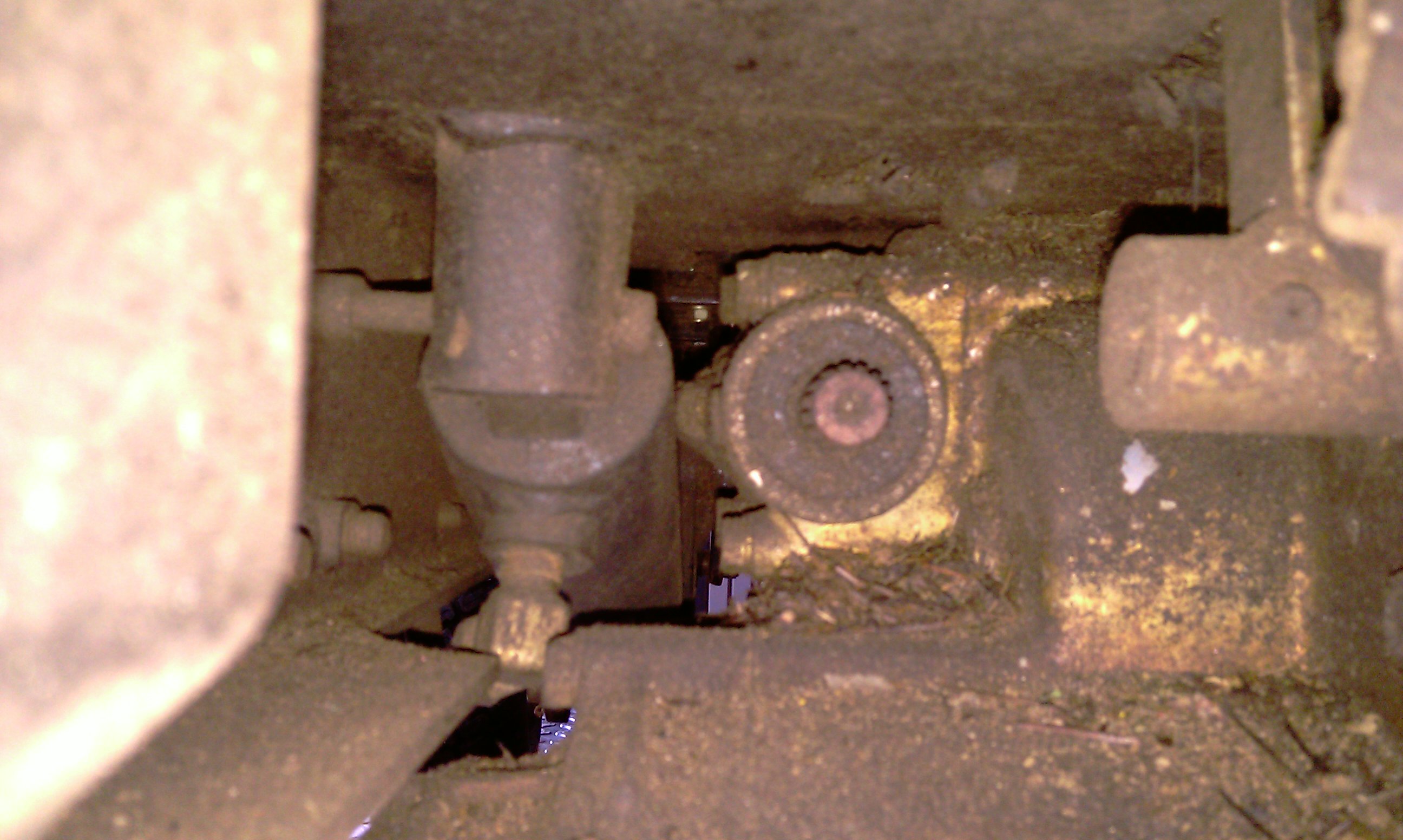

Can't do the belt drive on the small tractors, unless you want to use the front PTO and drive the pump off of that. They're so fragile, there's no point.
Also can't attach the pump directly to the front balancer (no room). Only way to do it is to use the front PTO shaft (the front PTO itself is electric with clutches) and drive a pump where the PTO was located.
Problem is, if you don't have the front PTO shaft, they run almost $400 new! I bought an entire parts tractor, with a 3 point, rear pto, and BM48 mower (the best they came with) for just a few bucks more than that.
