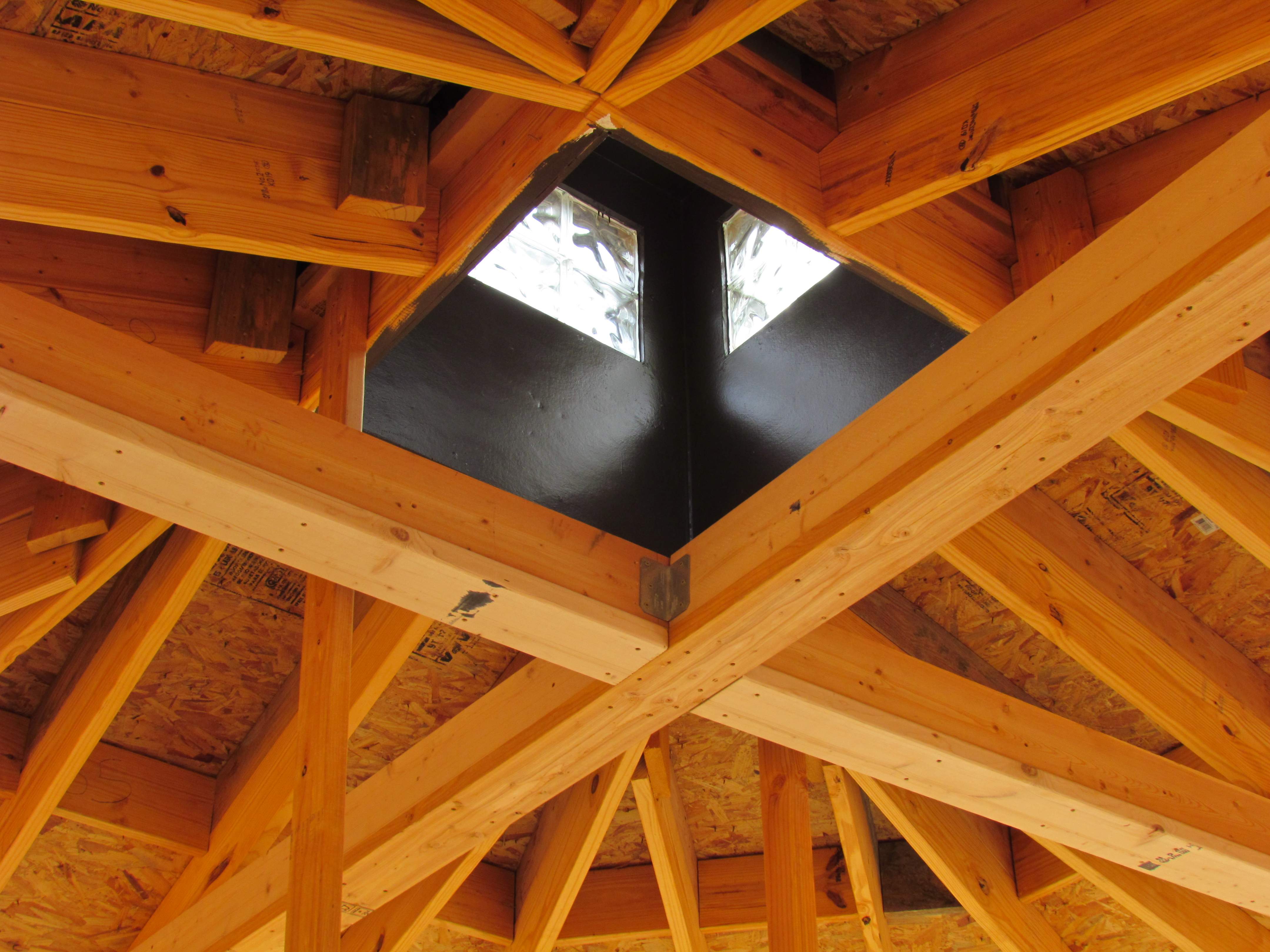

The cupula is up high enough that getting into it would be awkward with the beam installed, so I wanted to have the inside finished off before building the beam.

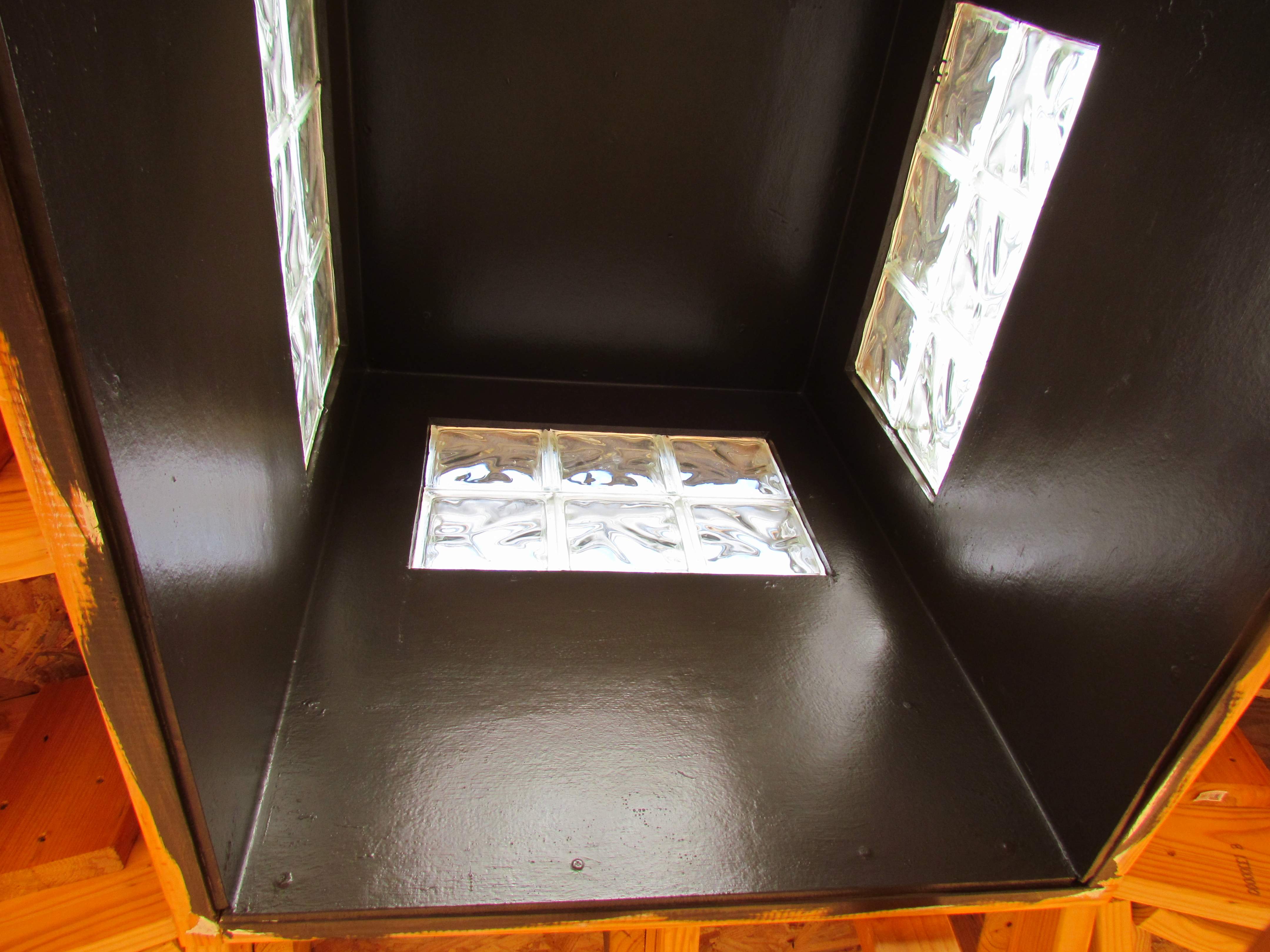

I used 1/2 inch Hardi backer board for the ceiling and walls of the cupola. It's what's used in showers for tile, and a really great product for wet areas. My concern is that since I did not vent the cupola, that it will trap moisture and create condensation. I'm fine with that, but don't want it to rot in there. I primed the Hardi with exterior Zinsser primer and then two coats of exterior latex paint.

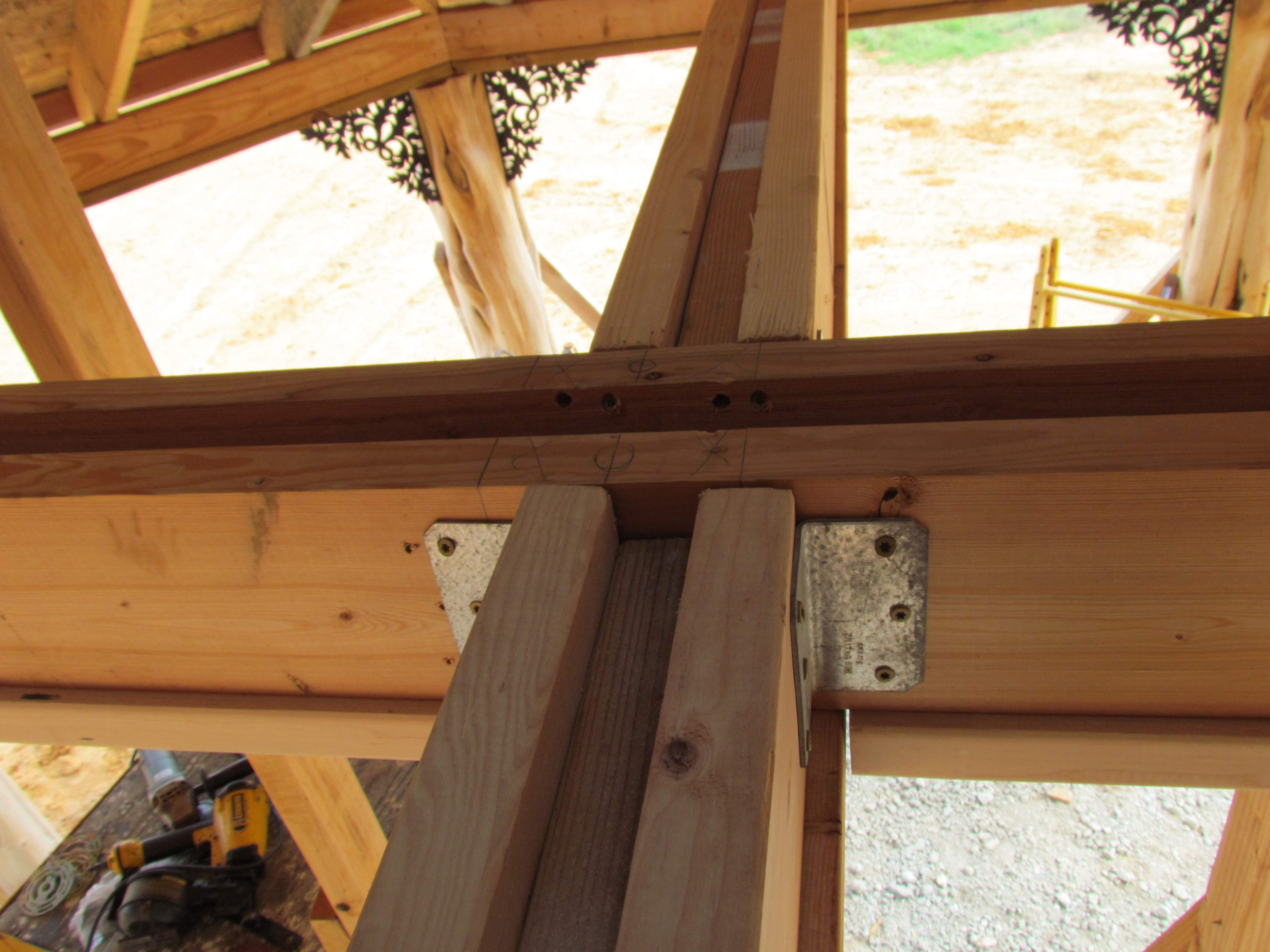

Once the cupola was done, I built the beam. It has two purposes. One is to help hold the walls in. The basic design of a gazebo does this, but adding the beam just makes it stronger. The other purpose is to have a place to mount my ceiling fan and light for the cupola.
I used two 16 ft 2x6's mounted verticaly in one direction, then a single 16 ft 2x6 mounted horizontaly in the other direction. That gives me a solid, continuous board going in both directions!!!! I know it's obvious and simple, but in the planning of this, I had issues figuring this out.
I added metal brackets and put 2x4's in between the 2x6's to make it solid and give me a place to hide my wires.
Figureing out where the center of the one beam was so I could get the other beam centered "AND" squared proved to be a bit challenging. I sometimes do things backwards and create more work for myself. I measured from the cupola instead of from the outside width of the beam at first. That didn't look right, so then I did it from the outside in and got it right. You can see some of my markings in the last picture that show my confusion at figuring it. :D

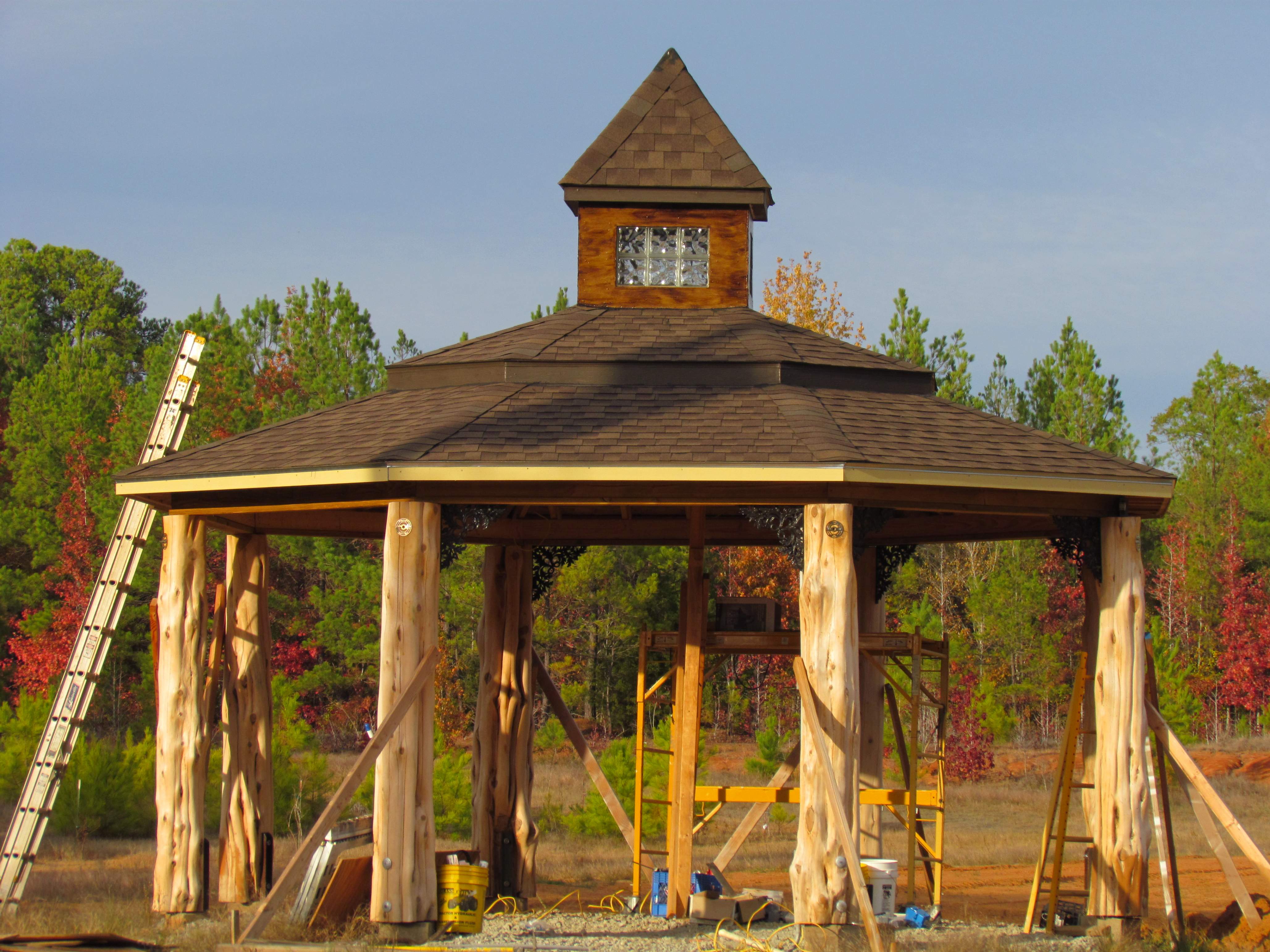

Nothing new to share except I took a picture of it while walking out to my deer blind this afternoon. I didn't realize that I haven't posted any pics of the whole thing since painting the trim and cuplola.
