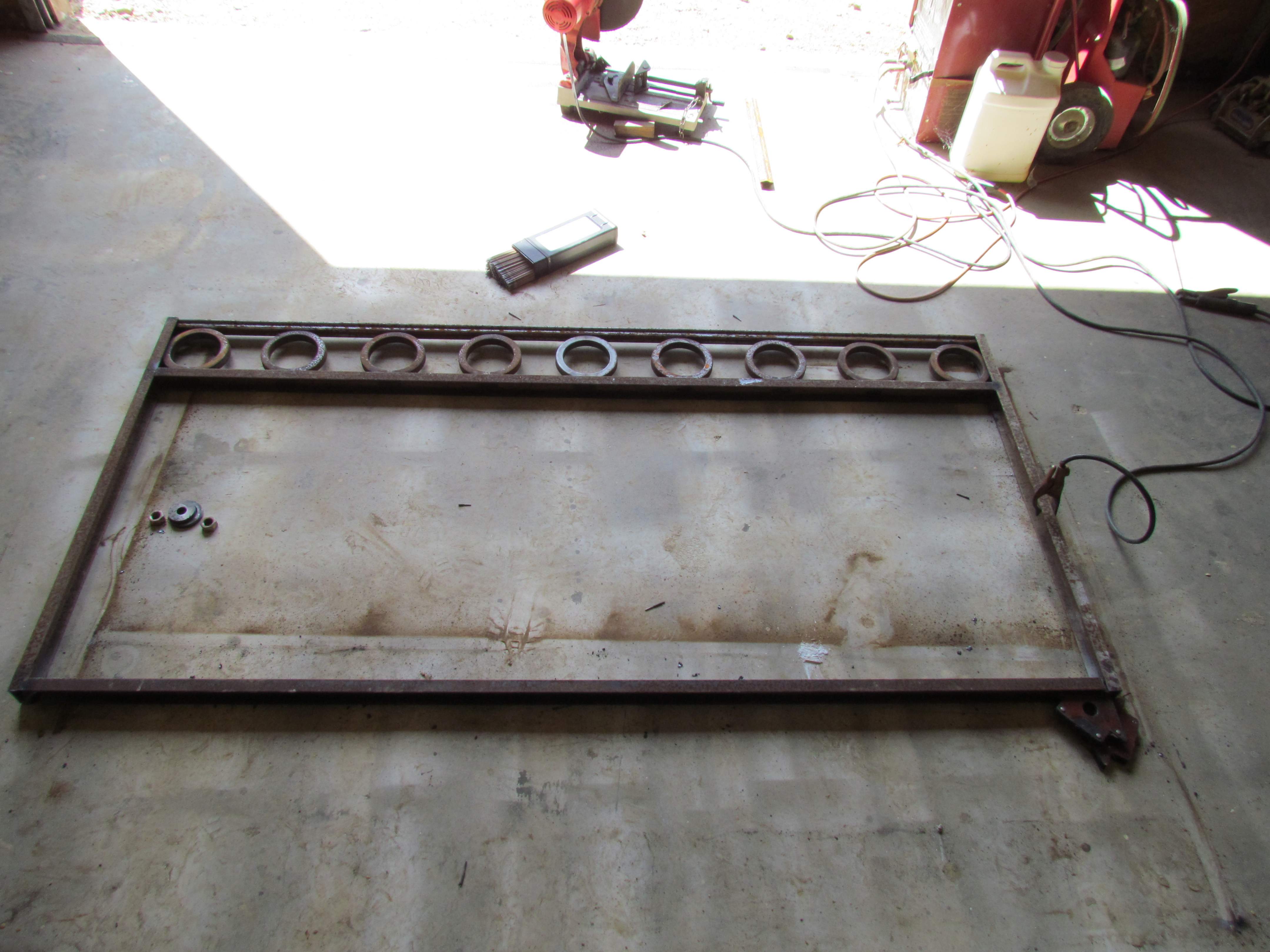

I started building the first of four sheer panels that will go between the logs to lock them into place. Each one is going to be cust built to fit between the logs that are there, which means there will be a couple inches difference because the logs are different thicknesses.
I'm using 2 inch C channel for the frame. The circles and top are from King Architectual Metals in Dallas. This is what I got done this afternoon before the heat got to me.

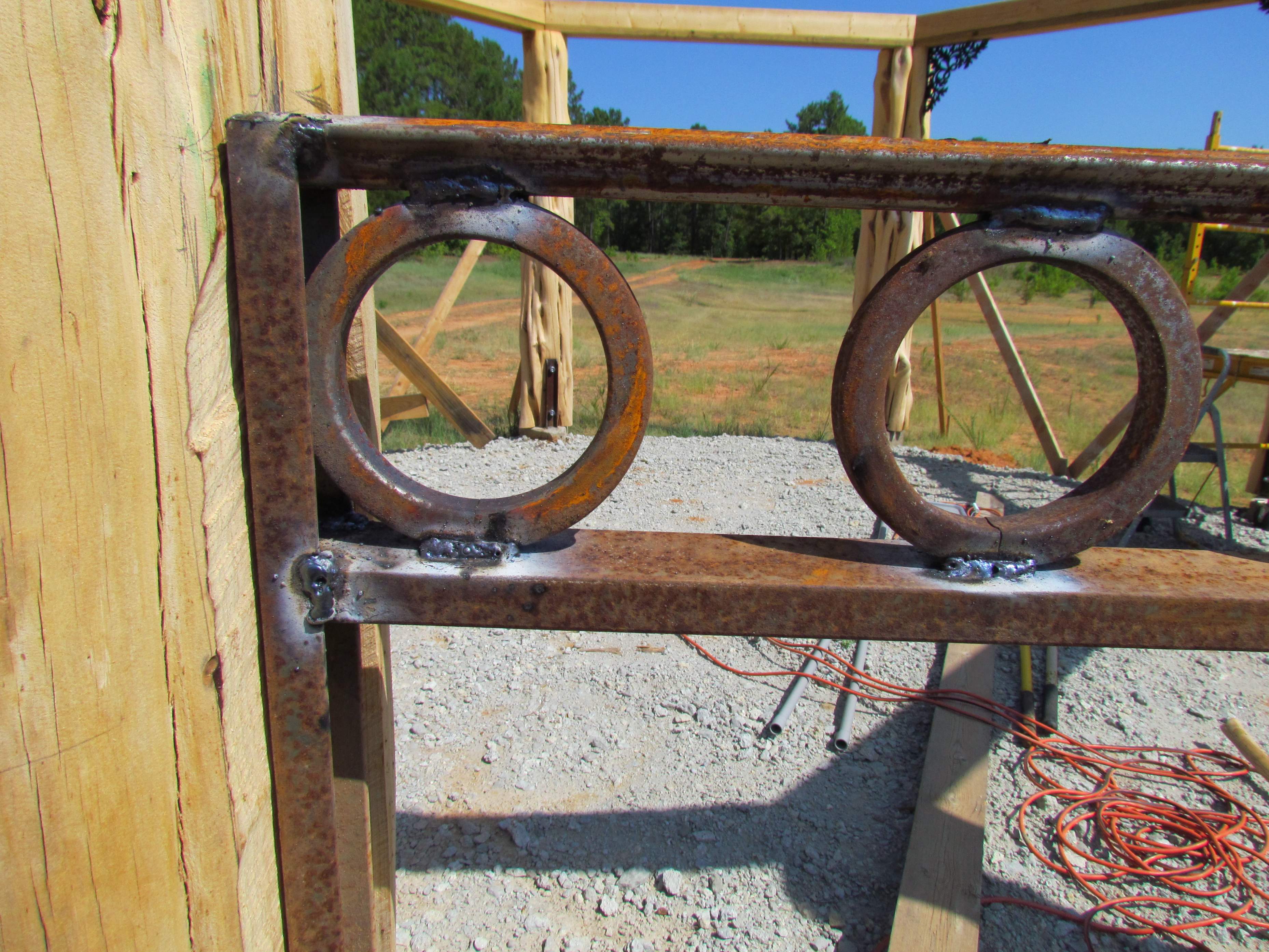

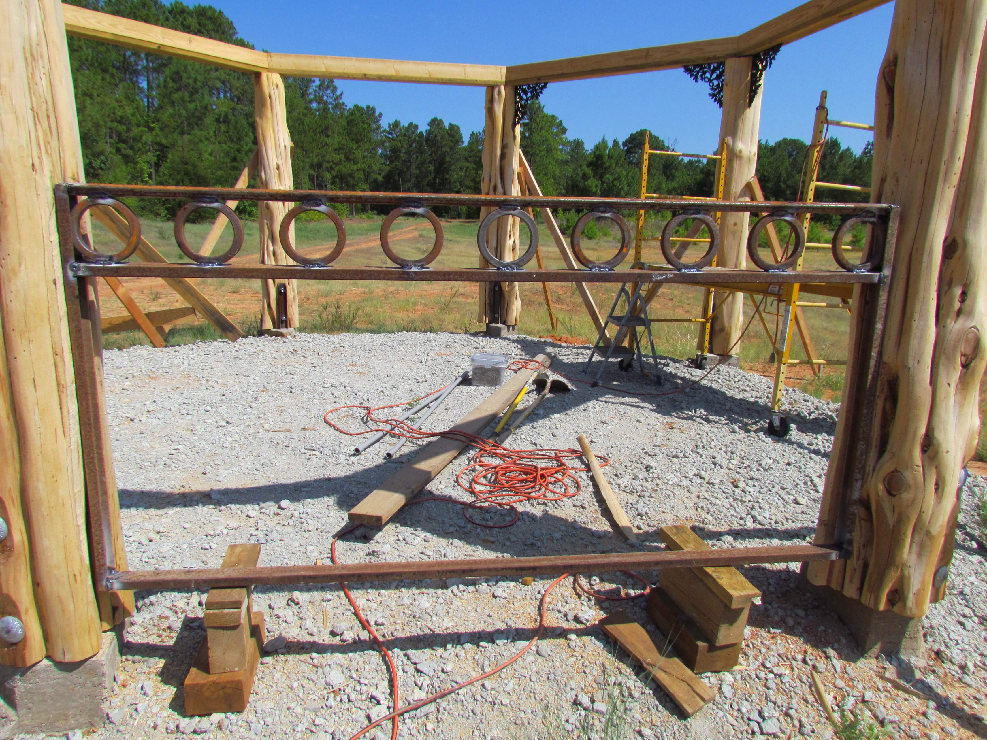

I fitted the panel into the logs and cut them with my small chainsaw. Then sanded the wood so it would look semi natural. I love cedar becasue there is no way to do it wrong!!!!!

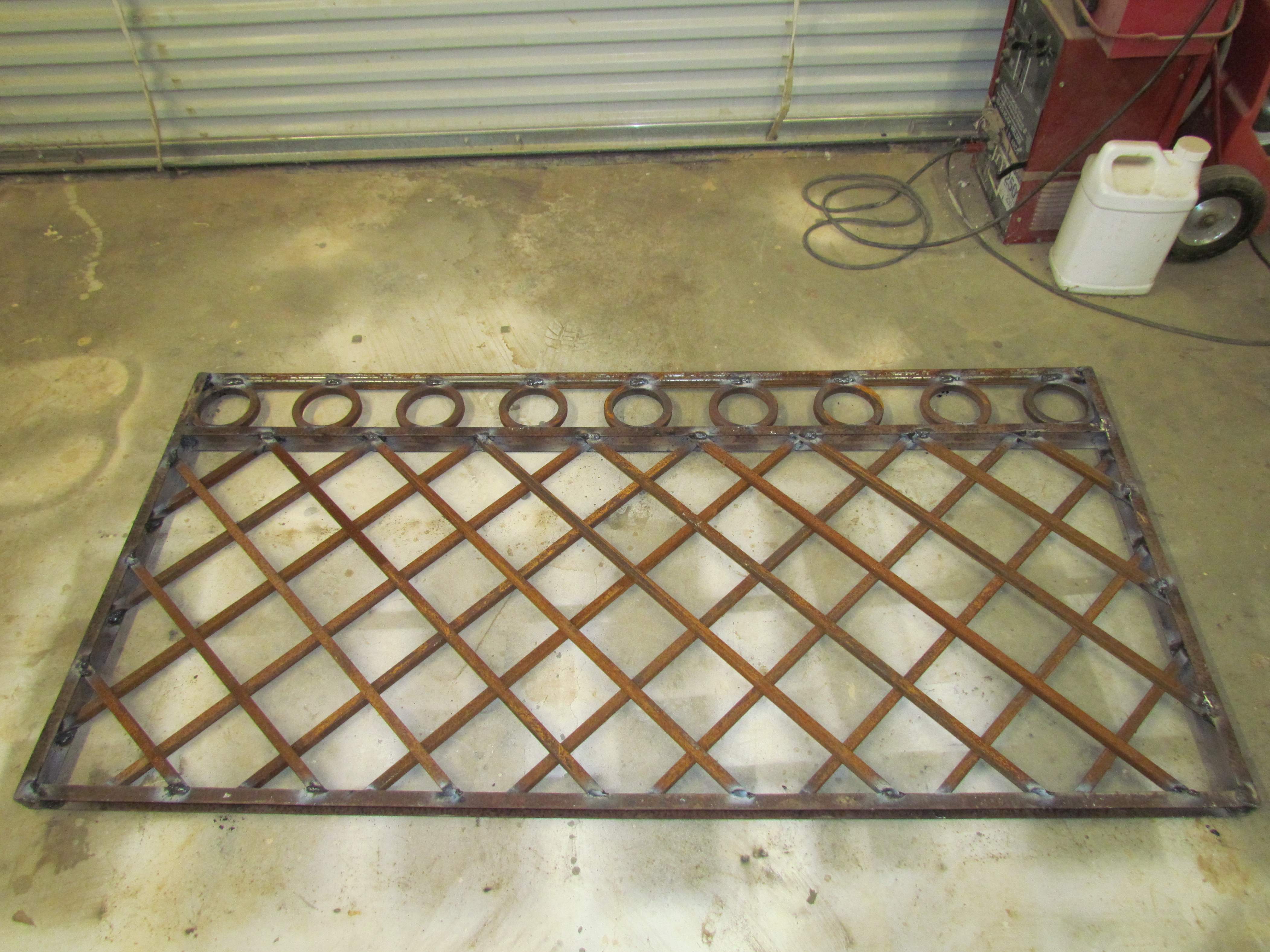

Here is the first panel all welded up. I'm sure glad that I fit it in the logs before adding the extra weight to it!!!!
My thought is to create a sheer panel that will lock the logs into position. Since they are just bolted to the tops of concrete pads, the more weight I put into the roof, the more the logs will want to rack. Four of these panels should lock the logs into position.
Anybody see anything wrong with my thinking? Any suggestions to make it stronger. This is it. Once these are in place, that's all I have to keep it standing there, and since this is a first for me to do anything quite like this, I'm wide open to your advice.

1. As you already know, the taller the shear panels, the better they work and the lower the forces on them. Without any engineering analysis at all, these look strong enough.
2. The shear panels must be attached to the uprights in such a way as to support tension loads at each corner. (I.e., the upright will try to pull away from the shear panel when the uprights try to rack.)
I didn't see dimensions on the side rails of the shear panels, but a great big lag bolt at each corner of the panel would be the minimum I would consider. A machine bolt going all the way through the upright with a nut and a large washer on the other side would be even better. I don't quite know how to accomplish that with the design I see, but either an L-bracket top and bottom at each corner, or a strip of 1/4" x 2" stock extending beyond the current height of the panels by about 1.5" would do. The strip will look better, but will require re-shaping the logs you just cut.

I'm using four, 5 inch lag bolts on each end of the panels.
The panel is 38 inches tall and it's being mounted so the top of the panel is 44 inches up from the bottom of the logs. The logs are 8 feet tall.
The C Channel is two inches wide.
I'm putting them all on one side. Four right next to each other, between the logs.
I really appeciate the feedback,
Eddie

Eddie, I wonder if you could run a bar from one panel, through the log into the other panel and sandwich them together??, Just thinking out load.
   / Gazebo Number One #90
eddie- I dont see any hurricane straps on the ledger to your cedar posts due to fact you are in texas, nor on your railings to the concrete post. The way you are building it now, it probably will stay in large pieces, but not as whole.
The metal posts appears to be fine for cross bracing of posts, but once the roof rafters are in place and sheathing on, it will lock the whole thing to be sturdy.
