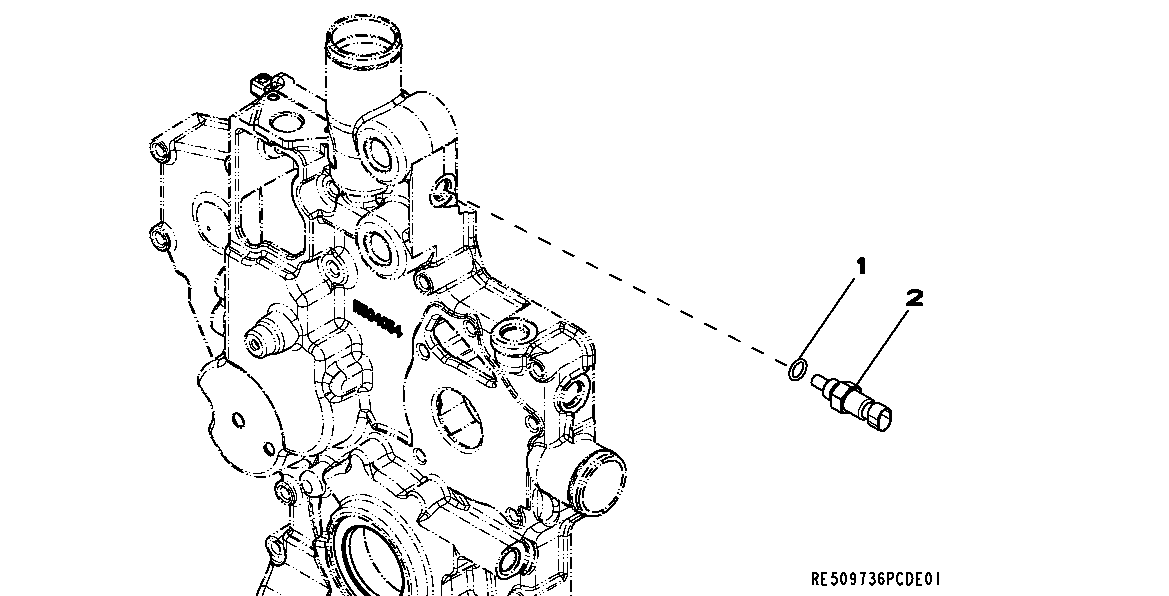

5325 DIESEL. HAVING TROUBLE WITH HEAT SENSOR. WHEN ENGINE IS COLD, SHOULD SENSOR BE A CONDUCTOR OR NON CONDUCTOR? CAN THE CENSOR BE REMOVED WITHOUT DRAINING THE RADIATOR ?

Here's some tests you can make:
Remove wire from sensor. With key ON you should have 12v at the wire. Gauge should read COLD
If you ground the wire (from sensor) With Key ON, gauge should read HOT.
With an OHM meter sensor OHMS:
140 degrees 120-148 ohms
194 degrees 47-55 ohms
212 degrees 35-42 ohms

thanks beyond measure. Thia is exactly the info I needed.

sounds like old home week. I have not talked to Carmen in a long time and have not seen John since Bob passed away. Bob and I were real good buddies. My tractor came from Bailey's. Would you be so kind as to tell me one more thing. I may have the wrong sensor in sight. I'm looking at the one that is screwed into the bottom of the block at the front left as you sit in the tractor seat and have a gut feeling that this is not the right sensor. It ought to be up on top of the front of the engine. My "little John" is a diesel.
/ GBLINTNER #8
Your initials(GB) had me confused as I knew you as Mr. Bruce. Before Bob's(Big Daddy) passing and John Wells selling out and moving to Glen Rose I helped them with their farming and cattle. I've either drove a tractor or rode a horse over about every acre of the Lightfoot Ranch that John had leased. I forgot to mention I also knew Pete Stout. Parts key #2 is the temp sensor. I'm not very familiar with newer model tractors but you might check to be sure the dash panel is properly grounded.
