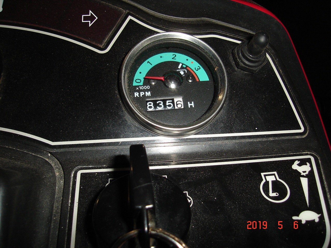

Depends on the model of the tractor, I suppose. Here's what my tach looks like -- a lot different (SMALLER & harder to read!) than current models. The white mark is engine speed to produce rated PTO speed and, I presume, rated HP.
Mine is marked at around 2300 RPM engine speed, but I do run it a bit less unless conditions warrant "full" PTO speed. Most of the time 2K is fast enough for both mowing and blowing; a tiller is a different story.
