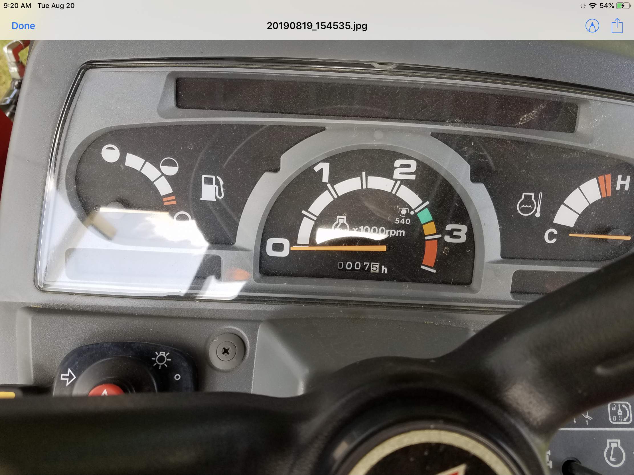

I致e been running around 2,000 to 2,500, figuring the MM PTO is labeled 2,000 RPM on the lever.
In order to achieve 2000 RPM at the mid PTO and 540 RPM at the rear PTO the engine speed must be run at 2600 RPM with a gc1705 or 3000 RPM with the 25 horsepower models. Spinning the engine slower than that will reduce horsepower to the implement as well as rotational speed and could damage the machine.

Took the chute off on my 60” deck to put it on the trailer easier, used bungee on my Cub Cadet but anyway I mowed 5 acres for my 1st time Thursday with my new 1705 and I ran the rpms right in the middle of the green on the tack and it did just fine. It is at my other property or else I would go out and see what rpm that is, just above 2000 I think.
How do you figure it would damage the machine?

On the tach gauge on the 1705, you with see a green area, when running pto equipment I always set the throttle within that area..
on edit: I see we are talking about a 1715, I don't know what the tach is like on it..

Ok so when mowing I have my throttle set in the middle of the green and when using the FEL or blade I run at the top of green.
