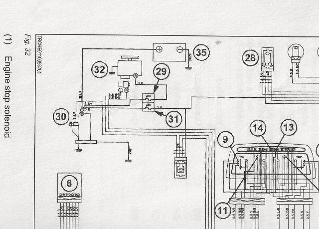

I am trying to find out if anyone knows where the 60 amp in line I think alternator fuse is actually located on a 2018 Massey GC1705. I have torn wires apart near and below coming off the alternator for over 18" and found nothing. I have a new alternator that checked out at shop to be working correctly but am getting nothing to battery. The 40 amp in the box by main fuse box is not the one I am looking for.
   / GC 1705 60 amp alternator fuse location. #2
There is no 60 amp fuse......Only the 40 amp fuse #11 on the GC 1705/10/15/20 series tractor...
Part number 29 in diagram.... IF you don't have 12Volts at "B" terminal of alternator you have open circuit on path, through fuse back to 12 Volt terminal on starter solenoid....

Got it fixed thanks it was the 40 amp fuse that looked good but texted bad
