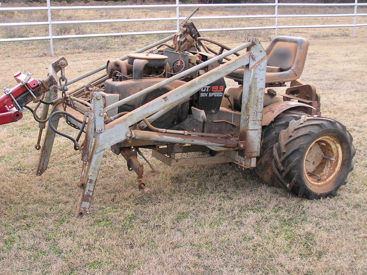

I'm curious, since I don't know how an auto leveler works. How can you tell by the pics? Are those "extra" pistons on top of the loader arms? Is that how it works?
   / GC 1705 Self Leveling loader?
Yup, it's the extra parts that you see that make it self-leveling. In fact there are no extra cylinders, only 2 links and 3 pivots extra per side
It's a parallel linkage anchored on the main vertical of the loader using the triangle bracket at the front upper corner to transfer that parallel around the corner down the front of the boom to the base end of the bucket cyl. You have full range of bucket curl at any point but the linkage will keep the bucket steady as you lift the boom rather than having to manually adjust the curl to keep from spilling out the back of the bucket.

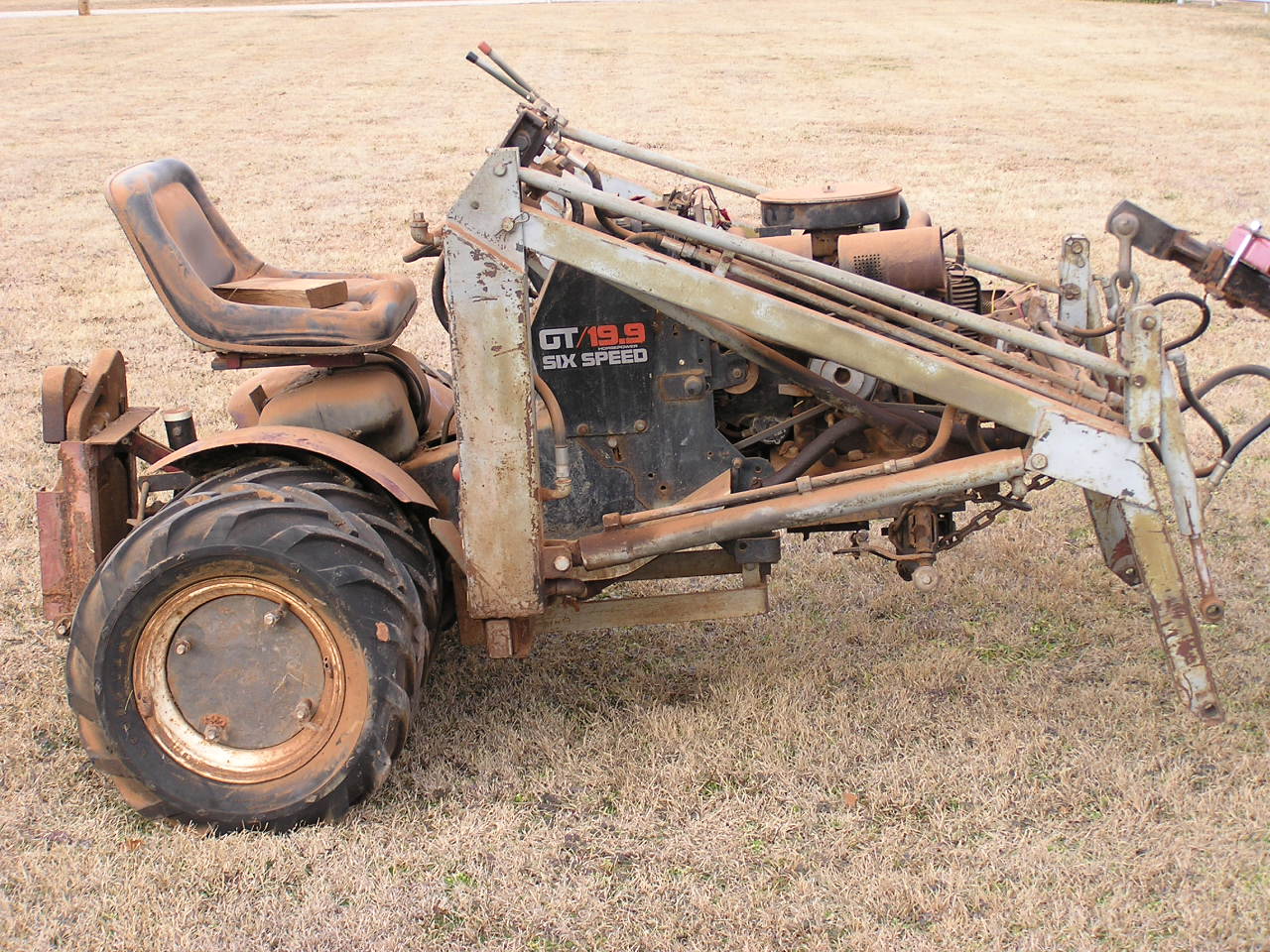

Here is Kwik-Way brand on a garden tractor that I used to own. You can see the leveling linkage.
