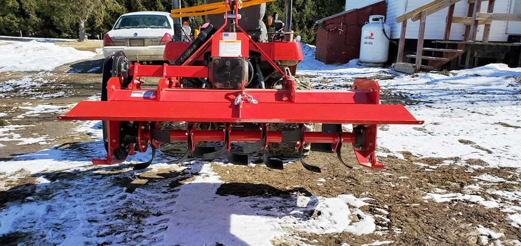

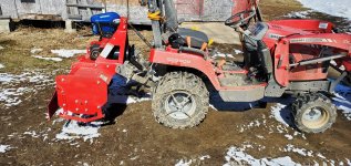

regarding the lower link spread.
fwiw my 2010 GC2400 spreads past 26" and takes class 1 (26") woods tillers.
