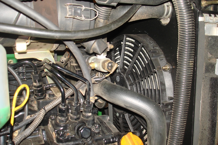

I replaced the belt driven fan with a Spal electeric fan and PWM controller so I can adjust when the fan comes on. I have it come on at 165 in the summer and 185 in the winter and I still get coolant flow through the cylinder head at 160. The PWM makes it variable speed giving it better control... This is an old pic I started with an 11 inch fan but have since changed to a 14.

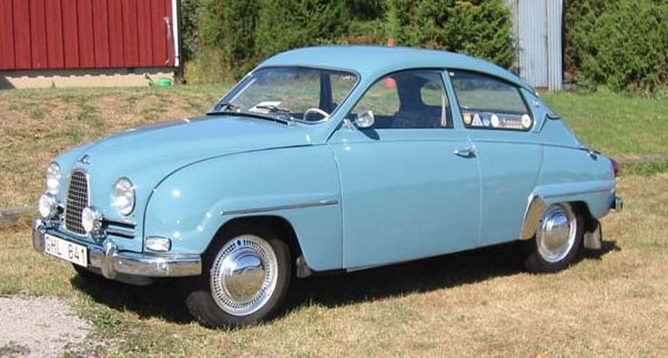

The SAABs I was referring to were of the same vintage; I had the good fortune to drive a couple, both '65 models, their model number 96, I believe. Very simple, economical, spacious cars that cornered like they were on rails and outdrove evrything but 4-wheel drives (and even some of them!) in the snow. They even had windshield washers when US manufacturuers were just beginning to think about them. Granted, they were 2-strokes....
Kinda homely, but they had a tendency to grow on ya!
