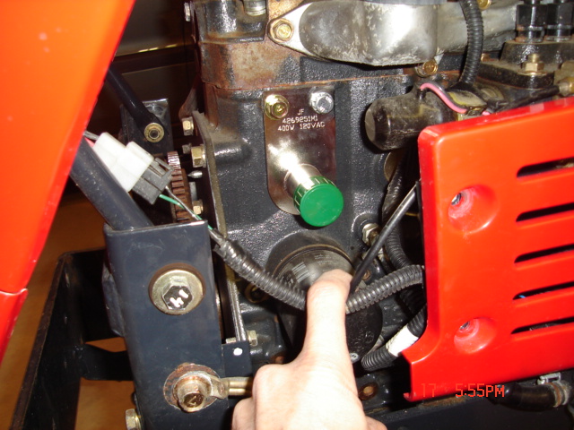

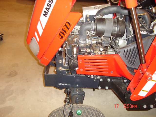

Just bought one from Northwood Power-- It was a bit pricey at $140+, but man, the thing fits perfectly! It seems very well put together, its mounting plate made out of 3/16" solid steel of some kind, and the installation was a breeze.

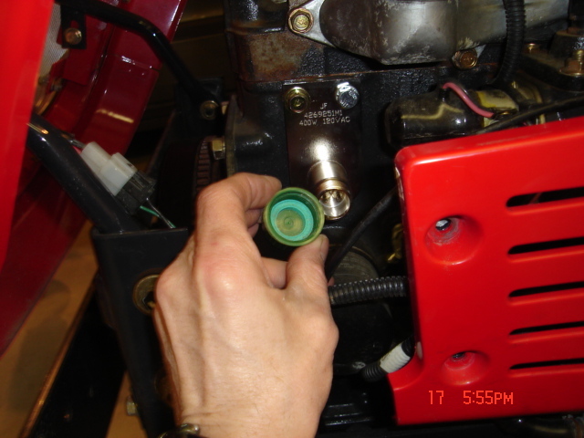

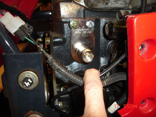

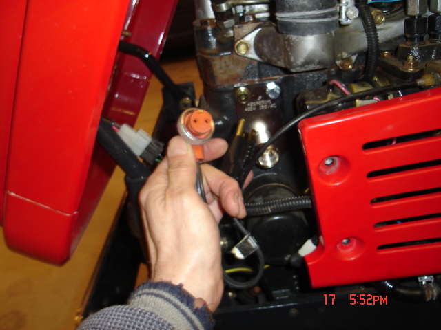

Just poke out the upper freeze plug on the front left side of the engine (just above oil filter), put some silicone grease on the o-ring fitting, and it pops right in. Threaded holes in the block are already there.
Attached with two bolts (though only one came with the kit-:confused:), it also has a detachable 120VAC plug that's held in with a threaded collar so it can be removed when not needed. I also found that a standard garden hose cap fits the thread to cover the socket when the AC cord's not attached.
My hope is that I'll be able to reduce warm-up time (consuming $$diesel fuel). It ain't huge at only 400 watts, but it ought to do the job....

Also found that M-F apparently used to have a ground strap on the block that used one of the bolt holes where the block htr mounts, according to paperwork with the kit- guess that's why the kit only came with one bolt. No such ground strap on my 2310, however.... dealer was kind enough to give me a second bolt-- Thanks, Rick!

Even though this block heater is only 400W, the engine in the 2300/2310 is only 1.1 L IIRC. And, even though it's cast iron, that little block heater works very well. My 2300 is very cold blooded. At 30F w/o the block heater on, I need about 30-40 seconds of glow plug for it to light off. At that temp, with the block heater on for 2-3 hrs, I'm not sure I'd need much more than 10 seconds, if that.
I switched over to synthetics in both the engine and hydro and typically only warm it up for 5-10 minutes before using in the winter but I engage the snowblower at low rpm and raise the throttle modestly fast to full rpm and take it easy (slow) for the first 5 minutes of blowing. That seems to heat things up fairly quickly and I have not had a problem blowing a filter or a line.
I leave the cord on and just put a baggie over it (with some tape) and stick it inside the frame for the summer. It isn't in the way of anything there.
Enjoy your new block heater.
