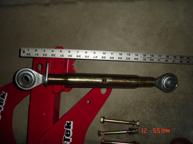

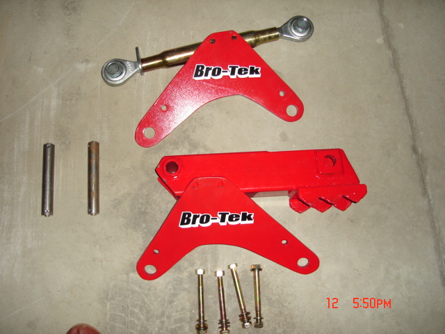

I'm really looking forward to using the thumb-- seems it's the one "most valuable" add-on for SCUTs. Got a lot of dead trees around my property, hoping to turn them into firewood.:D
Here's a coupla shots of the parts-- it's almost impossible to get a pic of the 2310's top link with the BH on, and I'm not takin' it off just now-- but I believe the pin diameter on the 2310's 3PH are 3/4"; you can see the relative size of the top link Richard @ Bro-Tek sent with the thumb.
The whole thing seems very well constructed, and the top link in particular very rugged. Even came painted red!

You're right - the 2310 pin diameter is 3/4", and it's the same on my Bro-Tek thumb. I just take the top link off when I attach the BH and it rests nicely on the platforms where my feet rest when I'm using it.
