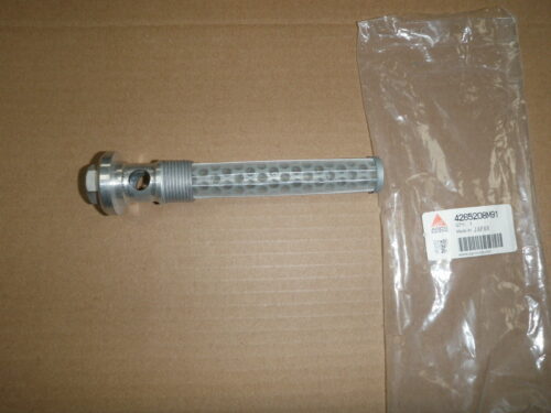

Anyone know what the thread size and type is on the side filter for the GC transmission? I cross threaded and need to run a chase through.

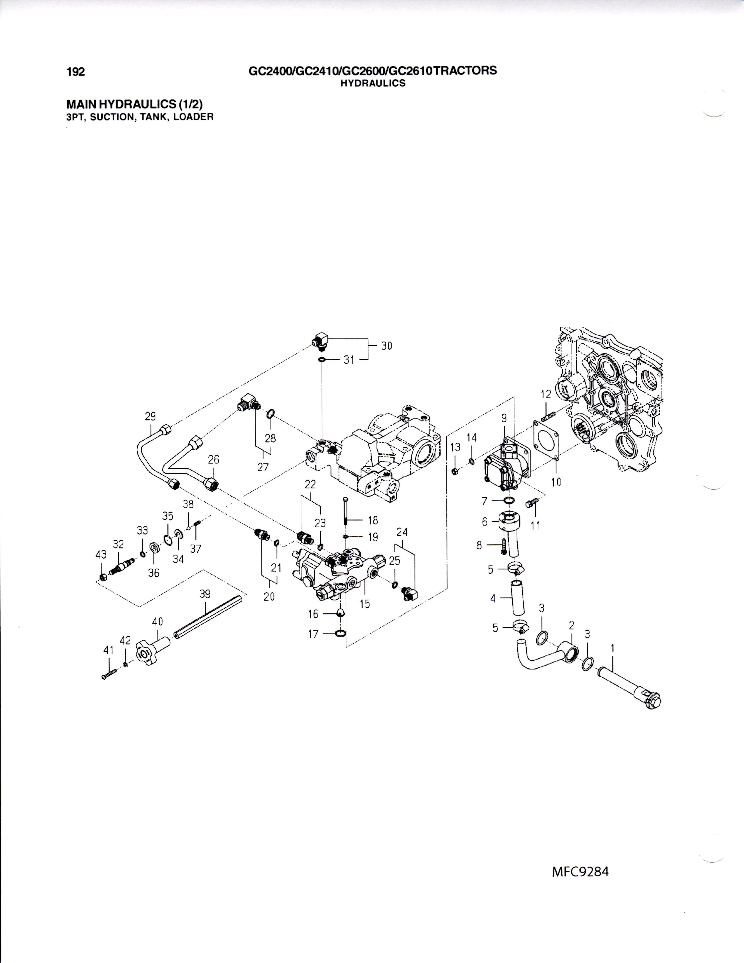

Sorry, searched my MF Service Manual, and my MF Parts Catalog, and the online MF Parts lookup website, and I could not find the information you are looking for.
I would try calling your MF Dealer Parts/Service and maybe they would be able to provide you with the type of threads for the Hydraulic Suction Filter.
Maybe at the last resort, Jack's Small Engine has the "Suction Pipe" part # 4265209(91 for $84, ouch...
Massey Ferguson 426529M91 PIPE - Jacks Small Engines

I had to get a new suction filter as I messed up the mesh taking it out, or it was like that from the factory, and it's a fairly good sized hole. I want to say it's going to be around M16-M20 x 1.5.
