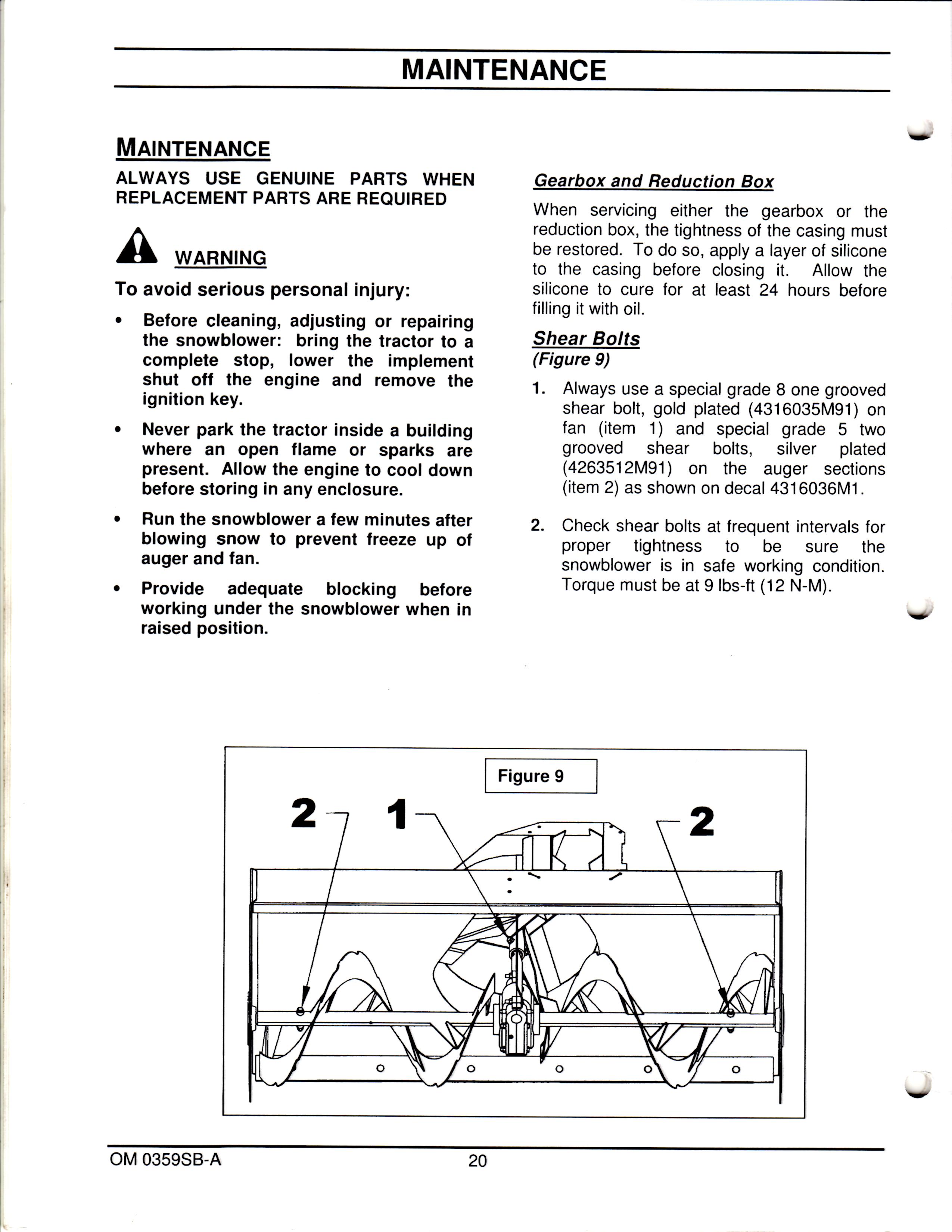

I changed the oil on my 54 inch mid mount mower and my 2360 front mount snowblower and I used the permatran 821 xl to refill. Is this ok?
Thanks.
Danny.
   / GC 2600 #62
Hi Danny,
I cannot help you with any fluid information about your 54" mid mower because I only have a brush hog for my mowing.
The MF 2360 Snowblower takes AGMA 5EP extreme pressure oil, SAE 80W90 gear oil or equivalent, which you will find at the bottom of page 21, at the bottom of this post.
The MF Permatran 821XL is for the transmission/hydraulic system of your tractor.
KC
Below is Page 20 & page 21, "Maintenance" for the MF 2360 Snowblower manual I have from 2009:

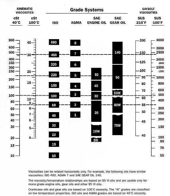

Actually, the hydraulic transmission fluid and the 80W-90 gear lube, are about the same viscosity.
The transmission fluid, and the gear oil are measured on two different scales. So, people tend to mistakenly believe the gear lube is thicker.
Viscosities vary widely by brand, but both are about 30W on the motor oil scale.
Both products are in fact, light weight gear oil. The big difference between them is the additives.
The transmission oil doesn't just have to protect the transmission gears, it also has to operate the hydraulics, and the brakes. So, it has additives for all those to work better too.
The hydraulic transmission oil is designed to work in gear boxes like the front differential, or a gear box. But, those hypoid gears are best protected by EP, (extreme pressure), rated gear lube, that's what it was specifically designed for.
Look for that EP designation when you chose your product. Not all gear oil is rated that high.
