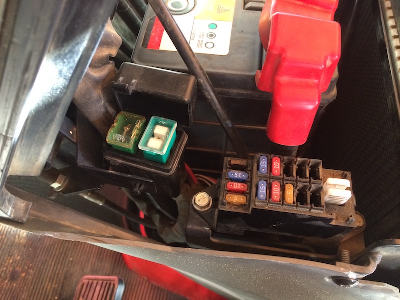

On my 1715 one is between alternator output and stud on starter and other fuse is from stud on starter to rest of tractors electrical system.... Stud on starter is also connection point for positive battery cable... My guess since both tractors are made by ISEKI and similar in size they would wire about the same.... The fuses on my 1715 are located right next to battery on right side from drivers seat....
Dale
   / GC Charging System Troubleshooting
#12
Curious though, where exactly are these fuses??
Throttle side of engine compartment, next to battery. See image below.
