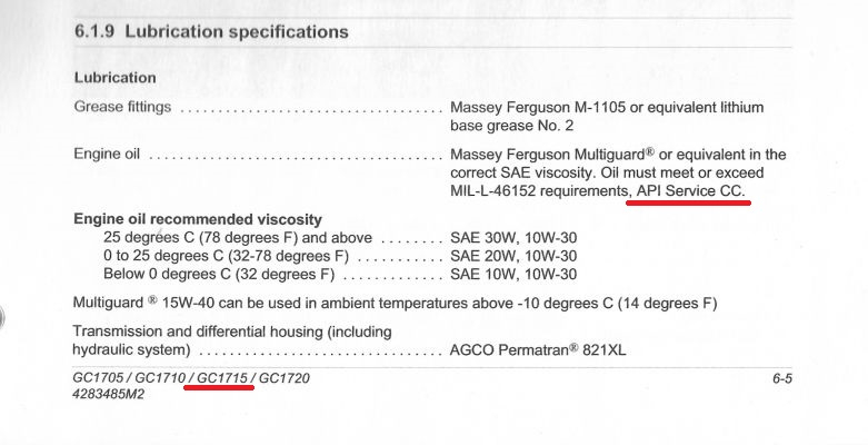

Now it's my turn to change it. I see by the manual it wants 10W-30. Easy enough.
I then note that all the 10W-30 I see on the local shelves is "stamped" FOR GASOLINE ENGINES. Should this proud stamp on the label be of any concern for using this oil in our little ISEKI diesels?

You need oil rated for diesel use. CJ, CK...rotella T5, T6, or a comparable oil. 5W40 would exceed the spec called for. Do not use gas oil.
   / GC Engine Oil Question #3
CJ-4, in my manual it is in a box at the top of the page separate from where it says 10W30. I don't have any idea what the difference between CJ-4 and CJ is or any or the others that @RustyA listed, I just follow the manual.

CJ is older spec, CK4 is latest spec, backwards compatible
   / GC Engine Oil Question #6
:) Thanks. As long as it says meets or exceeds "CJ-4" I'm good to go. Hopefully when they decide to stop printing that on the label and I forget this conversation there will be people here like you to tell me what to look for.
