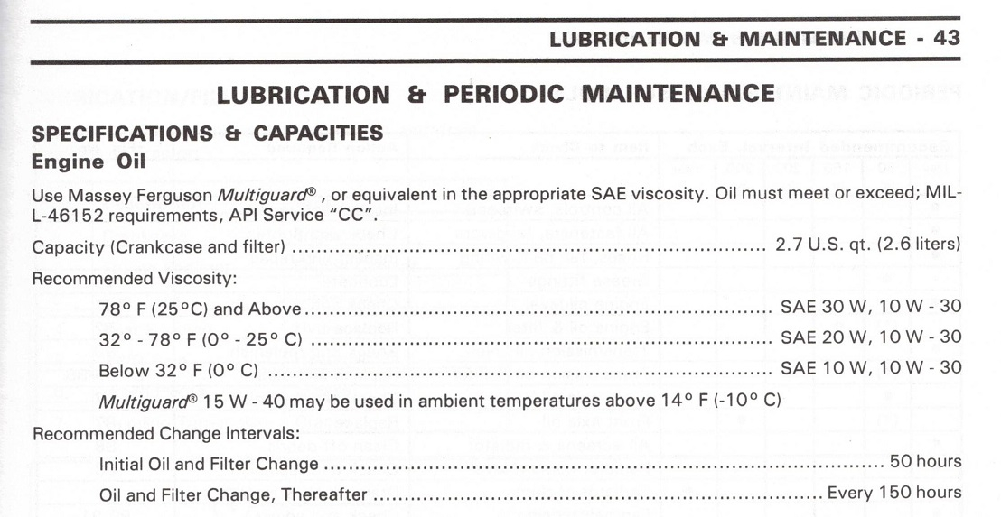

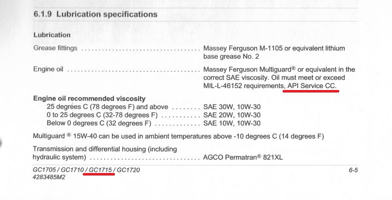

So I went to local stealer/dealer today to buy filter and engine oil because I was in a hurry and I am way overdue for first 50 hour change. Let me mention that the yard was full of tractors on average probably 30 years old, and none less than 10 years, it seems to be more of a tractor repair than dealer but they are an official MF dealer. I bought out of state near my wife's other house, the tractor goes to both properties, and when he finally called me during my search (after the 3rd message) he said he couldn't get a 1723 so I went to the 3rd closest dealer who had one in stock. Anyway, I like to support local so I plan (or did plan) to take it there for a few services due to warranty. I figured if I bought the oil and filter from him, he'd be easier to work with on service and warranty issues. I tell his counter person I have a 1723E and need filter and oil, out comes 2 gallons of Rotella 15X40. I said "2 gallons? The manual says it takes 2.8 quarts." She says "My boss says to always pull 2 gallons." I pushed back and said the manual says 2.7 quarts, that's a lot different from 2 gallons." She goes to the service area to talk with someone who I think is the boss. She returns and says "He said you should be OK with 1 gallon. He always has me charge 2 gallons" as she pulls one off the counter. So...I am thinking 1) this sounds shady to always charge 2 gallons and 2) 15W40 isn't really the best heading into cooler weather even though in SC it rarely gets below 35 for low temps and it won't be 90 degrees for several months again.
Thoughts?

Are you talking engine oil or hydraulic oil?
/ GC Engine Oil Question #29
Yeah there's some misunderstanding there between the parts girl, you, and service dept. 3qts for engine is what you need. I am in a cold climate and found rotella T6 5w20 the best so far. 15w was too thick in winter, other oils I had to keep topping off, rotella not much top off needed. I'm probably sticking with that
