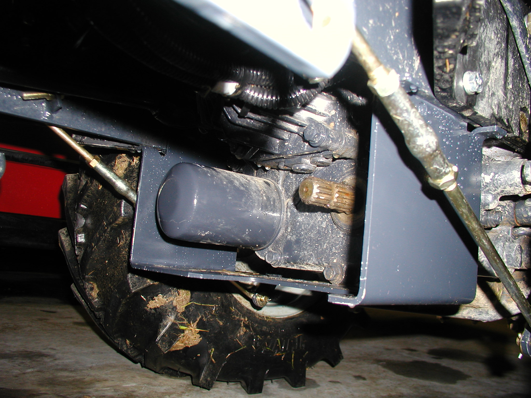

Installed the filter shield on my 2310 today. Not too bad. Had to remove the rear tires and drill a couple holes through the frame.
Paid $43.00 for the kit.

   / GC filter shield #6
I am glad it is available for purchase and self installation. But..............
It was a design failure that should be corrected at the expense of the manufacturer - same as the auto manufacturers handle recalls.
Dollar wise, I really don't care. The dealer can take care of it next time the tractor goes in for service. It is the principle that bothers me.
